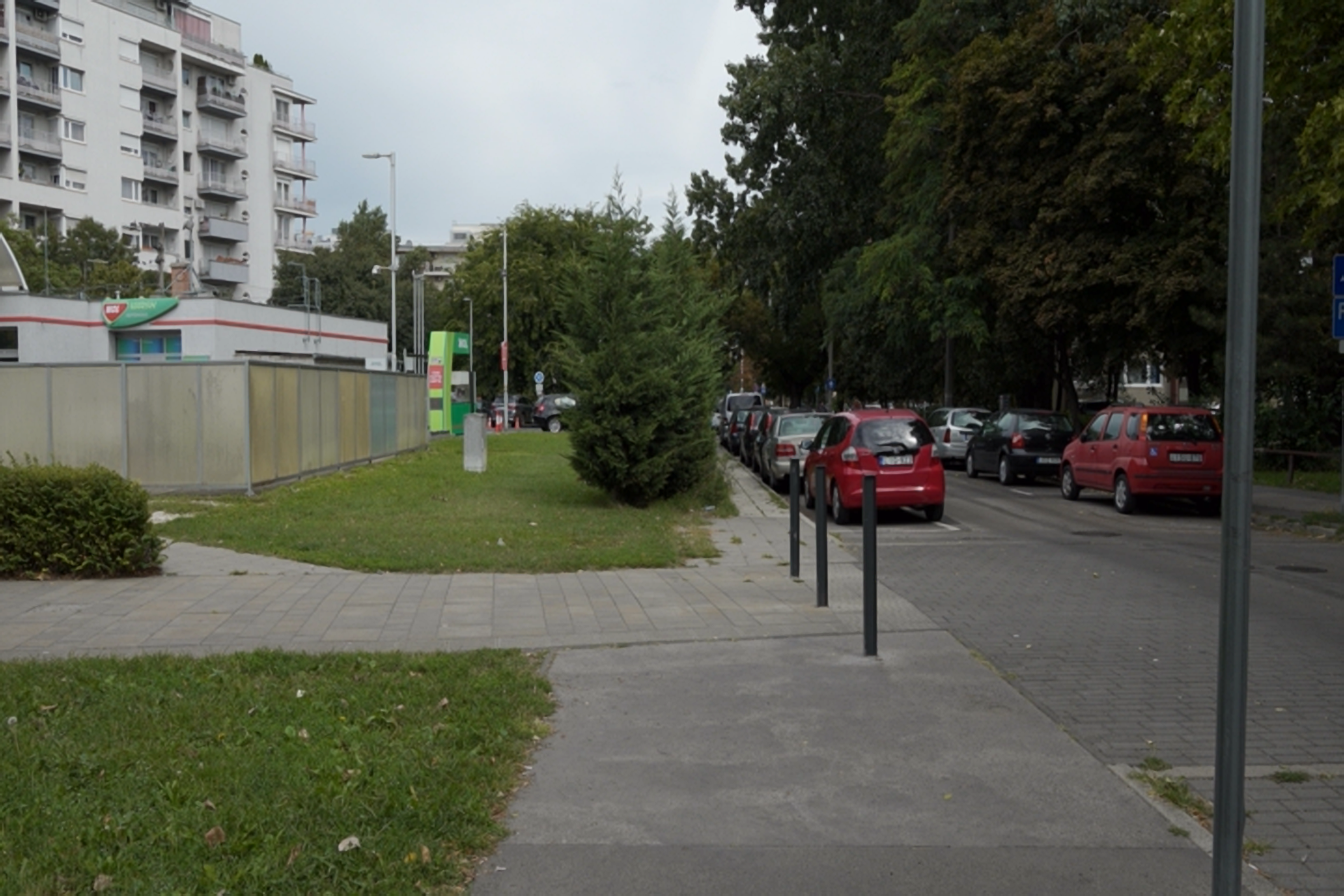

  15. Should've also posted the 4k sample, the original video I've downscaled

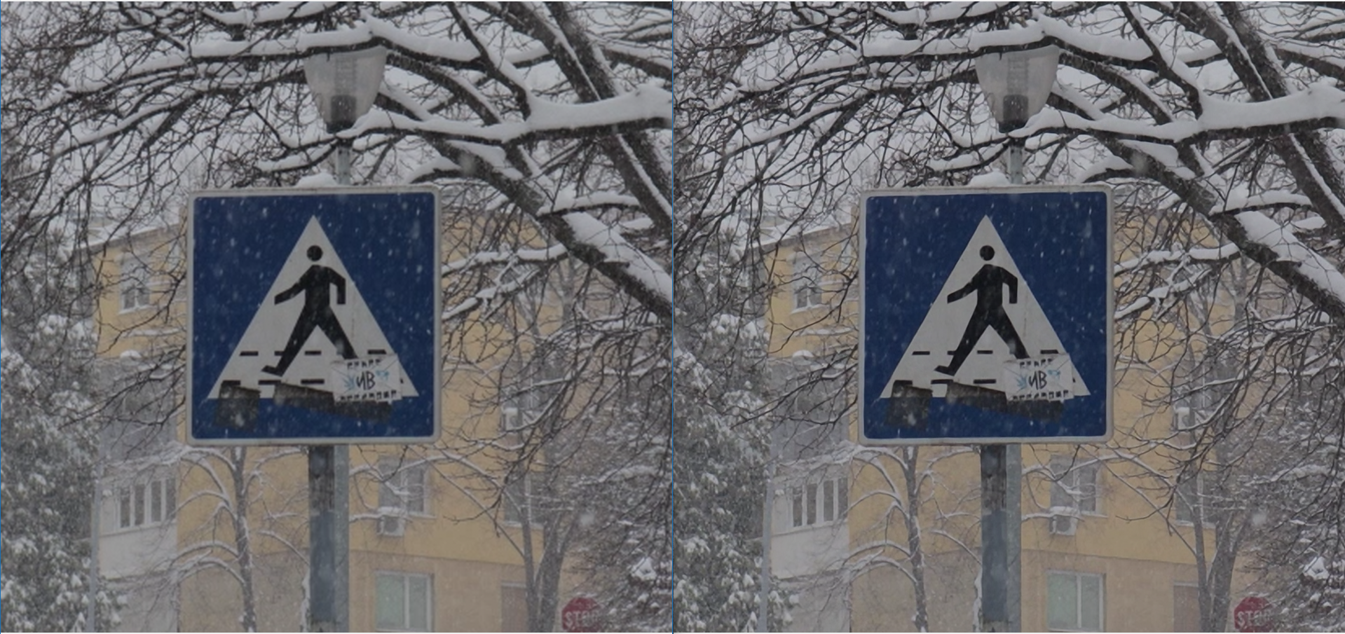

  16. Originally Posted by s-mp View Post
    my not so nicely scripted method did work pretty well with a 480p source.
    The results are exactly what I would expect and what I described above: the upscaling does reduce the jaggies on the strong diagonal lines on the street sign, and the sharpening is what is responsible for the increase in apparent clarity of the tree branches.
    However, I'm not sure I would notice any difference from the upscaling while just casually watching the video.
  17. Originally Posted by johnmeyer View Post
    And less oversharpening halos. These things are pretty obvious with anime and cartoons. Which tend to have little real detail but lots of sharp edges and lines.

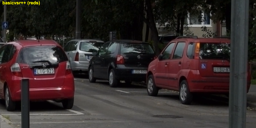

    A) 16:9 720x480 test source as lagarith RGB (originally derived from UHD , bicubic downsample).
    B) 4x (non par corrected) upscale to 2880x1920 using basicvsr++ (reds model) as FFV1, (RGB or actually bgr0)
    C and D) MP4 demo/stack previews are a central crop to a 1280x360 section (top/bottom stacked to 1280x720). Non PAR corrected. It's slowed down about 3x for the demo. The temporal aliasing (shimmering) , and fuzzy lines are what stand out for older upscalers. NNEDI3 is improved in single images in terms of the aliasing over lanczos3, but temporal shimmering is still there - NNEDI3 is spatial only. You could add temporal smoothing such as QTGMC in progressive mode, but that will reduce the effective resolution even more
    (NNEDI3 is a first generation "AI" scaler, people tend to forget that. The "NN" stands for neural network.)
    src frame @ 720x480
    [Attachment 66596 - Click to enlarge]
    non PAR corrected screenshots @ 2880x1920
    basicvsr++(reds)
    [Attachment 66597 - Click to enlarge]
    lanczos3
    [Attachment 66598 - Click to enlarge]
    nnedi3_rpow2(4, fwidth=2880, fheight=1920, cshift="spline36resize")
    [Attachment 66599 - Click to enlarge]
    cropped apng comparison (crop of 2880x1920, this should animate in browsers like chrome, firefox)
    "Higher resolution" usually means :
    1) presence of fine details such as grass blades, fine textures on the stone, etc... instead of "fuzzy" coarse lines. If you had to boil it down to a single distinguishing factor, it's fine details, high frequency. Machine learning algorithms can synthesize "false details" . It can range from looking terrible, to very good.
    2) no temporal aliasing - although other factors can cause aliasing, upscaling is a common cause. Deinterlacing is a form of "upscaling" in the sense that you are interpolating the missing scan lines
    This reds basicvsr++ model only deals with very clean sources - it was trained on a clean downscale, with no compensation for noise or typical crap sources issues . It has limited real world value because you rarely come across pristine SD sources. More models are required that emulate noise, compression artifacts - but training takes a long , long time and abundant hardware resources
    Many "AI" models "guess" wrongly and you get ugly artifacts. A big killer of many "AI" frameworks and models is text/numbers. They really mess it up. basicvsr++ is one of the few that is pretty consistent with text
    I didn't upload everything like nnedi3 or lanczos3 2880x1920 upscales - they are pretty easy to do yourself - if anyone wants any other versions or assets uploaded let me know

  21. Originally Posted by lordsmurf View Post
    How long did reds basicvsr++ take?
    Very very slow. It makes QTGMC placebo look instantaneous. It's not the model that is slow - The entire basicvsr++ architecture for 4x is very slow, regardless of which model is used.
    Memory is a big issue. The larger the window size (radius), the slower, the more memory required. It has "tiling" with overlap to reduce memory, but it reduces the quality (deterioration not really visible if you use enough overlap)
    @poisondeathray: What settings did you use for basicvsr++ with REDS?
    -> did you perhaps use ' Vimeo-90K (BI)' ?
    Definitely REDS. radius=14, tile_x=144, tile_y=96, tile_pad=10, model=0
    This was last year with an older version but it shouldn't make a difference
