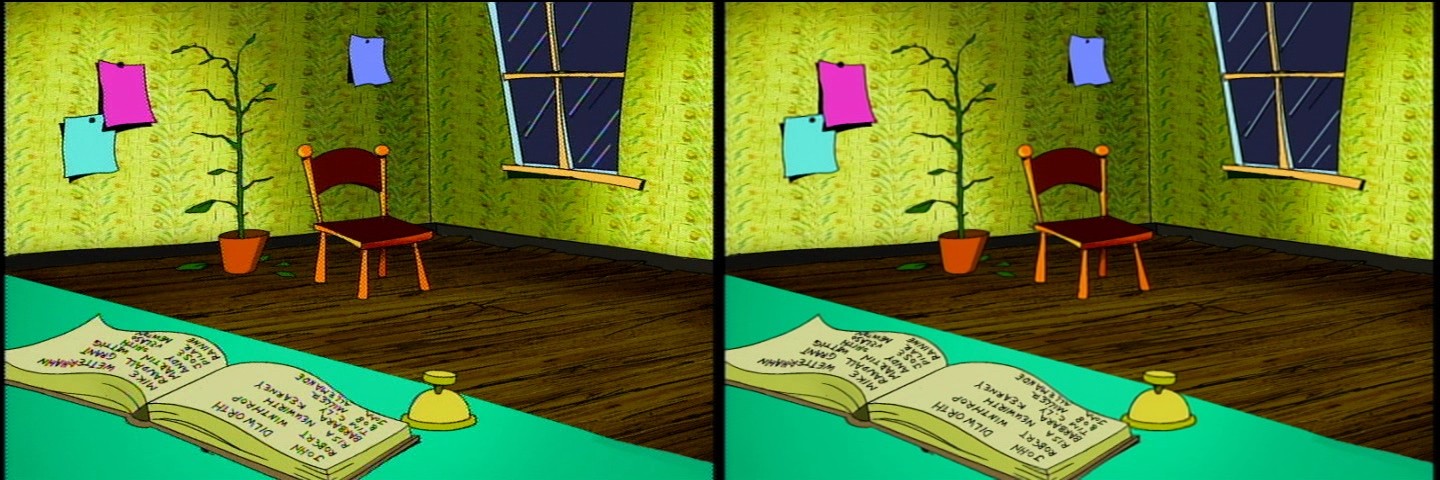

	Here's what I did in that sample:
 mmask is a map of motion. This includes the moving/flickering dots and other motions (characters, panning etc.).Code:Mpeg2Source("Various Problems.d2v", CPU2="ooooxx", Info=3) TFM() TDecimate() src = last mmask = Sharpen(1.0).mt_motion(thy1=25, thy2=25, thT=20, chroma="-128").mt_expand().mt_inpand().Blur(1.0).Blur(1.0).Blur(1.0) blurry = Spline36Resize(width/2, height/2).Spline36Resize(width, height).aWarpSharp2(depth=10) Overlay(last, blurry, mask=mmask) MergeChroma(last, src) SMDegrain (tr=2, thSAD=500, refinemotion=true, contrasharp=false, PreFilter=4, mode=0, truemotion=true, plane=4, chroma=false)
 blurry is a blurred version of the image. Blurring removes most of the dot crawl but leaves the image blurry.
 The blurry image is overlaid onto the original only where there is motion. The biggest problem here is that the moving characters are being blurred as well as the dot crawl. It needs an additional mask to limit the blurring to only the dot crawl areas.
 SMDegrain was used to reduce any residual mild dot crawl and some sparkles created by the processing. It also reduces the rainbow artifacts around the black text in the guest book.
 before:after
	This might be a little better:
 Code:Mpeg2Source("Various Problems.d2v") TFM() TDecimate() src = last dotmask = Sharpen(1.0).mt_edge(mode="0 -8 0 -8 32 -8 0 -8 0") motionmask = Sharpen(1.0).mt_motion(thy1=20, thy2=20, thT=20) combinedmask = Overlay(dotmask, motionmask, mode="multiply").mt_expand().mt_inpand().BinomialBlur(2) blurry = Spline36Resize(width/2, height/2).Spline36Resize(width, height).aWarpSharp2(depth=10) Overlay(last, blurry, mask=combinedmask) MergeChroma(last, src.aWarpSharp2(depth=15)) SMDegrain (tr=2, thSAD=200, refinemotion=true, contrasharp=false, PreFilter=4, mode=0, truemotion=true, plane=4, chroma=false)
