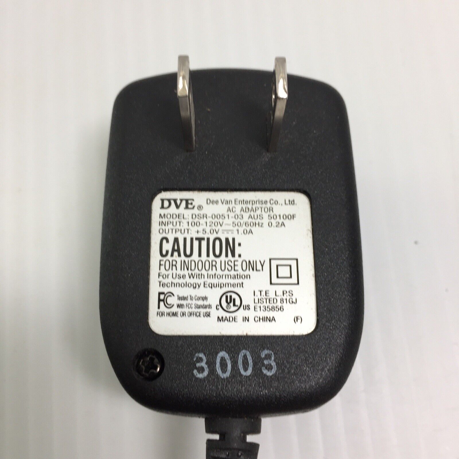

    Long story short - I picked one of these up a while back with the intention of backing up my old vhs tapes. And being the genius that I am, I tossed all of the cables that came with it after thinking I had set them aside.
    Currently, I'm running a desktop with Windows 10 64bit, a Avermedia CE310B capture card, and wanted to put the A/V Link to use. Does anyone have any recommendations for a power cord that will work for this? All I could find online was its 5vdc, and looking at prior units sold on ebay, it came with a DVE 3103 unit (which doesn't help a lot lol).

    Just find out the polarity and the working amperage, Any power adapter with the right barrel size and hole that meets those requirements should work fine, This seems like a good candidate but don't take my word for it:

    DVE DSR-0051-03
    "WARNING !!!!!" be very careful to "READ" the actual label of the adapter, the DVE DSR-0051-07 is a common mistake and its a different Voltage.
    The 3003 is (I think) a style code for the arrangement of the Prongs and shape of the case, there are other ones, but this one specifically has a "Fuse" inside which is why it has a screw in the case.. though I have never tried to repair one.
    This is a "low noise" adapter.. and small to reduce RF .. other generic adapters.. will introduce interference in the picture.

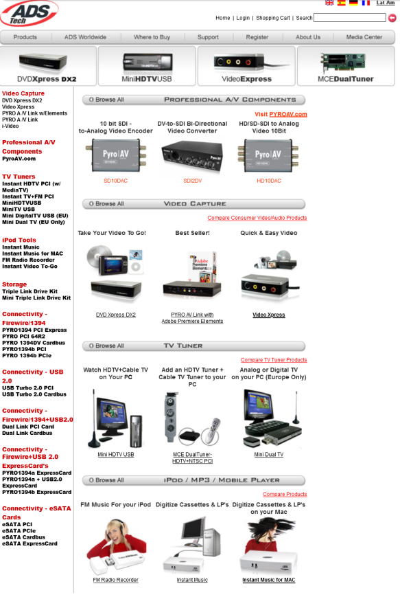

    https://web.archive.org/web/20080730055623/http://www.adstech.com/products/intro/products.asp
    The IEEE1394/firewire Pyros were succeeded by the SDI Pyros, but they like Blackmagic only offered "one" Analog to Digitial to SDI converter. They were clearly trying to capitalized on the move to SDI and the broadcast market. They "spun off" a whole new website and apparently a company and those page links left the old ADS Tech site quickly.
