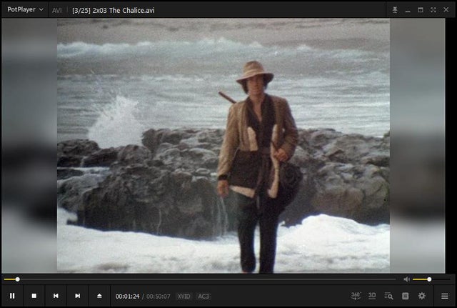

  3. I know VLC plays dvd's and everything but the reason i want to use AviSynth is so you can add borders to 4:3 screens to prevent black bars on the sides.
    Like this:
    [Attachment 66447 - Click to enlarge]
