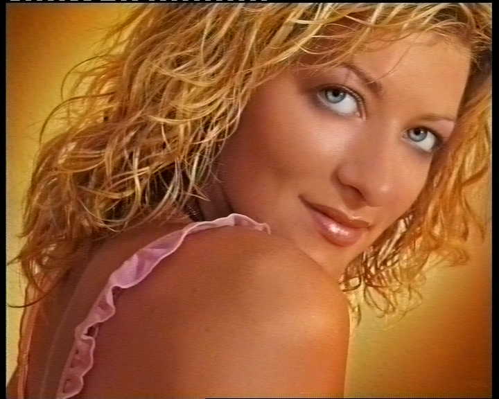

    Hi.
    Sorry my english is bad.

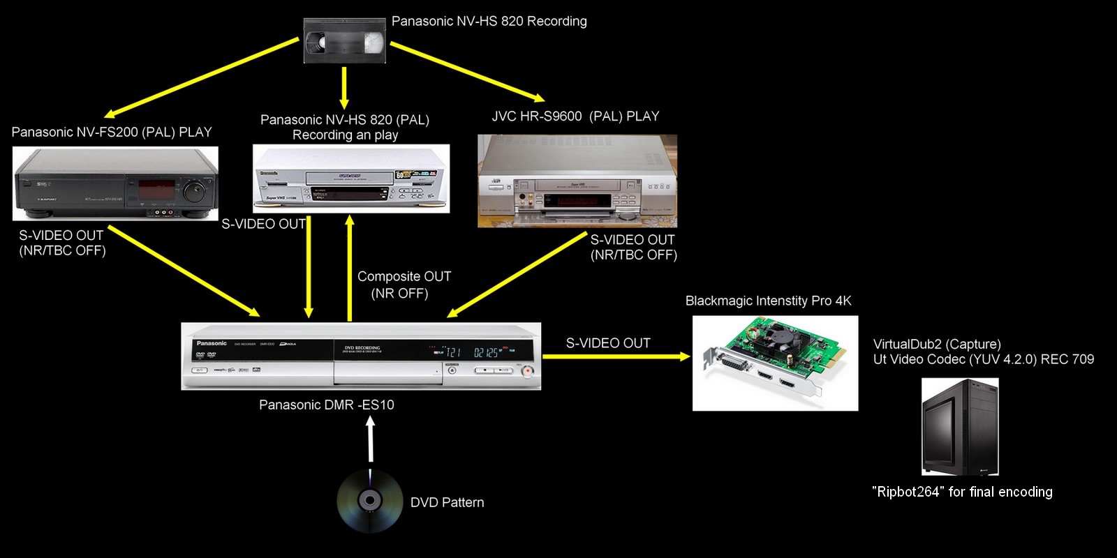

    Here is my capture equipment as well as the connections for this capture
    [Attachment 66433 - Click to enlarge]
    Normally from my Panasonic DMR-ES10 I go out in S-Video, but for this test I didn't have enough cable and I didn't want to unplug everything behind my devices

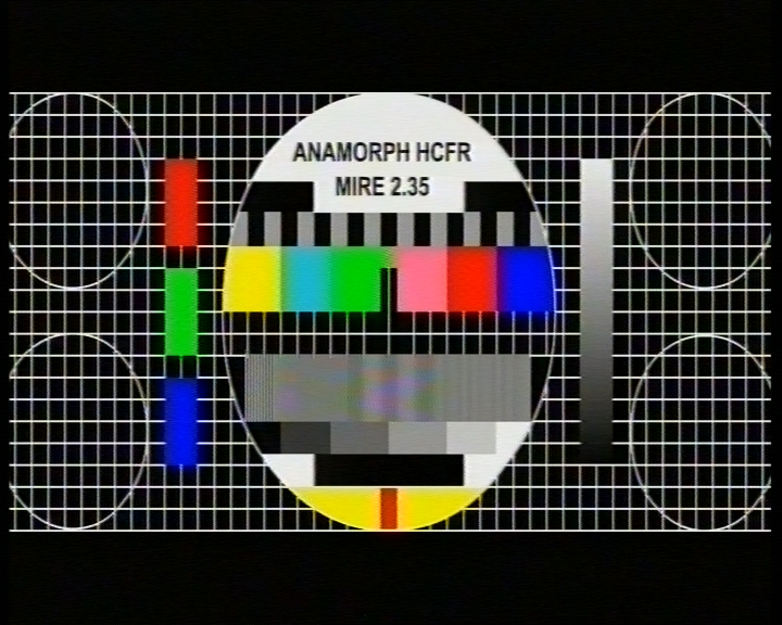

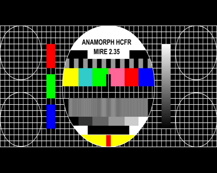

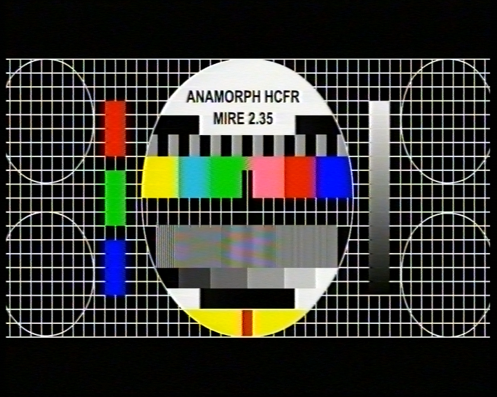

    TEST 1
    DVD original
    [Attachment 66434 - Click to enlarge]
    Panasonic NV-HS820
    [Attachment 66435 - Click to enlarge]
    Panasonic NV-FS200
    [Attachment 66436 - Click to enlarge]
    JVC HR-S9600
    [Attachment 66437 - Click to enlarge]

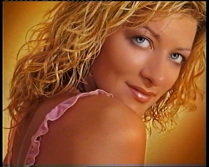

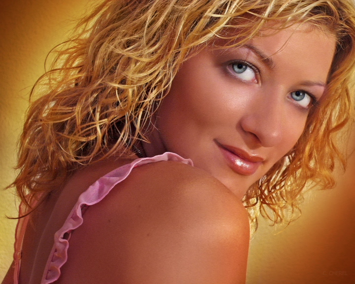

    TEST 2
    DVD original
    [Attachment 66438 - Click to enlarge]
    Panasonic NV-HS820
    [Attachment 66439 - Click to enlarge]
    Panasonic NV-FS200
    [Attachment 66440 - Click to enlarge]
    JVC HR-S9600
    [Attachment 66441 - Click to enlarge]
    If you have any suggestions for me, they are welcome.

  3. Using s-video throughout will eliminate the dot crawl and rainbow artifacts.
    Blackmagic also makes crappy cards for analog SD input.
    Jan 2016
    If you are testing don't use lossy DVD mpeg-2, Use lossless digital stills or more efficient lossy video codecs. The baked in mpeg-2 artifacts can be seen even through a dull VHS recording.
