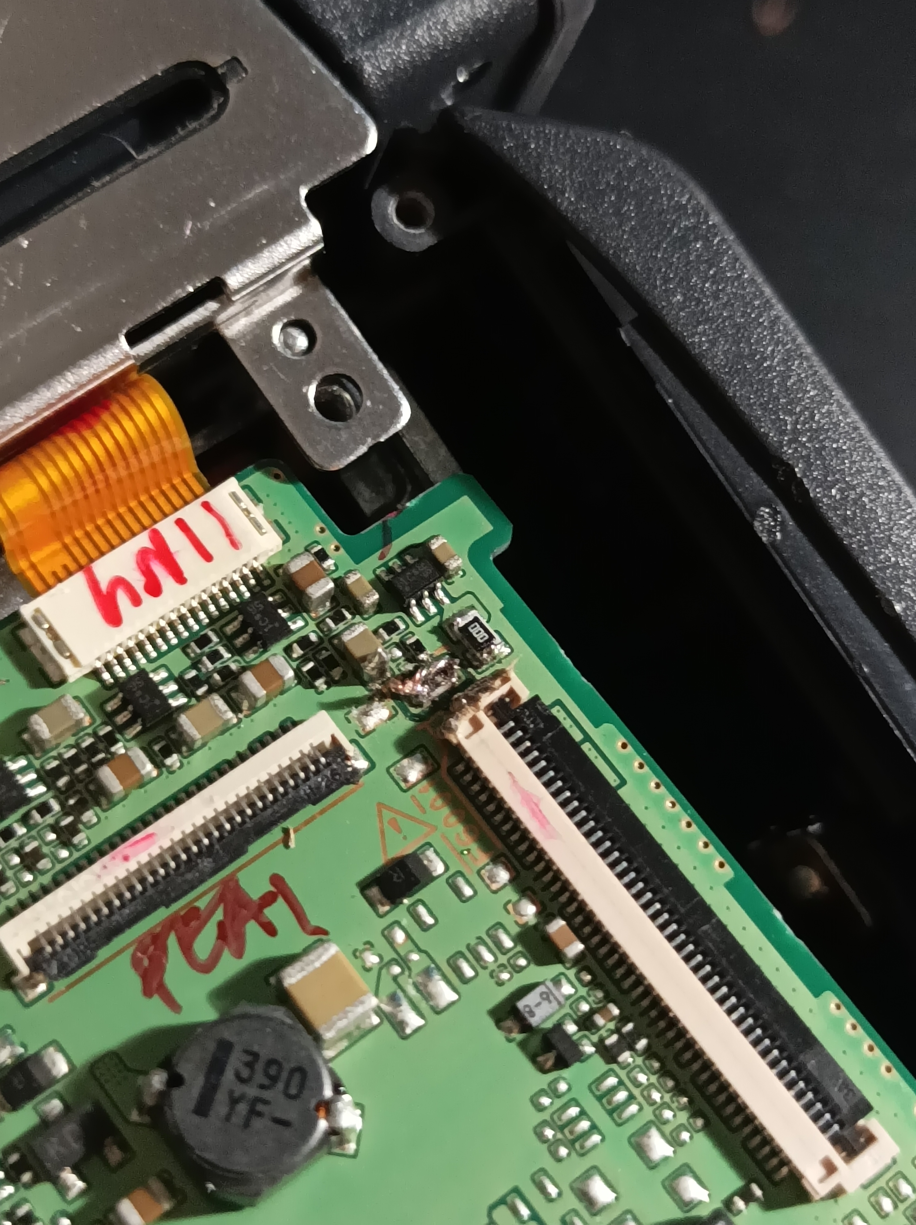

  11. So I have a very belated update to this. I have still not solved the problem, but I've made a lot more progress, and since the purpose of a forum is to document and archive knowledge for reference, I wanted to provide what I have learned.
    TL;DR - Jumping a blown fuse fixed an unrelated battery/power issue, audio issue still persists, more diagnosis work needed to figure that out.

    At this point I had to start taking it apart. @DB83 thank you for linking the service manual, this thing was an actual nightmare to disassemble even WITH instructions. It has a thousand screws, all different lengths so you have to keep track, and even once you take the screws out it feels like it will snap if you don't pull the pieces apart JUST the right way, genuinely seems like it was built to be put together and never opened again. Since it's from 2004 and they tried to make it such a small form factor it is all extremely tightly puzzle-pieced together and impossible to pull back apart. But enough complaining - I did in fact manage to take it apart.
    I tested all of the pins and connectors on the ribbon cable connecting the rear module, since that's where the power comes from and where the battery is mounted, but everything came back normal and as expected.
    I was a bit stuck because the circuit board is way more complex than any others I've looked at so far (all my previous repairs have been pretty simple stuff) and I had a really difficult time figuring out how to read the schematics sheet. I tried to look up some camcorder repair videos, just to get a feel for what good basic troubleshooting steps are. I found this one, and even though it's a totally different kind of camcorder, decided to watch: https://www.youtube.com/watch?v=C5DNd54ksgE
    In his case, a blown fuse was the culprit. Well, I didn't have any other leads, so I poked around in the open camcorder and immediately located a fuse on the main circuit board (F6001), and after testing it, found that it was indeed blown! No continuity on the circuit across it.
    I also tested the 2 fuses on the other board just out of curiosity but they were fine.
    After looking at the schematics again, it looks like this fuse comes right off of the main power and is like point 1 of failure on the whole machine's power system, so it would be a high priority to fix.
    If I were doing this repair for professional standards, first of all I am NOT qualified for that, but I would want to replace the fuse with another fuse. However, at this point I just want the dumb thing to work, so I decided - as with the person in the video - to just try to jumper across it.
    Approximately 3 of the most frustrating hours of my life later, I somehow managed to do it. I melted the plastic of one of the adjacent ribbon cable clips in doing so and also melted some solder on adjacent components, because this thing is FREAKING TINY. But I did it. I was testing continuity between one of the pins on the ribbon cable connecting to the rear module and a capacitor on the backside, because those were the 2 first points I found that connected to the two ends of the fuse respectively. So I was able to be certain I'd jumped over the fuse by testing those points.
    I am not above posting my horrendous solder job as a visual aid:
    [Attachment 83123 - Click to enlarge]
    [Marker is not mine, it looked like that when I opened it.]
    But I can say that this seems to have fixed most of the power issues.
    Fixed symptoms (jumping fuse F6001):
    • Not having enough power to rewind tapes even when plugged directly into outlet
    • Battery seems to charge more and hold a charge better
    • "Unit in Safeguard Mode - Remove and Reattach Battery" message MUCH less frequent (but has still appeared)
    Now, I suspect the battery itself may have gotten screwed up by whatever was wrong with it before, so I might try to get a new one eventually and test. Or maybe it just needs a few cycles of fully draining the battery and recharging to fix itself. But from the limited testing I've done so far it definitely is a much happier camcorder. If it's plugged directly into an outlet it works perfectly and if it's on battery it's much more reliable than it was before. So that's all great.
