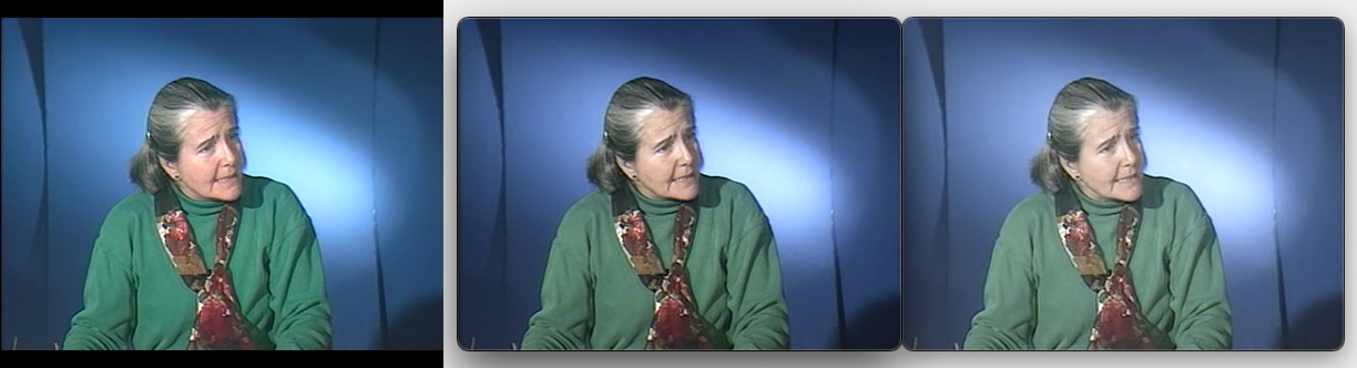

  1. whenever I use handbrake to transcode from wmv to AVC/HEVC, the picture gets washed out. It's losing contrast or gamma or something.
    Is there some way to better preserve color/tone?

    Actually both your screenshots are incorrect in terms of levels and color
    Here is what is should look like. Left is correct. Notice the difference skin tones and "green shirt"
    You might have multiple issues going on. Possibly a renderer issue, or gpu settings or drivers.
    How are you viewing it and taking screenshots ? (what software, how is it configured)
    [Attachment 66400 - Click to enlarge]

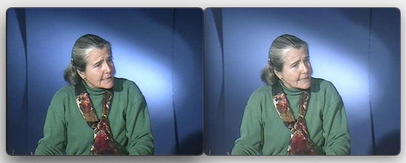

  10. This is what I see, before and after encoding with Handbrake:
    [Attachment 66401 - Click to enlarge]
    The same as poisondeathray. That's using a rec.601 matrix.

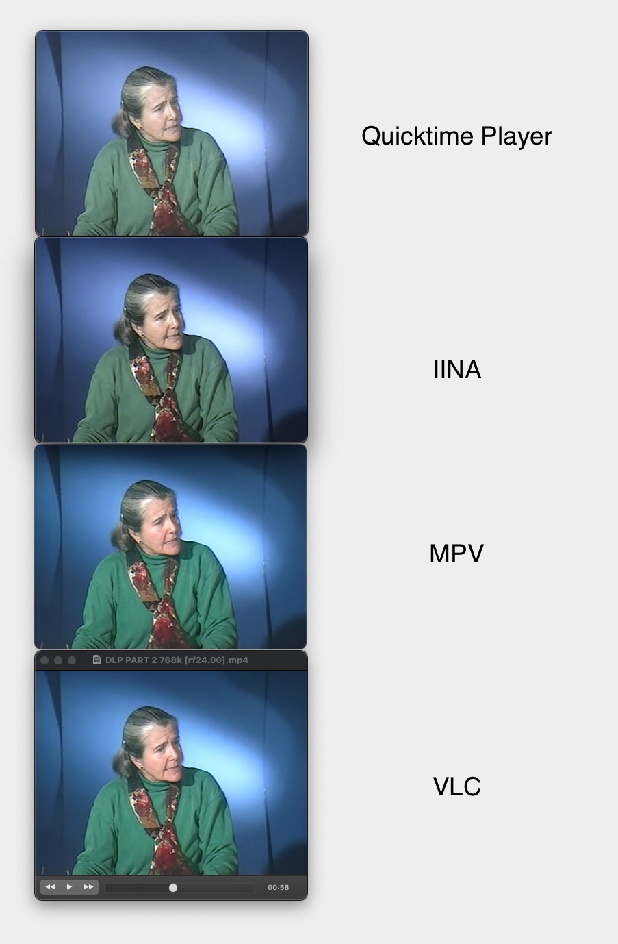

  11. Turns out it is the player. In fact I get 4 different pictures, from 4 different players, with the same file. All have default video settings. No filters.
    I'm really surprised. Why so much inconsistency? It almost looks like they are choosing arbitrary colors. Do we have no control at all with what our videos will look like to other people?

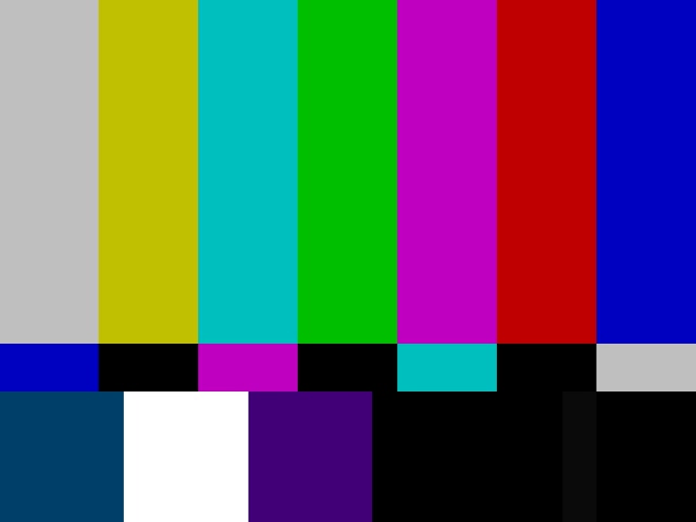

  13. standard 75% colorbars and tone , as "square pixel" 640x480, using wmv3
    For example, "red" should be rendered in RGB as 191,0,0 using computer RGB . In this example it will be 191,0,1 because of 8bit precision and rounding errors .
    It should look something like this in a media player if rendered properly. Usually a common culprit is the renderer choice, and quicktime will always be different
    [Attachment 66405 - Click to enlarge]

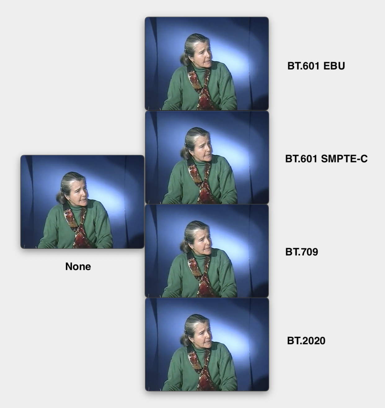

  14. Originally Posted by ProWo View Post
    Check the colorspace and colorrange settings of handbrake
    I re-encoded the same file several times with the same settings. Only changing the colorspace for each one.
    Here they are opened in the same player (IINA). I can't see any color difference between them.
    thanks for the file
