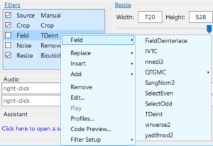

  4. The original DGIndex won't open MKVs but I think DGIndexNV will, or there's another DGIndex flavour that does, but I haven't used them.
    DVDs were designed for interlaced television, so officially there was only one frame rate of 29.97fps (25fps for PAL). Although to be more exact, it's 59.97 fields per second (50 fields per second for PAL). Progressive-scan players that can perform IVTC and/or de-interlace etc came later.
    The original DGIndex, and I assume the newer versions, output 29.97fps or 25fps (there's a force film mode but that's another story) so if the video has film sections (23.976fps) with soft-telecine via repeat field flags, DGIndex would obey them and output 29.97fps. A video with soft-telecine in parts and encoded telecine in others would not be uncommon.
    When the option to extract timecodes is disabled in StaxRip, the video is probably decoded at 29.97fps (ffms2 and lsmash can be told to do that too).
    I don't rip DVDs with MakeMKV, but I assume if MediaInfo reports a VFR, it's not looking for repeat field flags as such, and therefore probably reports a VFR.
    Assuming the video is being decoded at 29.97fps, you then have to decide on the filtering required. If it's 100% progressive, there's no de-interlacing or IVTC needed, If it's mostly interlaced you'd de-interlace, if it's all telecine you'd apply inverse telecine, and if it's a hybrid DVD it probably needs both, but in different sections while also converting to a CFR. StaxRip definitely supports the TIVTC plugin for dealing with hybrid video, but I can't tell you how to configure it, or even how to go about determining the type of source you have when using StaxRip, which is pretty important to know so the correct filtering can be applied.
    TIVTC does seem to be a standard menu item, but as I've no idea how to configure it in the GUI, hopefully a StaxRip user will come along and help you there.
    [Attachment 66383 - Click to enlarge]
