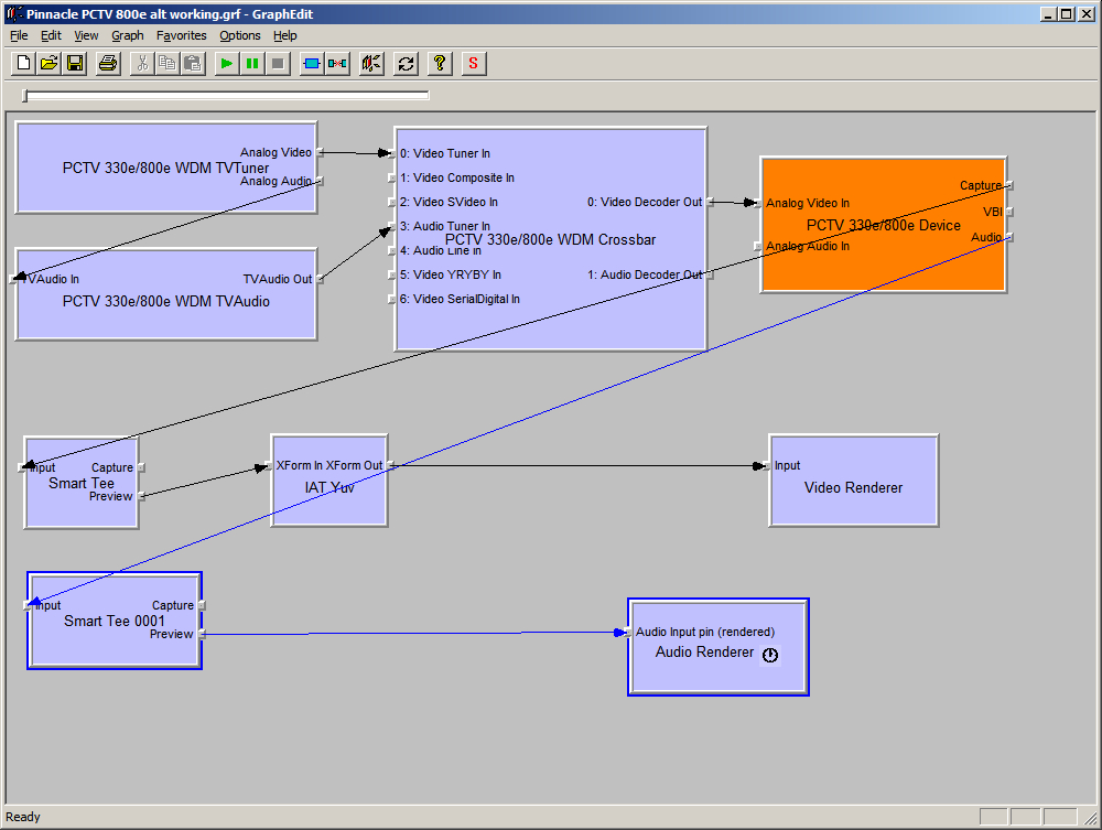

    This is a working Graph for the PCTV 800e
    Under the hood most capture software will be using something similar.
    The extra SmartTee filters are to provide "extra buffers" in case the USB port is overloaded or the stream isn't smooth.. it buys a little stability and can playback.. okay.. but thats only because it pops and clicks dropping samples to keep up with the video.

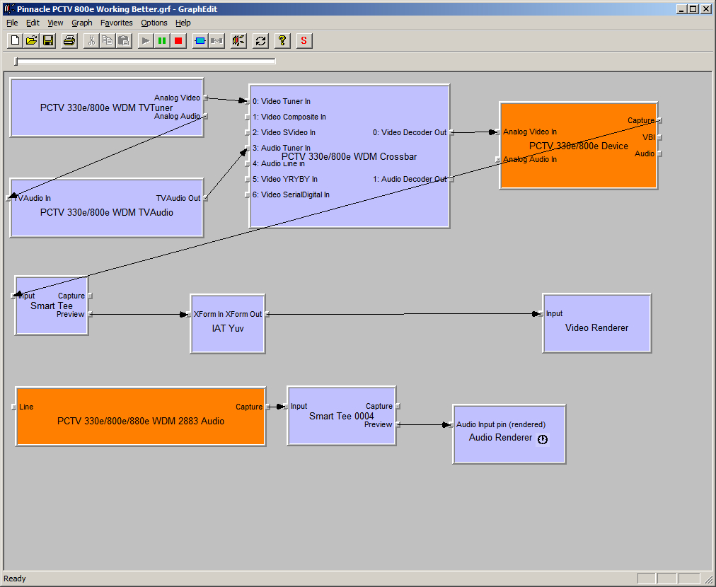

    Feb 2018
    College Station, TX, USA
    This is a much better Graph, few or no clicks and pops.
    But its highly un-intuitive, most capture software will not want to treat a single capture device as independent free-running pieces of hardware.
    Especially when they are attached to the PC by a single USB connection.
    The fact that I could find a "weird" pattern, to make it work.. which VirtualDub obviously does not want to use it like this.. points towards the possibility that the original PCTV 800e TV Capture software probably does work.
    Its simply that their hardware and driver architecture are so unusual you won't be able to use more conventional "universal" capture software.
    I'm not much of a programmer.. but Directshow has old fashioned VisualBasic 'Bindings' .. so you don't have to write a program in Visual C++ to make a working capture program.
    If you were really into doing stuff old and crusty and not give up on this device.
    Its an interesting museum piece.. but there are easier to use replacements that work better with VirtualDub or AmaRec out of the box.
