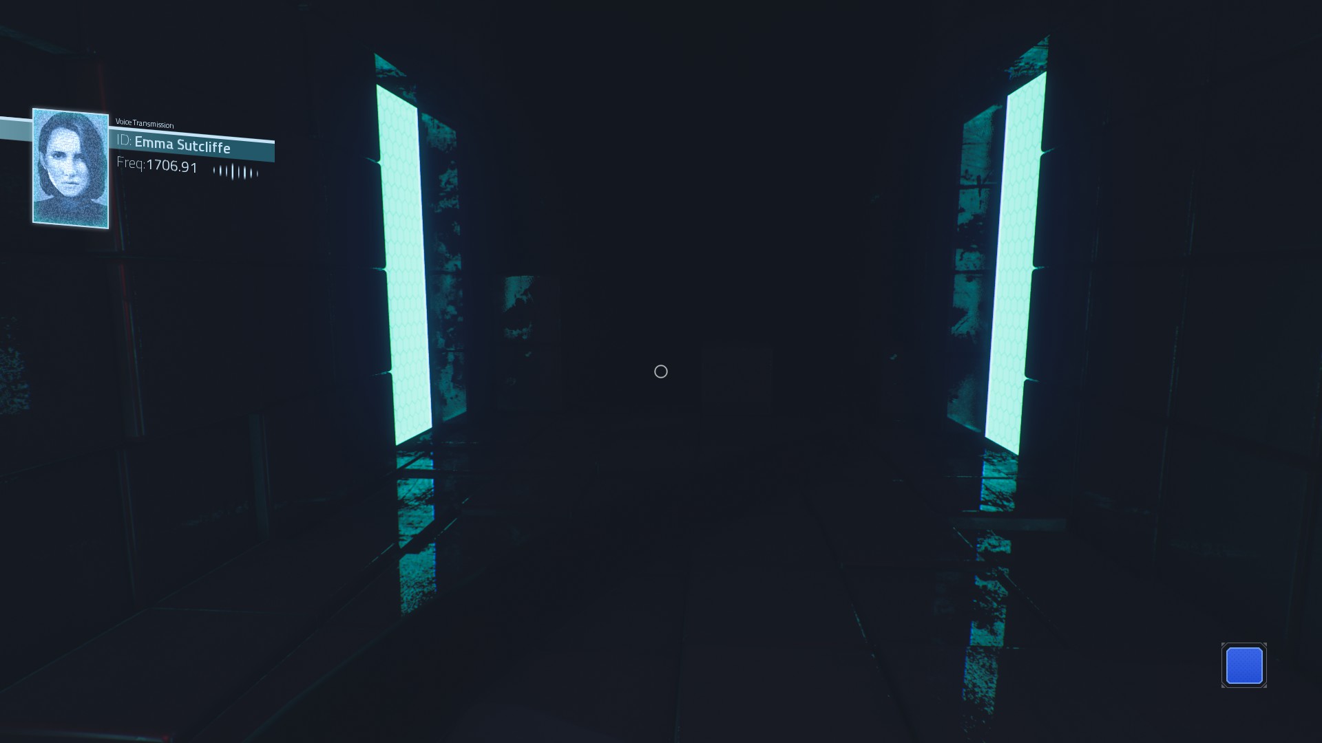

    Hello! I have been recording game play footage to upload, with commentary, to Youtube. But the game is pretty dark in places. Is there a way to improve this any?

    Does it look this bad in the actual game? Is your capture good but the youtube version is bad?
    What method was used to record it? Looks like the black levels were crushed, the shadow detail lost
    Jan 2013

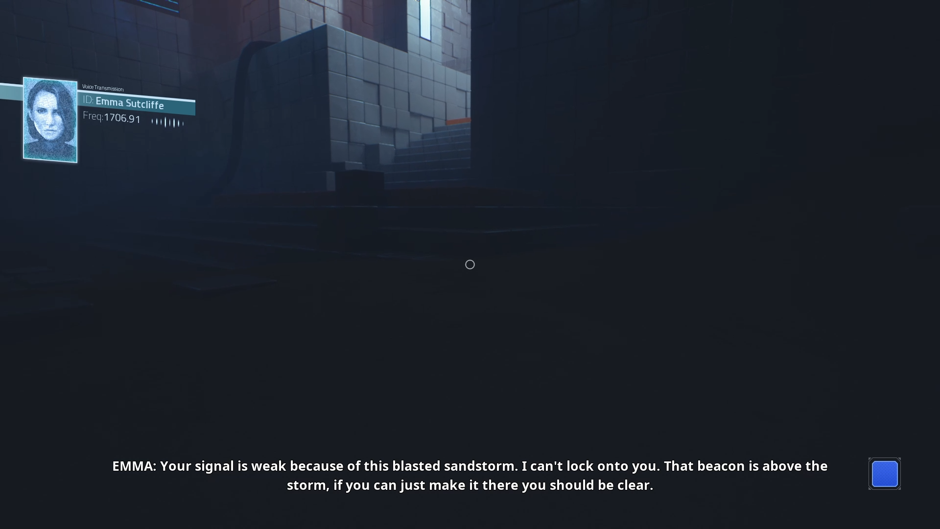

    Looks like that in game, the above is from Kdenlive but ... Let me see... I'll attach an image that I took from the game itself though Steam's F12.
    Ideally I'd find a way, though OBS, to fix it but I've tried all the filters available and didn't see one that would help any. That or if someone knows the hidden (and so far, my Google-Fu skills are failing to find ) console commands for Unreal / Q.U.B.E 2 , that'll let me adjust more than just brightness (that's the only color adjustment available in game). As you can see, the textures and stuff are there, just the devs felt the need to not include light sources. Then I could rerecord it better. This isn't the first ( and I doubt the last ) game I'll find with really bad video adjustment settings. >.<

    Hard to draw any conclusions from that, two different images. What corrections did you have in mind?

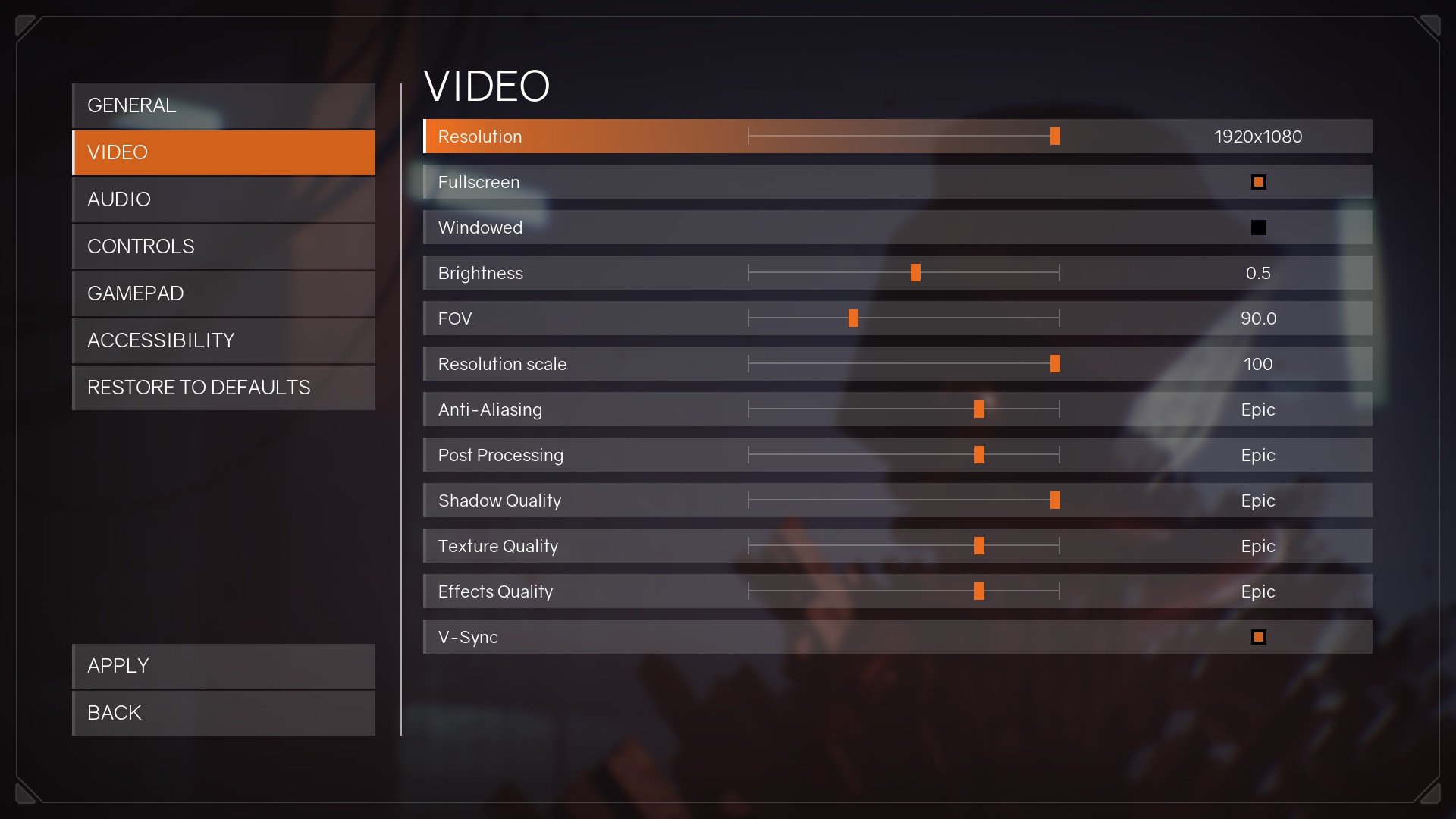

    Don't you have any settings in the game itself to improve the video quality?
    Jan 2013
    The contrast range is reduced, perhaps that's typical in games.
    It's pretty murky in the shadows, but even still poisondeathray's suggestion
    should be tried. Use curves to very slightly brighten the values
    that correspond to those shadows.
    This is all the options, and brightness only makes the light areas washed out and the dark areas grey.
