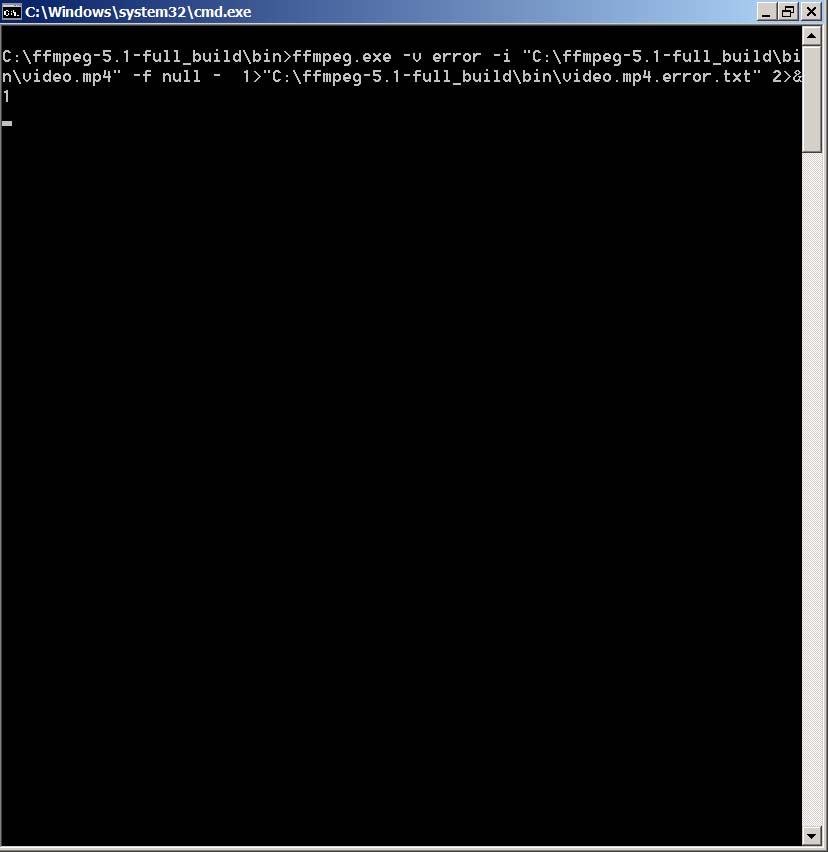

    Yes both the video file and the *.bat were in c:\ffmpeg-5.1-full_build\bin.
    I added the new code you provided and tried it with two different videos with known errors (the ones I used in my examples in the OP).
    When I run the first video file, the command line window looks like in cmd1.jpg that I am attaching here. The log file is blank despite the video starts out with a bunch of very obvious jibberish as seen in example1.jpg.
    When I run the second video file, the command line window looks indentical to as in the first case. Also blank log file.
    Any ideas of why the errors are not recognized? It's impossible to miss them when looking at the video. The one in the second example goes on for several seconds.
    Thanks for helping me.
    [Attachment 66362 - Click to enlarge]
  6. Note that ffmpeg is detecting errors in the encoding/decoding (corrupt, missing, or extra data), not errors in the video that was encoded therein. There's no way for it to know if what you see as picture corruption is supposed to be there or not.
