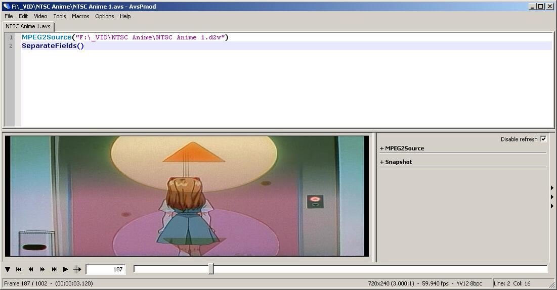

  8. Yes but the blending in question mostly is a"full frame" blending. I've seen a lot of it (some with 18fps 8mm sources, and some of them with 24/25fps 16mm sources). None of them blends half of the frame, they either do full or none. I am asking why does the partial frame blending occur, and I have only ever seen it happen with 90s anime (tho it might have too occurred with celluloid-filmed live action TV).
  9. I see. But you know that the picture you showed us is only one field (after seperatefields())?
  10. Yes it was from a doom9 thread. Will send a sample once I get to my computer

    Most of that comes from extreme linear detail converted to video, and then the video framerate adjustments. At a quick glance, the OP here sees obvious blended deinterlacing seemingly applied to telecine. A lot of it was bad processing at the budget operations converting lowly anime 15-25 years ago, while hamfisted homebrewers screwed it up for downloads and fansubs/dubs. I've seen worse. When I worked for studios, I truly hated dealing with pre-digitized analog sources. It was always screwed up in some way, and I had to restore it.
  12. I believe the partial blend was created with a crossblend of the film frames while recording to analog tape in real time. So during the crossblends each successive scanline gets a blend with less of the previous frame and more of the next. Presumably and attempt to reduce flicker. They weren't concerned with your attempt to inverse telecine the video 30 years later.

    Not really. I'm positive that at least the Evangelion tape source stayed untouched until it got onto the DVD, since the DVD release the blending is present on was officially released in 2015 for the sole purpose of showcasing the original tape telecines.
  15. You wanted to load up a sample, would be interesting.
  16. That one should do, thought it's not the best possible sample. I will send another one later
  17. Thanks, jagabo.
