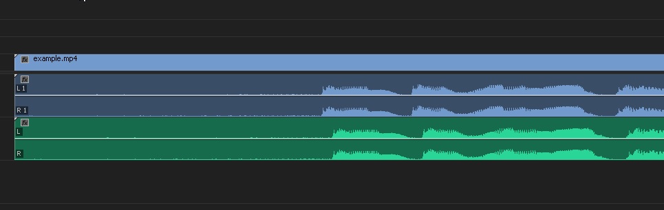

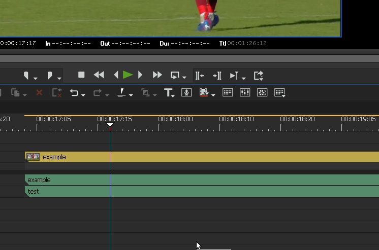

    I try to put in timeline using edius and premiere the source file example.mp4 and in the audio track the result of ffmpeg test.wav
    [Attachment 66279 - Click to enlarge]
    [Attachment 66280 - Click to enlarge]
    The source is a italian speeck however there is a litte non-sync audio between the source and the .wav? Why? thanks

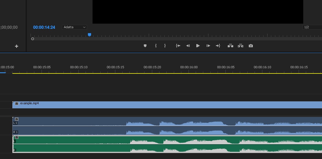

    and place the .wav in premiere to compare to example.mp4 but at the moment I still see the delay (however also the .m4a semms not in sync with example.mp4)

  11. @ marcorocchini ,
    I don't have a software that shows the timeline type graphs edius and premiere do.
    I also don't speak Italian but I found a part of the video where a man was talking & the lipsync looked OK to me.
    The video I created with the video extracted from your original video & the .wav file I created form the extracted .m4a.
    There is a 00:00:00.013 difference in the video & audio.
    HTML Code:
      Duration: 00:01:09.33, start: 0.000000, bitrate: 11564 kb/s
        Stream #0:0(eng): Video: h264 (High), yuv420p(tv, bt709), 1920x1080 [SAR 1:1 DAR 16:9], 25 fps, 25 tbr, 1k tbn, 50 tbc (default)
        Metadata:
          HANDLER_NAME    : ?Mainconcept Video Media Handler
          DURATION        : 00:01:09.320000000
        Stream #0:1: Audio: pcm_s16le, 48000 Hz, 2 channels, s16, 1536 kb/s (default)
        Metadata:
          DURATION        : 00:01:09.333000000
    This is the video I created;
    Try it in edius and premiere to see what the graphs show.
    I did use -vsync -1 in the code to maybe make the sync be better.
    I also took a look at the example.mp4 with AVStoDVD.
    Its' Title Info(detailed shows this:
    For the video: Time: 00:01:09.320
    For the Audio: Time: 00:01:09.355
    This means the origin is not in sync.
