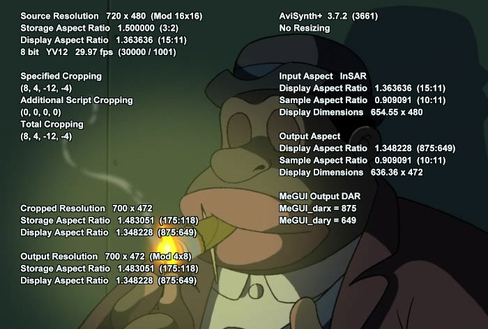

    If you use Avisynth at all, have a play with the CropResize script in my signature. It'll do the math for you and show what's coming in and going out.
    As an example, applying a cropping of 8,4,-12,-4 to an NTSC DVD while assuming an 8:9 sample/pixel aspect ratio.
    CropResize(0,0, 8,4,-12,-4, NoResize=true, InSAR=8.0/9.0, Info=true)
    [Attachment 66341 - Click to enlarge]
    Same again with a 10:11 sample/pixel aspect ratio
    CropResize(0,0, 8,4,-12,-4, NoResize=true, InSAR=10.0/11.0, Info=true)
    [Attachment 66342 - Click to enlarge]

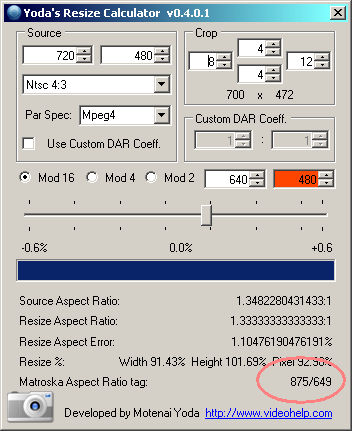

    If you're not into Avisynth, you could play around with this instead.
    https://www.videohelp.com/software/Yodas-Resize-Calculator
    You specify the source type and for PAL and NTSC DVDs you can choose your preferred PAR flavour, add whatever cropping you're using and it'll tell you what the output DAR will be. You can ignore the resizing and any aspect error that might be shown given you're not resizing, so all you need to worry about is the Matroska Aspect Ratio tag at the bottom, which is just the output DAR and should always be exact.
    Here's the same cropping as for the examples above, while assuming a 10:11 PAR. As you can see, the calculated DAR matches the Output DAR in the 2nd screenshot.
    [Attachment 66344 - Click to enlarge]

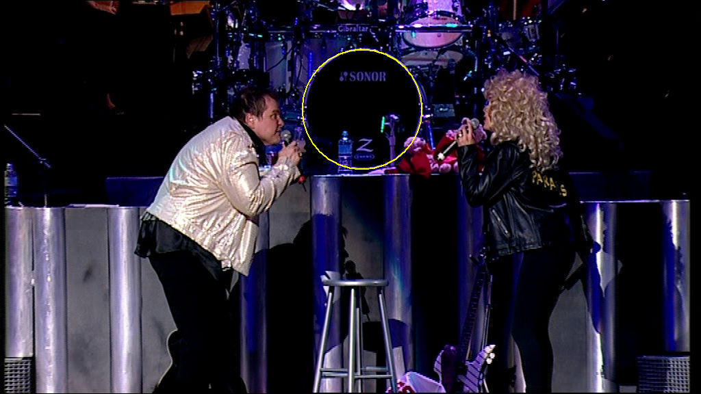

    For this one I drew circles over the picture (I still have the pics as I was debating the DAR in another forum) but if you switch between the screenshots, the circles can appear to change shape even though they're perfectly round each time.
    It's an example of a 16:9 DVD having a 20:11 DAR, but it's not typical these days.
    https://i.postimg.cc/59QQSm1r/generic.jpg
    https://i.postimg.cc/CK6djR2Y/mpeg4.jpg
    https://i.postimg.cc/mDG2yMSx/1-1024x576-00000.png
    https://i.postimg.cc/9X7sjKVB/1-1048x576-00000.png
    https://i.postimg.cc/2yrQM1rM/2-1024x576-00000.png
    https://i.postimg.cc/qvh3ms2g/2-1048x576-00000.png
    If you look at either of these for a short while, when you switch to the other one your brain will probably decide it's the wrong one, even if it's not.

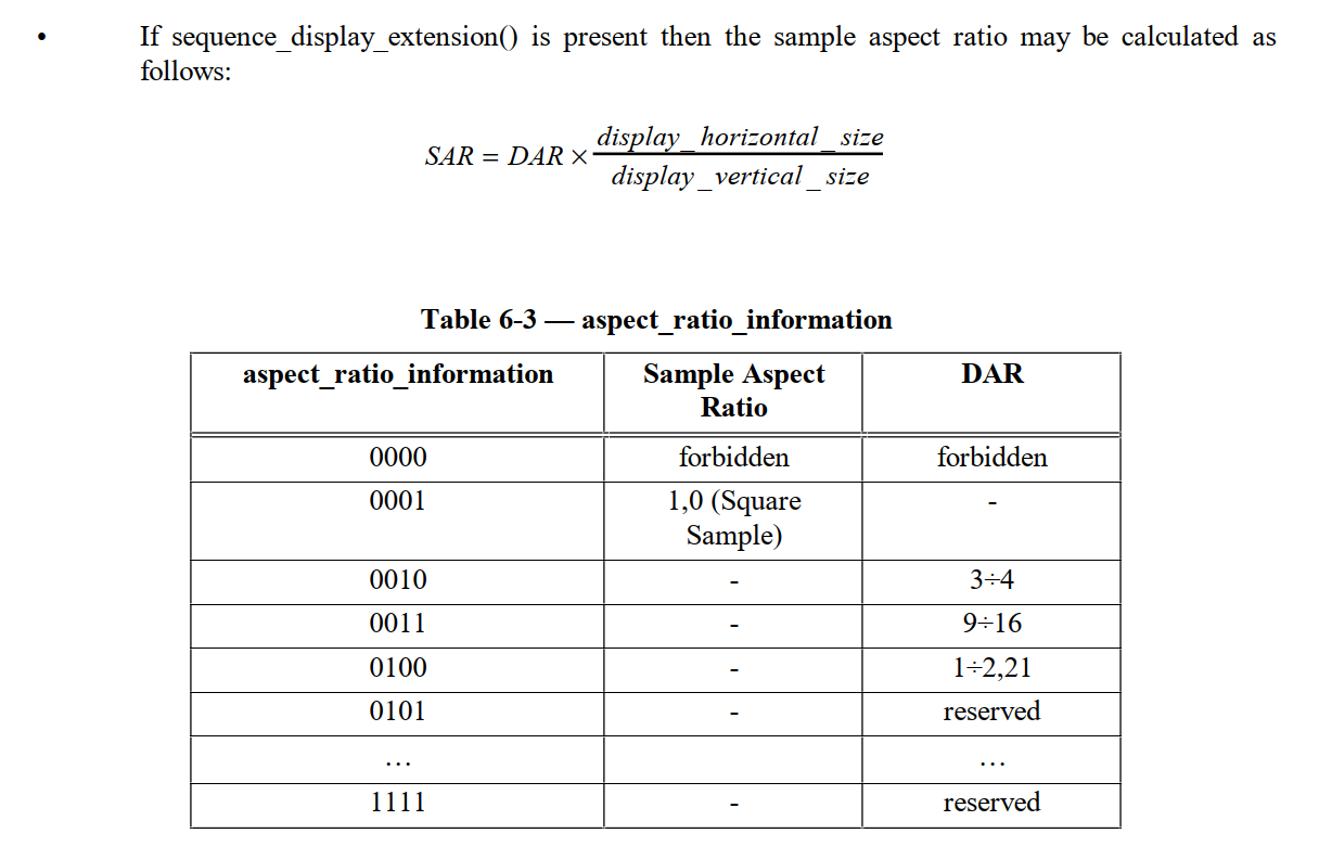

    Because Handbrake follows the MPEG 2 spec when dealing with MPEG 2 video. The DVD spec refers to the MPEG 2 spec regarding aspect ratios. The MPEG 2 spec is very clear: only three Display Aspect ratios (4:3, 16:9 and 2.21:1) and one Sample Aspect Ratio (1:1) can be flagged. In the case of the DARs the entire frame comprises the DAR. From the ISO 13818-2 doc:
    [Attachment 66354 - Click to enlarge]
    The problem is that most (?) DVDs made from old analog tapes are captured according to the ITU spec (with a 720x480 or 720x576 frame), then just encoded for DVD without compensating for the difference between the two specs.

    If you can find a straight-on shot of something that should be round... a car wheel or a clock-face etc, you can do what I did above and take a screenshot and draw circles over it with an image editor. I've even done something similar with a straight-on shot of a 4:3 CRT screen or a 16:9 LCD screen when my DAR OCD has become too annoying (I recall a few instances of the stargate not being round on some Stargate SG1 DVDs, but neither 20:11 or 16:9 seemed to be correct).
    Another method, which is prone to confirmation bias though, is to open a DVD in MPC-HC. It'll display as either exactly 4:3 or 16:9. If you tap the 6 key on the numeric keypad once it'll stretch the width, which co-incidently is the difference between 4:3 and 15:11. It's not exact (probably 2%) but it's a simple way to switch between a generic and mpeg4 aspect ratio while watching the video. The 5 key always resets it, the 4 key reduces the width, and the other keys do other stuff, sometimes in combination with holding down the Ctrl key (I think), which moves the video left or right etc rather than stretch it.

    ... and the possible ~2% AR error will continue to create a lot of confusion and noise, I think

  19. Originally Posted by hello_hello
    This is really clever thanks for sharing. Wonder if I can load up my encoded 8/9 PAR NTSC videos into this and test both DARs.

    Because DVD are mpeg2 and follow the specs shown in post #15 which does not support non-square PAR signalling, the full frames (i.e. including the green pillars) of Example1 will be displayed at 4:3 (1.3333...) and the active (useful) picture will be horizontally slightly squeezed (~2%). Therefore cropping of the side pillars and encoding at 704x480 4:3 is recommended in such case (Example2).

  24. Originally Posted by Firestorm View Post
    You can. I'm pretty sure the width is stretched by the same percentage regardless of the resolution or the shape of the pixels. 2% or maybe 2.5%, so it'll still work even if you resized to square pixel dimensions based on an 8:9 PAR for the DVD.
    Or you can do it the other way. Tap the 4 key once and it'll reduce the width by the same percentage, so if you used a 10:11 PAR for the encode that'll make it (roughly) display as though it was encoded with an 8:9 PAR.
    If you stretch it more... tap the 6 key three or four times instead of just once.... and watch the video that way for a bit while your brain adjusts.... 8:9 and 10:11 can both look wrong when you go back to one of those DARs, although sometimes when I'm having a hard time trying to decide which one is correct, I deliberately stretch the video too much as a kind of reset for my brain, but I don't know how effective that really is. I probably just like to believe it helps.

    Keep in mind that mpeg2 DVD does not specify the PAR, but only the DAR (like 4:3, see table in post#15). Hence, for Example1 (encoded as mpeg2 for DVD) the square and circle would be slightly (~2%) horizontally squeezed when the player forces the full frame to 4:3.
