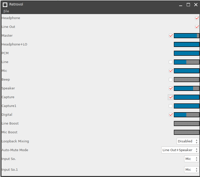

    I was able to get a cheap microphone working in Puppy Linux - the trick seems to be checking the capture box in Retrovol
    It did not work when I just had Mic checked
    [Attachment 66359 - Click to enlarge]
    I then ran this command in terminal
    arecord -f cd -d 10 --device="hw:0,0" test-mic.wav
    after confirming that my sound card was device hw:0,0
    and I was able to play the wav file in DeaDBeeF
  13. VH Wanderer Ai Haibara's Avatar
    Jan 2006
    Somewhere on VideoHelp...
    I don't have that in retrovol, with either the C270 plugged in (USB) or an old microphone plugged into the microphone jack on the front panel of my tower. The only thing that I currently have in retrovol is the one (!) PCM slider for my external USB speakers.

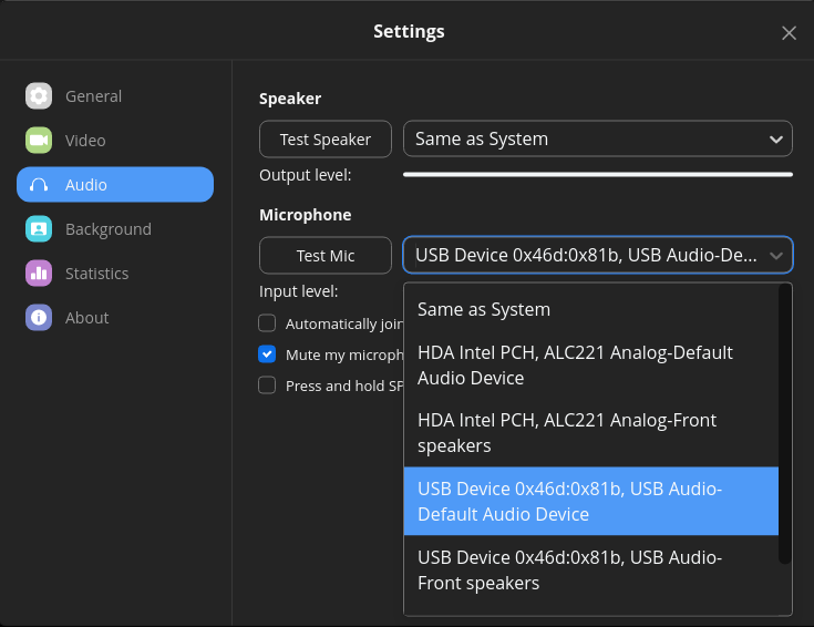

    I finally got my Logitech webcam.
    The webcam microphone works in Audacity
    The webcam video and audio capture work in guvcview
    I installed Zoom from Puppy Package Manger - Zoom showed up in the Network menu and created an icon
    I signed up at zoom.us but was unable to sign in from the desktop Zoom icon menu
    I tried Zoom in Firefox - the video worked but the microphone did not [the old mic plugged into the onboard sound card did work]
    Then I uninstalled the Puppy version of Zoom and installed the latest Zoom for Ubuntu
    Tried Zoom again in Firefox - the video worked but the microphone did not [the old mic plugged into the onboard sound card did work]
    Then I tried the latest Opera browser - and both the video and the webcam microphone worked!
    Then I uninstalled the Zoom app and deleted all Zoom entries [The Desktop client did not work in PuppyLinux]

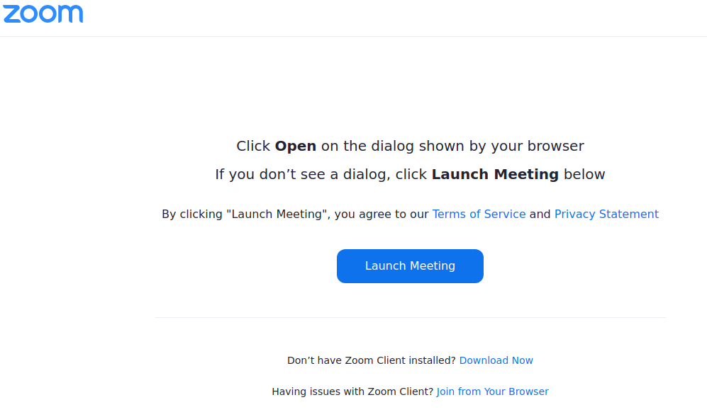

    To test Zoom in Opera, after signing in - I went to https://zoom.us/test
    This loads a Join Meeting page - I clicked on Join - I had to select "Join from Your Browser"
    [Attachment 66388 - Click to enlarge]
    then I clicked on Settings [on the bottom of the page]
    [Attachment 66387 - Click to enlarge]
    It also works the same way in Chrome as it does in Opera
