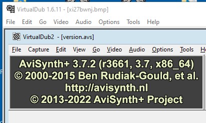

    That is a simple AviSynth script. When you open a script with that AviSynth will create a small video with the AviSynth version number:
    [Attachment 66294 - Click to enlarge]
    That will tell you if AviSynth is installed, what version, and what bitness.

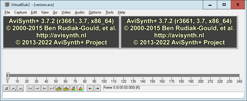

    Thank you jagabo, Sharc and davexnet, I have dropped Attachment 66294 into my present version of VirtualDub and this is what I get:Image
    [Attachment 66323 - Click to enlarge]
    Is this what you need? If not, I am sorry because I am still getting used to the totally different 'mechanics' of Windows 10..

  22. That means 64 bit AviSynth+ is installed and you accessed it via 64 bit VirtualDub2 -- because only 64 bit AviSynth can be accessed by a 64 bit editor/encoder. 32 bit and 64 bit AviSynth+ can coexist on the same Windows installation. If you access the same script via 32 bit VirtualDub (or other edit with AviSynth support) you'll know whether 32 bit AviSynth+ is also installed (32 bit will show "i386" instead of "x86_64").
    But that only tells you if AviSynth itself is installed. Video Fred's script requires many third part filters. You need to download and install them too. Note that the bitness of those filters must mach the bitness of AviSynth. 32 bit editors require 32 bit AviSynth and 32 bit AviSynth filters. 64 bit editors require 64 bit AviSynth and 64 bit AviSynth filters.
