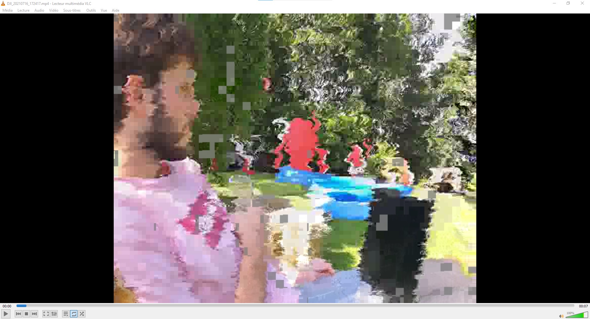

    I made videos using an "Honor 10" smartphone and a DJI Osmo 2 stabilizer.
    It turns out that all mp4 files are unreadable when they are launched on any local player from my PC (VLC, Windows media Player, Premiere Pro...)

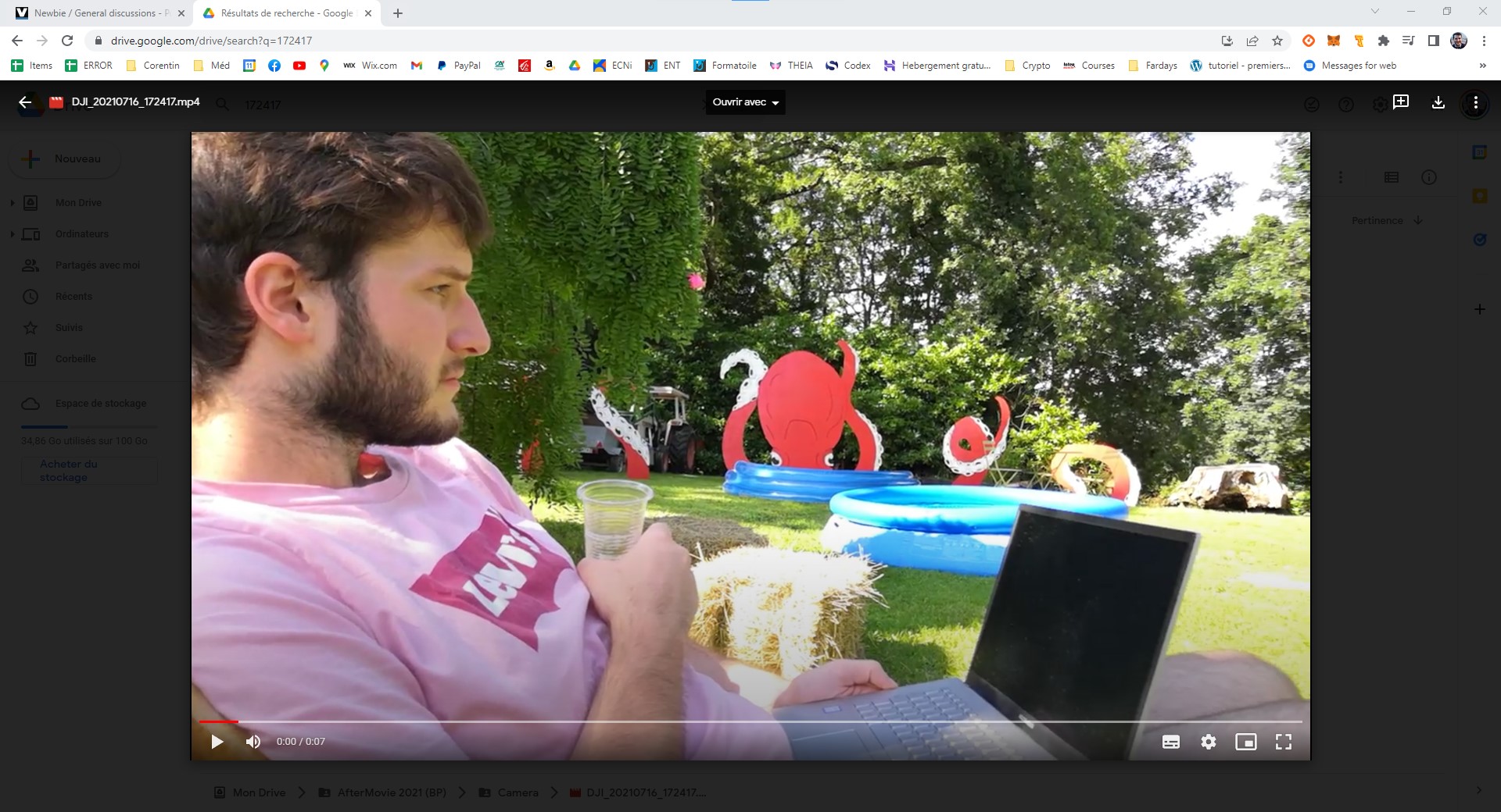

    while they have no defects from any other device or even from an online reader (Google Drive, Youtube...)

    I have already reinstalled some codecs using "K-lite Codecs" but without success.
    I have been looking for a solution to this problem for several months without an answer... I hope you can help me!

  2. 1. accoding to mediainfo that is no .mp4 file but a wrongly names .avi file
    2. looking at the file with an hex editor is was created with "VLC Media Player - 3.0.16 Vetinari" since according to mediainfo it's using:
    Format : MPEG-4 Visual
    Codec ID : DIV3
    Codec ID/Hint : DivX 3 Low
    which isn't MPEG-4 compatible,... my guess is that whoever used VLC to repackage this messed up and used some wrong headers, since I highly doubt that any application that creates DivX3.11 would was developed in the last 10+ years.
    At least for that file google drive doesn't properly playback that file as you claimed.
    -> share a proper file
    Cu Selur

    Here is the link of the video on the Google Drive (https://drive.google.com/file/d/1oLpPHxJNB8UJFn6lacHOwXvIGpCiWmUC/view?usp=sharing) which is visible on the player and can be seen when downloaded on any device except mine...
    I really don't know how to repair this problem...

    The original file does not play properly on an android tablet with vlc, a xp pc with mpc-hc, nor on a win 7 pc with mpc-hc. The google drive video has been converted to a 4k avc and plays ok everywhere.
  17. There is some kind of corruption of this file.
    I tried working on it with ffmpeg,Clever, & also mkvtoolnix.
    None of these created a file that works on my players correctly.
    Those are VLC,MPCV-HC,MPC-BE,& Zoom.
    The audio track was also very low & barely audible.

    The first (Bad) file you posted only has a resolution of 720x576 and is 2.7mb in size.
    The second file (google drive) you posted has a resolution of 3840x2160 and is 29mb in size.
    The files have completely different specs.
    I'd say you grabbed the wrong version of the file from somewhere or something has wrongly converted it in your system.
  19. DJI_20210716_172417.mp4 from Post #1 is corrupt and cannot be restored.
    FromGoogleDrive_DJI_20210716_172417.mp4 works, but has a very hight resolution your computer maybe isn't able to play properly.
    Try if this one is playable on your computer
