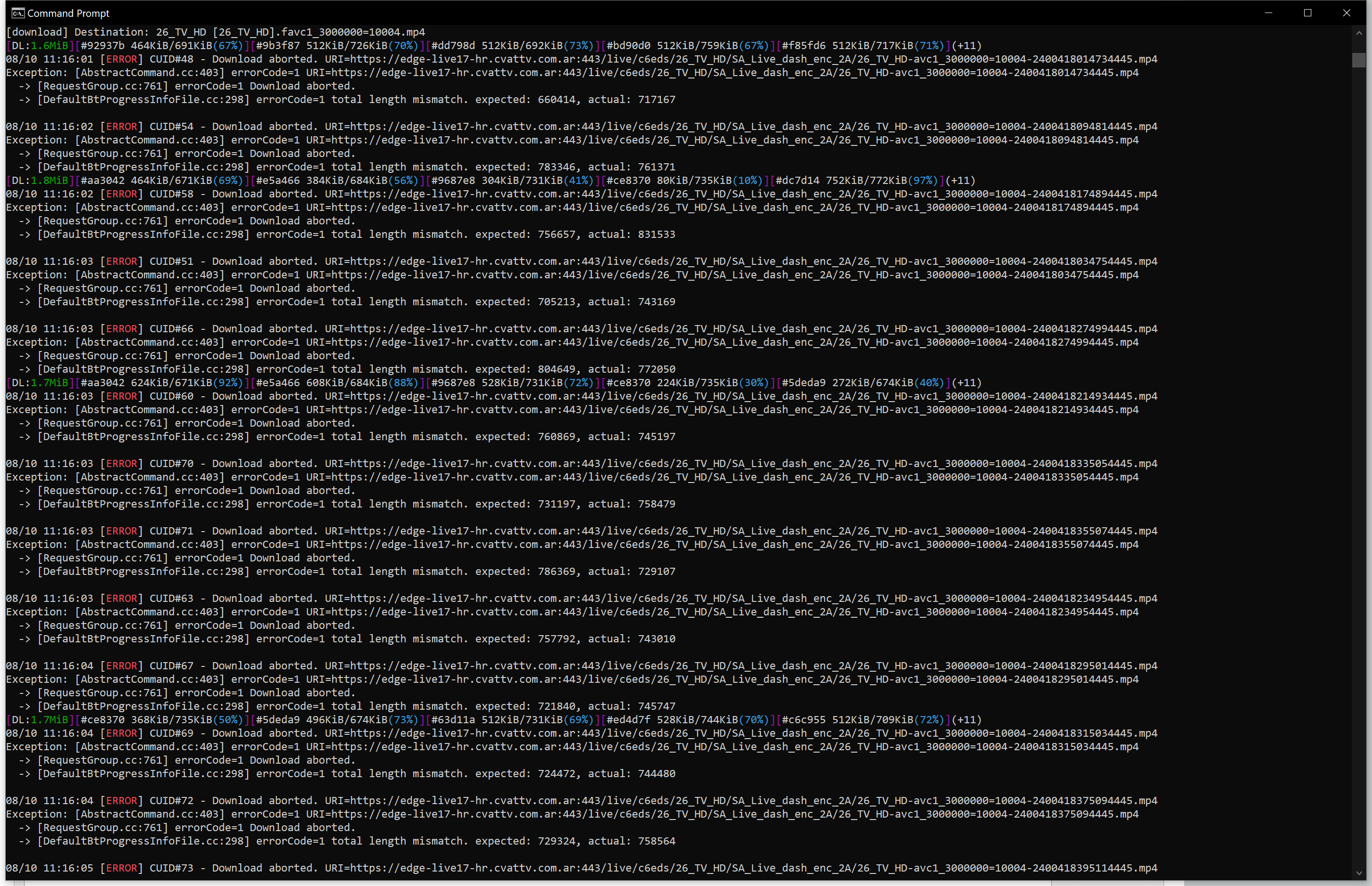

    So, as you are right, in the end I got 2 files, video and audio, mp4 and m4a
    Unfortunately, there were many errors during the download, don't know why... (also see screenshot, the code below is just a snippet)
    [DL:0B][#e404ac 0B/0B][#c79051 0B/0B][#657cb6 0B/0B][#74ef66 0B/0B][#5daf6a 0B/0B](+11)
    08/10 12:10:41 [ERROR] CUID#54 - Download aborted. URI=https://edge-live17-hr.cvattv.com.ar:443/live/c6eds/26_TV_HD/SA_Live_dash_enc_2A/26_TV_HD-avc1_3000000=10004-2400418395114445.mp4
    Exception: [AbstractCommand.cc:403] errorCode=1 URI=https://edge-live17-hr.cvattv.com.ar:443/live/c6eds/26_TV_HD/SA_Live_dash_enc_2A/26_TV_HD-avc1_3000000=10004-2400418395114445.mp4
    -> [RequestGroup.cc:761] errorCode=1 Download aborted.
    -> [DefaultBtProgressInfoFile.cc:298] errorCode=1 total length mismatch. expected: 749927, actual: 749446
    [DL:0B][#efe45d 0B/0B][#143f05 0B/0B][#831412 0B/0B][#b700a5 0B/0B][#611d79 0B/0B]
    aria2 will resume download if the transfer is restarted.
    If there are any errors, then see the log file. See '-l' option in help/man page for details.
    [Attachment 66254 - Click to enlarge]

    Just out of curiosity, why is the speed so slow? Does it have to do anything with the decryption? Do you think I can download an encrypted file with higher speed (actually, live speed 1.0x, like streamlink) and decrypt later using mp4decrypt?
    I'm not sure. FFmpeg sometimes download files very slowly, regardless of our connection speed, but in your case it's too slow. Are you sure you copied the command exactly as I wrote it?
    Anyway, what you could try is to download the audio and video separately. If there's an improvement in download speed, then the problem is the decryption and/or multiplexing process. But then you'll have another problem, because you'll have to mux both files and synchronize them if there's a delay in one of them.

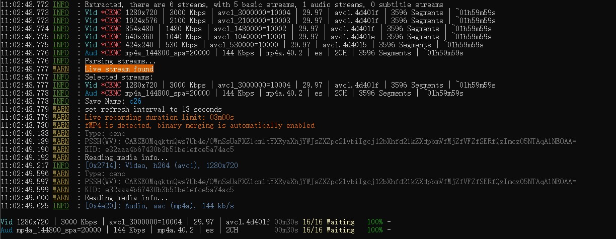

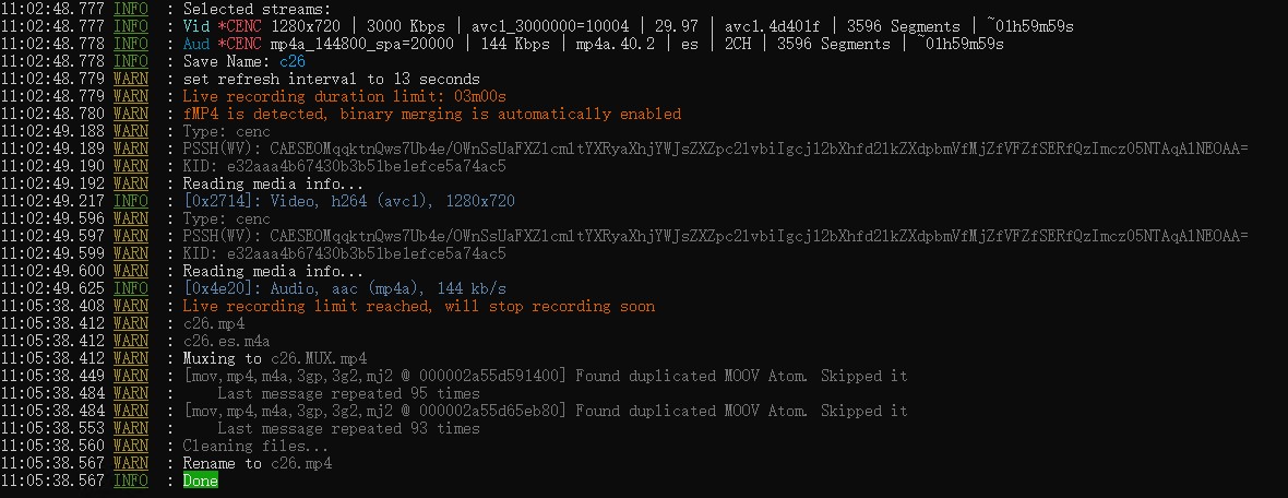

  13. Yet another solution:
    N_m3u8DL-RE: https://github.com/nilaoda/N_m3u8DL-RE/releases/
    Need shaka-packager, ffmpeg
    Sample to record 3 minutes, and mux to mp4.
    N_m3u8DL-RE "https://cdn.cvattv.com.ar/live/c6eds/26_TV_HD/SA_Live_dash_enc/26_TV_HD.mpd" --auto-select --save-name c26 --mux-after-done mp4 --use-shaka-packager --key e32aaa4b67430b3b51be1efce5a74ac5:ad60c5e1d378a97271bf8688f094d092 --live-keep-segments false --live-real-time-merge --live-record-limit 00:03:00

  14. It muxes at the end? Does that mean it (before) decrypts automatically?
  15. Originally Posted by Quint View Post
    the wonderful N_m3u8DL-RE with --mux-after-done mp4 first download, then decrypt, then merged final audio+video on mp4 file
  16. Great comfort. But you still have to pass the key...
  17. without key no decryption ...
    and RE work all-in-one, while yt-dlp needs a manual step or batch file for decryption
