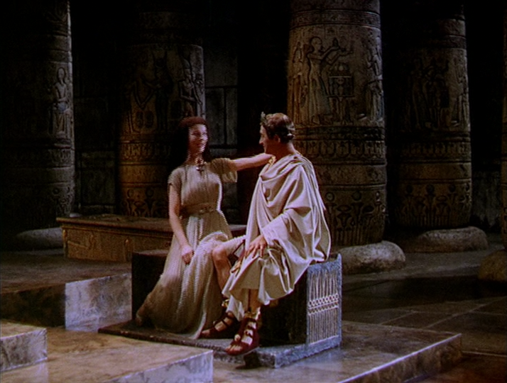

    I'm attaching a capture of what I mean by combing; and yes, you are right, the dvd is the source.
    [Attachment 66242 - Click to enlarge]
  7. Your screenshot shows combing, but there is none if you IVTC it with TIVTC.
    The default post processing will deinterlace if combing is detected , and that frame is detected. You can use display=true to see which frames are deinterlaced to tweak the threshold detection values /settings, or use another deinterlacing algorithm by specifying clip2
    You can look at the staxrip log to see what processing was done, and why it left combing

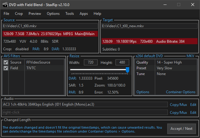

    I didn't use TIVTC because it showed me this values (That can't be right, can it?)
    [Attachment 66243 - Click to enlarge]
    Does it need additional configuration?
  10. Not sure, I don't really use staxrip... but I would use MPEG2Source for the Source filter. That is the most reliable for DVD source filter. FFVideoSource can be quite buggy depending on which version

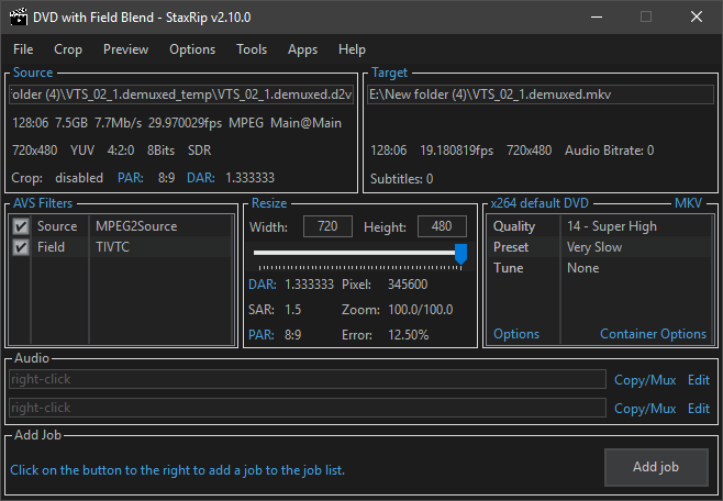

  12. Originally Posted by poisondeathray View Post
    Yes, I just was trying something different there, no knowing what else to do, the MPEG2Source shows this:
    [Attachment 66245 - Click to enlarge]
  13. If it's 19.18 output fps, probably you had dgindex field operation in "force film mode", which is incorrect because you don't have 100% film. Leave it with "honor pulldown flags". I dont' have staxrip installed on this computer

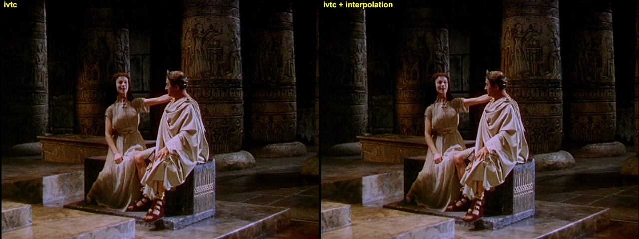

  21. These are ivtc'ed frames 273-281
    275, 279 are replaced by the Rife version in vapoursynth of RX, using the immediate neighboring frames, so it's a bit smoother
    It requires manual specifying frame numbers, so it's not automatic like SmoothSkip or John's script. Also interpolation can sometimes produce bad artifacts.
    This is an animated webp; it should animate in browsers like Chrome, Firefox
