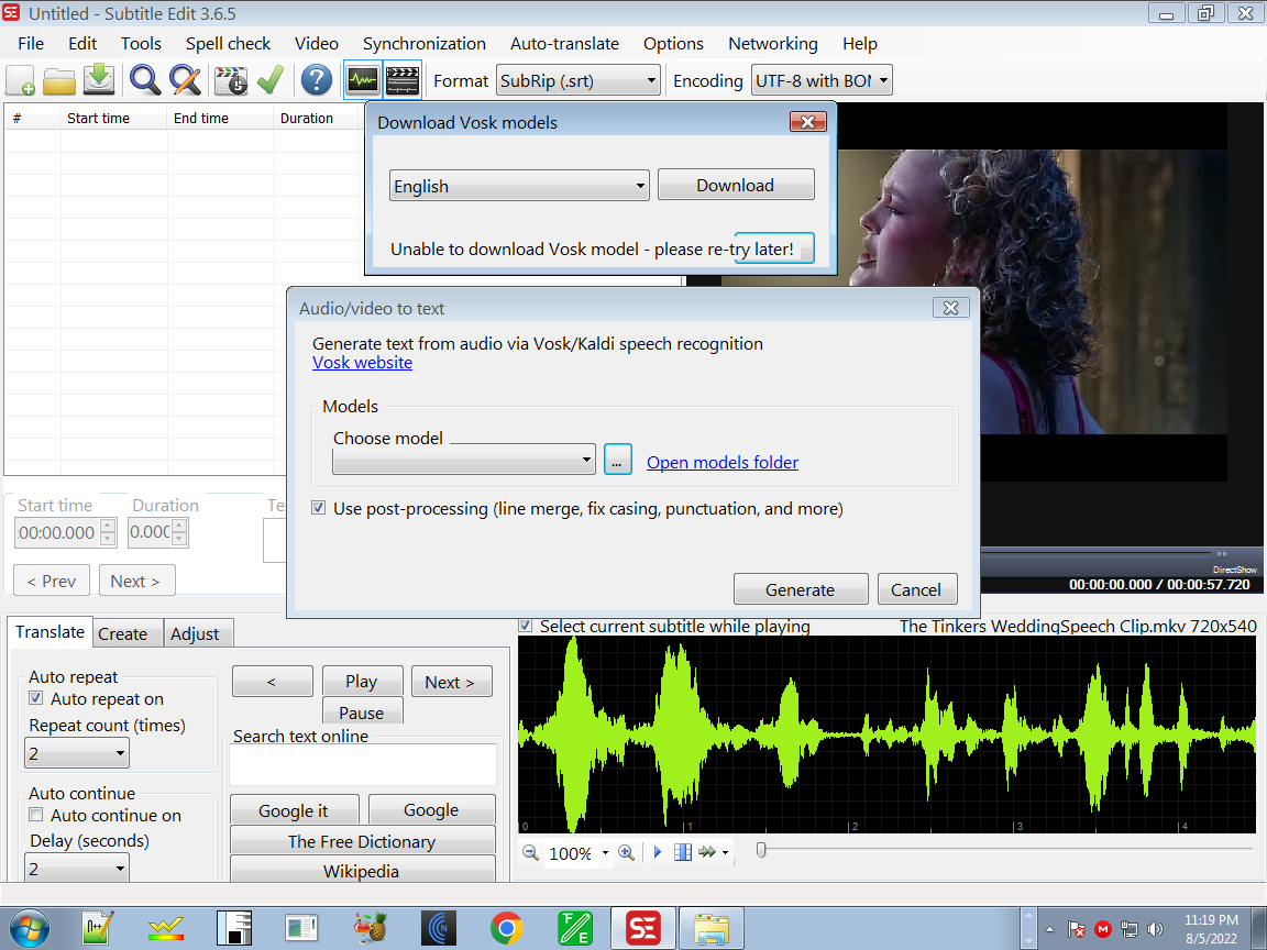

  11. Hello pcspeak and all.
    I know you are trying to help but I have no knowledge of command line code and so cannot follow much of it. Second I want to
    stay in the SE program proper in order to make a guide for anyone I know that wants to make subtitles for ( in my case )
    classic plays in the public domain previously Proshot from major theatres. Some of these are on disc and some come
    from elsewhere.
    My question was why I cannot download the proper language template to SE. Could be 3.6.5 or 3.6.6 etc.
    I don't see where this language template would be picked up by your code, but I can't use code. I'm just
    trying to get a method for using SE in the way the program provides.
    I have loaded a clip with wave form
    I have gone to SE > Video > Video/audio to text
    in that I've followed the prompts to download ffmpeg
    and the prompt to download VOSK 'models' in English. (English becomes visible under the three dots)
    That's where the error box pops up and says try again later.
    If I can get a good looking screen shot where everything is visible.... ok got it.
    From this point I have made no progress. Things like VOSK and the Kali Speech recognition engine are installed
    as the setup goes on. They are just terms I do not know the meaning of yet.
Name:	Tinkers Wedding Clip test Speech to Text.png

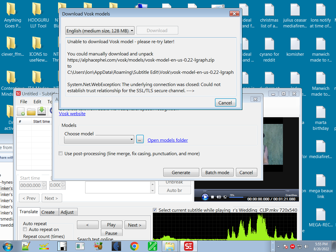

  20. I've made a new screen shot. It shows that I was able to add my clip into the processing area. I hit "Generate" to avoid the errors at the three dots which fails to complete the download.
    As you can see a similar message that a download doesn't complete but just says to try later repeats in the Add area.
    I had downloaded a model at Alphacephai which may be the wrong one. Where does Subtitle Edit look for the model-- where is the model supposed to land if it downloads? And which is the right model? The one I got just by guessing is called vosk-model-en-us-0.22.zip and is something over 2 gigabytes or something in size unzipped.
    That business with WAV files and such-- just too confusing to watch a mouse pointer.
    I have a system that works through Google Create. I can deal with that without command line or WAV files etc. I'll come back to this later.
  21. I'm still thinking about why the routine in Subtitle Edit for audio to video to speech fails to complete.
    The error is generated by SE not Windows 7 Pro which I have used only for many years. Can a problem be traced to how SE handles
    the Windows 7 Pro OS?
    In my defense, I have able to download Teseract within the SE program with no problem.
    For the future, since I have gone to Alphacepei several times to download the model, can this be provided
    as an option so that SE can find it?
  22. I'm still thinking about why the routine in Subtitle Edit for audio to video to speech fails to complete. The error is generated by SE not Windows 7 Pro which I have used only for many years. Can a problem be traced to how SE handles the old Windows 7 Pro OS compared to Win10 as example? Also in looking at Alphacephei there seems to be Linux style code and refs to Github. But I cannot diagnose things like that.
    In my defense, I am able to download Teseract within the SE program with no problem.
    For the future, since I have gone to Alphacepei several times to download the model, can that .zip file once unpacked be used to manually install at the proper folder so that SE can find it. The 'download portion' of the routine is the part that fails and gives the error.
  23. Progress.
    I went to Subtitle Edit and registred, then downloaded the newest 3.6.7 SE.
    On this one I got a help message displayed in the screenshot attached. I don't know anything about secure server settings and the like but at least the error is explained a bit.
    And I can put the 128 mb version of English I have where it needs to go but haven't done that yet.
Name:	subtitle edit download vsok manually.png
  24. Success with initial manual install.
    With the help of that message above I was able to manually install the lgraph version of the vosk. Once all of this is done the program works fine. And I've experimented with selecting the larger vosk which after unzipping the file is 2.Gb. I'm hoping that that is more accurate. Errors are common but some of the things I do are in dialect which may cause more errors.
