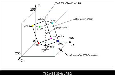

  12. Digital computer monitors are traditionally full range RGB. R=G=B=0 is black, R=G=B=255 is white. All other colors are between those two extremes with RGB values between 0 and 255.
    Digital TV signals (and storage) are traditionally limited range YCbCr, often called YUV (though technically it's not exactly the same thing). This is a rotation of the RGB colorspace with a greyscale (Y) axis, and two color components (Cb and Cr) that represent colors that are added or subtracted from the greyscale value:
    https://www.intel.com/content/www/us/en/develop/documentation/ipp-dev-reference/top/vo...or-models.html
    The inner cube in that image is the full range RGB cube. The outer cube is the full range YCbCr cube. The black corner of the RGB cube is near the bottom center of the YCbCr cube at Y=16, Cb=128, Cr=128. The white corner of the RGB cube is near the top center at Y=235, Cb=128, Cr=128. The minimum Cb and Cr values that fall within the RGB cube (ie, map to legal RGB values) are 16 (the yellow corner, for example). The max that maps to legal RGB values is 240 (the blue corner, for example). Any YCbCr combination that falls outside the inner cube are not valid RGB colors. Those are the limited range YCbCr values that map to valid RGB colors. Note that only about 1/6 of the possible YUV combinations lead to valid RGB colors.
    Full range YCbCr would have the RGB cube slightly larger -- so that the corners touch the edges of the YCbCr cube (0 and 255). Full range YCbCr was usually limited to editing, not for distribution.
    What ultimately shows up on the screen is RGB (with some exceptions you don't need to worry about unless you are developing TV screens) and most media files are internally limited range YCbCr (DVD, Blu-ray, Youtube, Netflix, etc.). So somewhere along the line that YCbCr must be converted to RGB so you can see it (your eyes can't see YCbCR). That can happen in the media player, in the graphics card, or within the TV.
    These days computer graphics cards can be set to output RGB or YCbCr, either limited range or full range. Most monitors and TVs can be set to receive RGB or YCbCr, either limited range or full range. So you need to configure both to get a correct image.
    And we are also moving beyond the traditional 8 bit RGB/YCbCr to higher bit depths, high dynamic range video, different rotations, etc.
