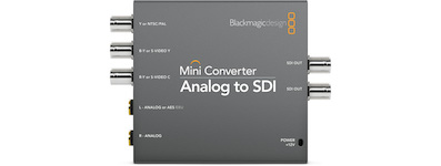

    BlackMagic Design has several options in converters and recorder type interfaces (Thunderbolt 3)
    My DMR ES-35V gives a stable signal for this setup, (Video Assist also) and just works, with a good TBC setup it should also work.
    The SDI to HDMI 3G allows you to import a LUT so you can color correct while you're capturing,
    [Attachment 66166 - Click to enlarge]
    composite, s-video, component to SDI
    [Attachment 66167 - Click to enlarge]
    [Attachment 66168 - Click to enlarge]
    SDI / HDMI to Thunderbolt 3

    Yeah, but it's a interface that needs a computer, you can't plug in a storage card/device, your Ninja 2 has no SDI
    You can do Analog to SDI and then SDI to HDMI for your Atomos, or SDI/HDMI to Thunderbolt 3 to your MAC,
    The cheap converters scale always to 16:9 because these devices are for gamers,(the scale function has a kind of TBC function i noticed, but you need to fix the ASR) i do know/have a cheap scaler to HDMI that leaves ASR intact, but has only component input, do you have component output ?
