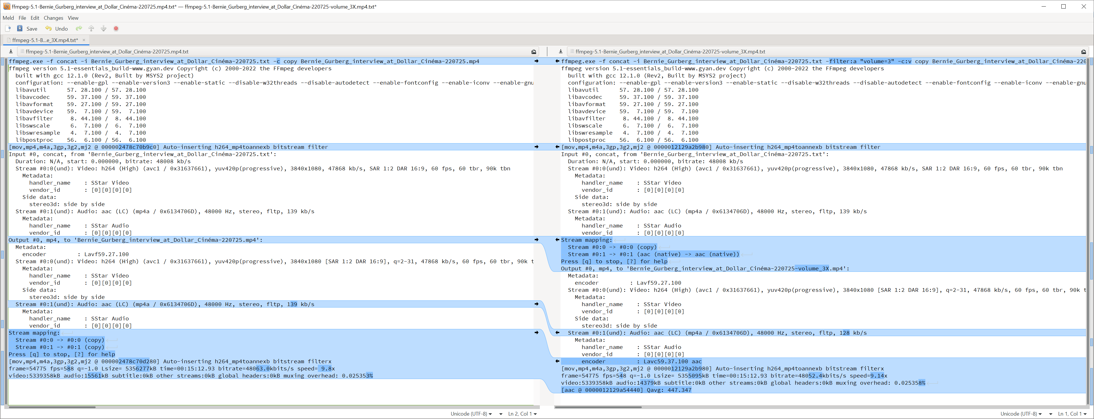

	I can't guarantee the video for both version are the same but it very much look like it. I ended up doing a 3X volume afterward as 2X was still too soft. Here's the comparison of both outputs:
 [Attachment 66196 - Click to enlarge]
 Thanks again
	The videos look the same to me.
