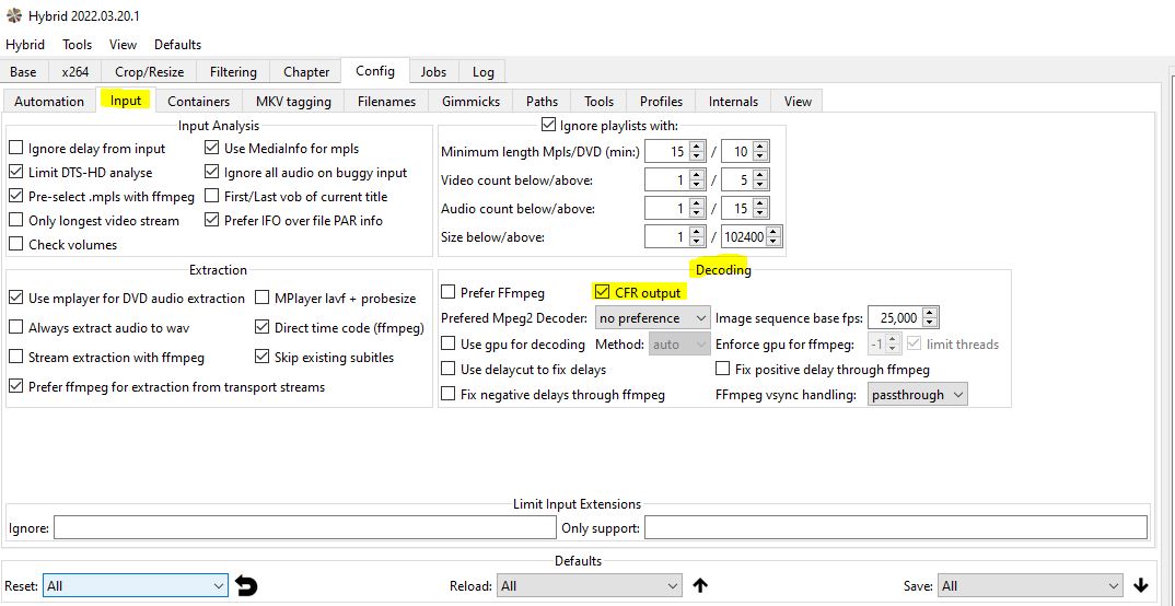

I searched all thru Hybrif for this "CFR" setting but the only thing I could find seems to deal with the INPUT for Hybrid itself, not the actual playback of the encoded files.
Or am I misunderstanding what this setting is for?
[Attachment 66181 - Click to enlarge] -
The setting you are highlightening tells the decoder to output the constant frame rate that was detected, even if the content is VFR.
If you open a file in Hybrid on the right side in the Video info box the frame rate is indicated by frame rate / frame rate mode.
For example 25/CFR would indicate 25fps constant frame rate, while 25/VFR would indicate 25fps variable frame rate.
Hybrid will not create VFR unless the input is already variable frame rate and no operation that enforces cfr decoding is used.
