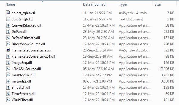

    Yep. I have installed avisynth+ with required plugins (except grunt as it is needed for debugging....I guess) ...& the output is:
    [Attachment 66203 - Click to enlarge]
    All visual studios present on the system... is attached as a screen shot to this message.......it seems to me:

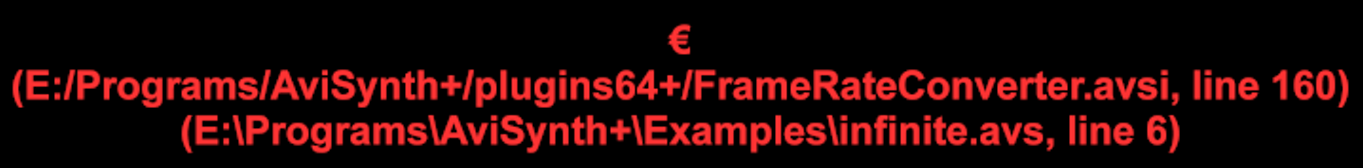

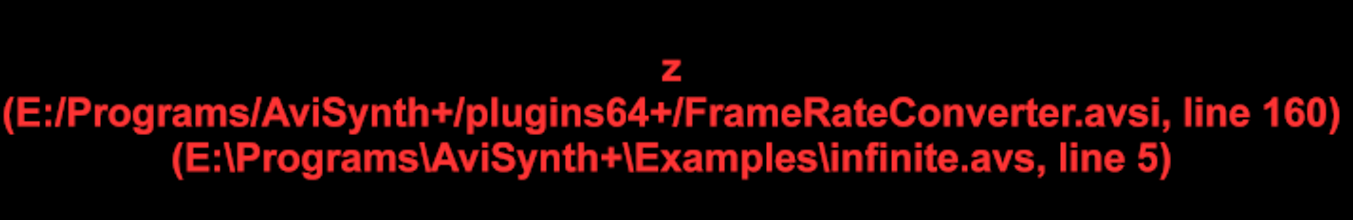

    Ok! Good to know that ...So the current set:
    SetMaxCPU("SSE2") # also tried SetMaxCpu("SSE4.2") as G3220 supports max SSE4.2
    v = LWLibavVideoSource("G:\Infinity\Originals\Final.mp4")
    a = LWLibavAudioSource("G:\Infinity\Originals\Final.mp4")
    AudioDub(v,a)
    AssumeFPS(26.054)
    FrameRateConverter(NewNum=60000, NewDen=1000)
    has output:
    [Attachment 66208 - Click to enlarge]
    Plugins installed in plugins64+ folder are:
    [Attachment 66209 - Click to enlarge]
  17. I tried FrameRateConverter 1.2.1 (the version I had installed ealier), 1.3, and 2.0 beta, dll and avsi files. All worked properly in 64 bit AviSynth+.
  18. Your last error message is "€" ??? and before that it was "z" ???

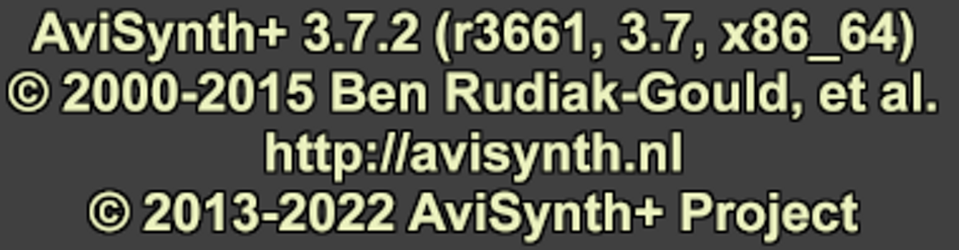

    What version of avs+ ?
    A one line script will report it
    version
    Jul 2022
    New Delhi
    version
    Output:
    [Attachment 66217 - Click to enlarge]
  20. Try AvsInfoTool to look for installation problems.
    That's the same version I'm using.
