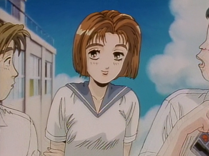

    I have tried to do a fair bit of research on my own prior to posting a topic on this subject but I would like some opinions on how best to improve my source DVDs if possible. I have been using Hybrid to get familiar with vapoursynth.
    I am working with the Funimation release of Initial D. So far my focus is on the first two stages/seasons because they are pretty rough to my eyes.
    The samples I provided hopefully illustrate what I want to fix. There appears to be a decent amount of noise in the image (sky and solid colors) and a somewhat blurred image overall. I am hoping to apply a sensible amount of sharpening and noise reduction so that it looks better on a modern display. In addition, I was hoping to correct some of the aliasing on the CG images without negatively affecting the traditional animation portion.
    I ran QTGMC with bob enabled and the 59.94 output looked smooth but I am wondering if maybe I am not seeing a telecine pattern and would be better served with IVTC? DGIndex shows Interlaced and NTSC, which I read could be indicative of a hard telecine. Then again anime is weird with various frame rates and other unusual considerations, so I was hoping someone could let me know what I should be doing with the source frame rate for sure.
    Thank you for coming to my TED talk.
    https://www.dropbox.com/sh/zyqpuzhv76wnln7/AABN6-o0TSAgKX_qzCld4oxGa?dl=0

  7. You can remove a lot of the blending with SRestore() in AviSynth. Then a little more with Dup1(). And reduce the frame bounce with Stab().
  8. There's significantly less blending visible now but it's still there.
    [Attachment 66147 - Click to enlarge]
  9. I said "You can remove a lot of the blending", not all of it.
  10. That is a good improvement to be sure. Jagabo, could I look at the script you used to produce your video sample? I must be doing something wrong because when I try those filters, the output becomes 25fps. I am currently using the default settings for all the filters you mentioned.

  11. I need a long smooth panning shot to determine if the frame rate should be 23.976 or 25.
    I was playing with the scrip a bit after uploading the file. So this might be a little different than the one I used.
    Mpeg2Source("noise.demuxed.d2v", Info=3)
    QTGMC(preset="fast")
    Stab()
    Crop(10,2,-10,-2)
    SRestore(frate=23.976)
    Dup1(threshold=3.0, maxcopies=2, blend=false)
    The last line removes some light ghosting that was caused by a temporal noise reduction filter. It may also lose some small motions -- like when a character is talking and the only thing moving is their lips. You can adjust the threshold value to reduce those losses but you will also reduce the effectiveness of the ghost removal.
