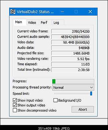

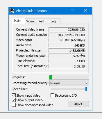

    while exporting to x264 or x265, the encoding stalls and never resumes, like this:

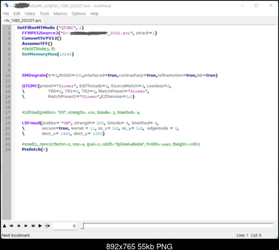

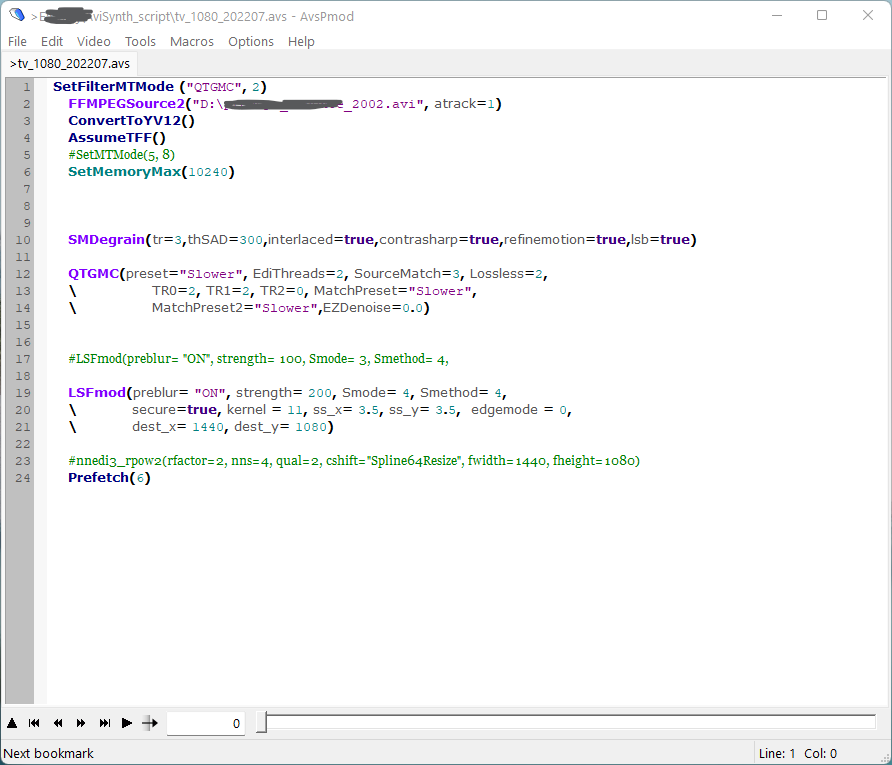

    The script is the one shown below. It takes a 37-minute sample YUY2 clip captured from a VHS, which gets some denoising, sharpening, QTGMC deinterlacing and 1080p upscaling.

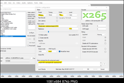

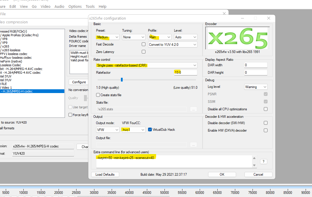

    I've then dragged the script into VirtualDub2 to encode it to x265 with the following settings:
    The encode goes on for some minutes, but then it stops and remains still on the progress bar... It completes the job for small videos, but it can't hold full vhs captures. I even tried changing the source codec from YUY2 to Lagarith... I couldn't event find any info about this online, and the same thing occurs while exporting in x264 with my other 720p script.

    Not related to the "hanging", but you should use ConvertToYV12(interlaced=true), otherwise the YUY to YV12 downsample can have chroma artifacts

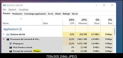

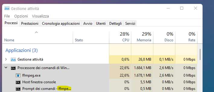

    Thank you! Now it doesn't stall anymore, but now it gets to 20-30% cpu usage
    By the way it completed the 720p script, but now it does run single-threaded as I understand, and that's a pity considering I have a 4C/8T i7.
    I'm reading how to enable multithreading on the AviSynth wiki. It's pretty chaotic, so if I'll find a solution I'll write back!
    Thanks, now I've corrected it!

    It's important to look at the FPS along with the CPU% . You can have high CPU% usage , but "thrashing" and wasted cycles resulting in low FPS . If you had to look at one measure, the FPS is more important than CPU%
