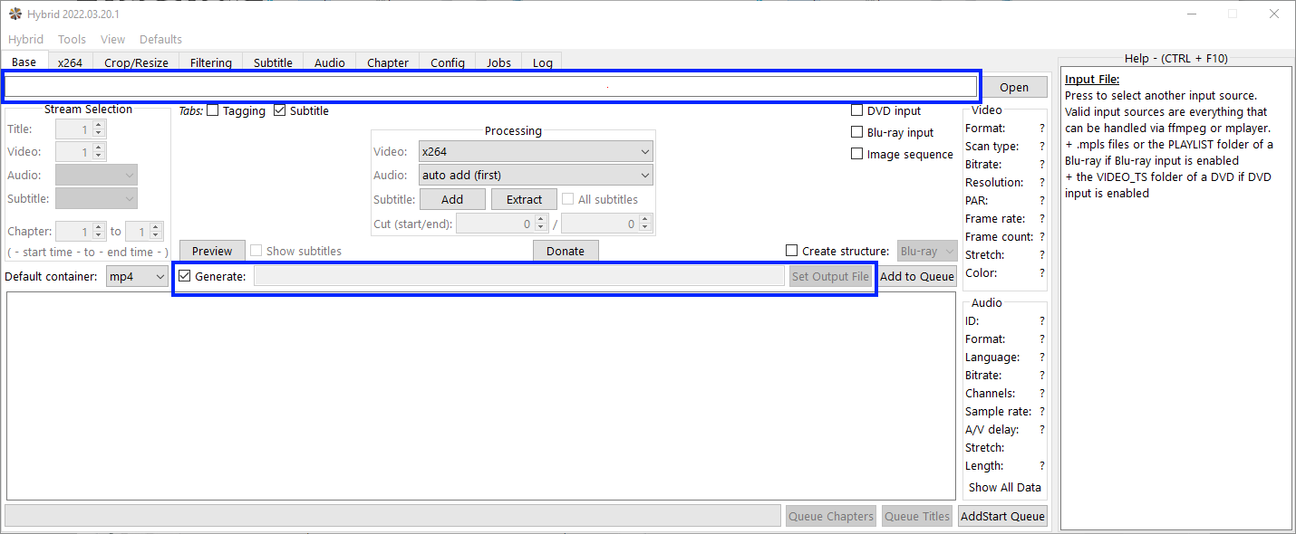

  2. Drag and drop your .avi source file onto the top blue field
    If you select "Generate" an output file location and file name is proposed in the output field, or you can specify it there by pressing the button right to it.
    The avisynth (or Vapoursynth) script will be generated according to your filters selection in Hybrid.

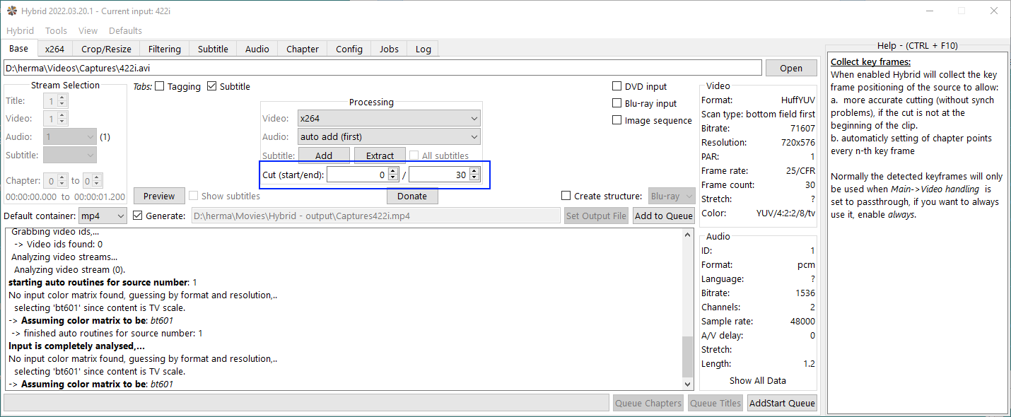

    Yeah thanks, but I got that far, adding INPUT + OUTPUT but for-the-life-of-me I cannot find WHERE I can specify an IN or OUT point of the chosen input-file. When creating a job, Hybrid offers me no chance to define in or out.
    Or am I completely missing some menu somewhere? The only thing I see that vaguely fits would be the greyed-out box upper-left: select stream/chapter/start-end-time which is only available for DVD/Bluray input.

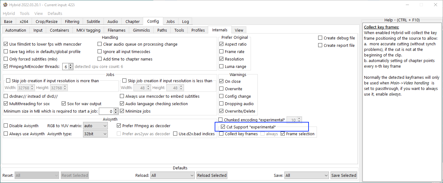

  4. Assuming I interprete this correctly you want to cut your input, to only encode a part of it.
    Hybrid has an experimental cutting support, which can be enabled through "Config->Internals->Cut Support *experimental*" (remember to read the tool tips) and is then available in the Base-tab. Setting cut start/end either through frame numbers or times, depending on your settings under"Config->Internals->Cut Support *experimental*".
    Hybrid does not allow multiple cuts.
    Cu Selur
  5. Originally Posted by Jan Tokki View Post
    .... for-the-life-of-me I cannot find WHERE I can specify an IN or OUT point of the chosen input-file......
    1. Config->Internals : Tick the 'Cut support *experimental*
    2. This will add 'Cut (start/end)' in the Base Tab
