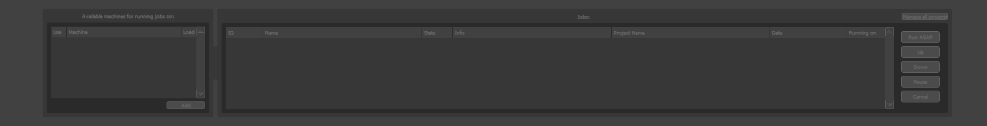

    I just got a new laptop and I cannot for the life of me figure out how to get PFClean to work on this new machine.
    It installs just fine but the problem is that the software doesn't see any available machines for running jobs on. Therefore I can't export any project I'm working on.
    Here's an image of what I see:
    [Attachment 66042 - Click to enlarge]

  2. I should also add, in case it's not obvious, that the "Add" button under "Available Machines" is grayed out so I can't manually add a machine using that method.

  7. Does anyone know what services PFClean is supposed to be running? Is "PFCleanNode" supposed to be running? I ask because if I double click the PFCleanNode exe file it says "PFCleanNode service is started automatically" but if I click "PFCleanNodeConfig" exe file it says "Failed to connect to PFCleanNode".
    If I open up Services.msc I cannot find a service named "PFCleanNode" there. Could it be that the PFCleanNode service is being prevented from running for some reason? Or are there different services that PFClean uses to communicate with my computer?
    I could be way off track here but I'm grasping at straws trying to figure out what's going on.
