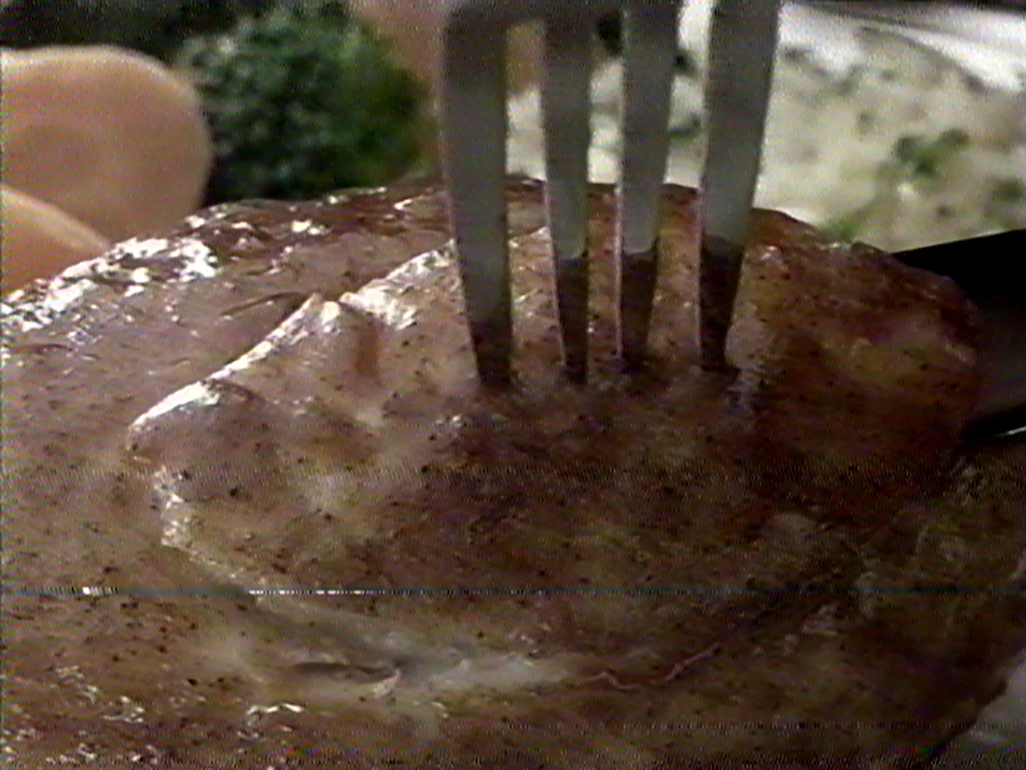

    The EDV-9500 is a great machine but the DOC on those is very ancient compared to modern VHS JVC machines, Take a look at this screen shot that I recently captured from a similar machine (EDV-7300) and look at the noise line due to tape drop outs, I don't know how it works but it certainly doesn't use neighboring lines like modern DOC's.
Name:	ED Beta III TV Commercials Vol. 2.jpg

    It even does not look like a regular drop-out… or it has been altered in a strange way, regular drop outs are thicker, and have a more random thickness over the length…
    there's also a random pattern bar just above that, there isn't a device that radiates RF interferrence ? like a Plasma screen ?

    RF drop outs range from a portion of line (in digital we call few pixels) to several lines, no not random. Yes de-interlacing may have altered its look little bit.
    The other noise patterns are interference noise, not sure how the tapes were recorded or from where they were recorded, I got those ED Beta tapes with the machine when I bought it. But it could be anything, bad TV transmission, RF appliance noise, bad and unshielded cables ...etc.
