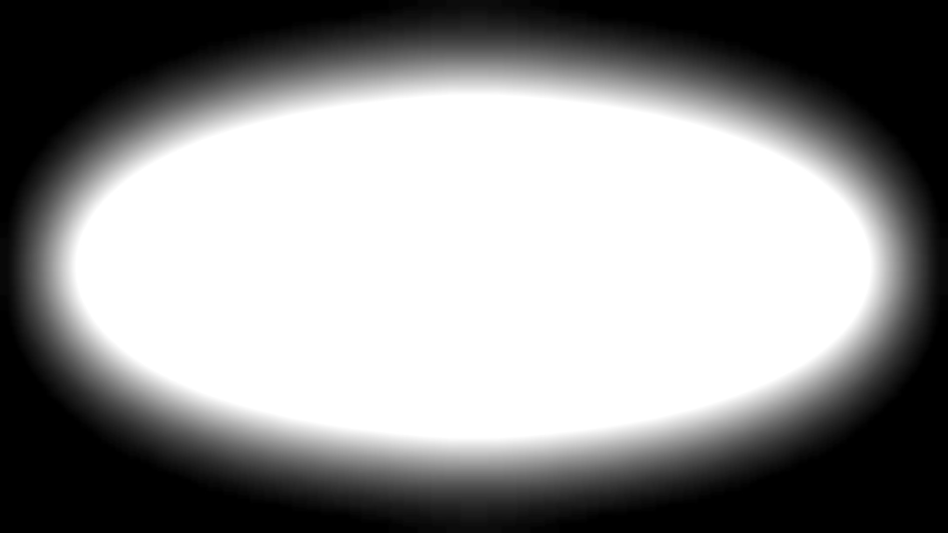

  5. I understand but for avisynth, does exist a more sofisticated tool than a simple blur? something that makes a more focused calculation, that acts only in the areas that most need anti twittering? Image
    [Attachment 65952 - Click to enlarge]
  6. Use a mask of horizontal edges to limit the blurring to only sharp high contrast edges.

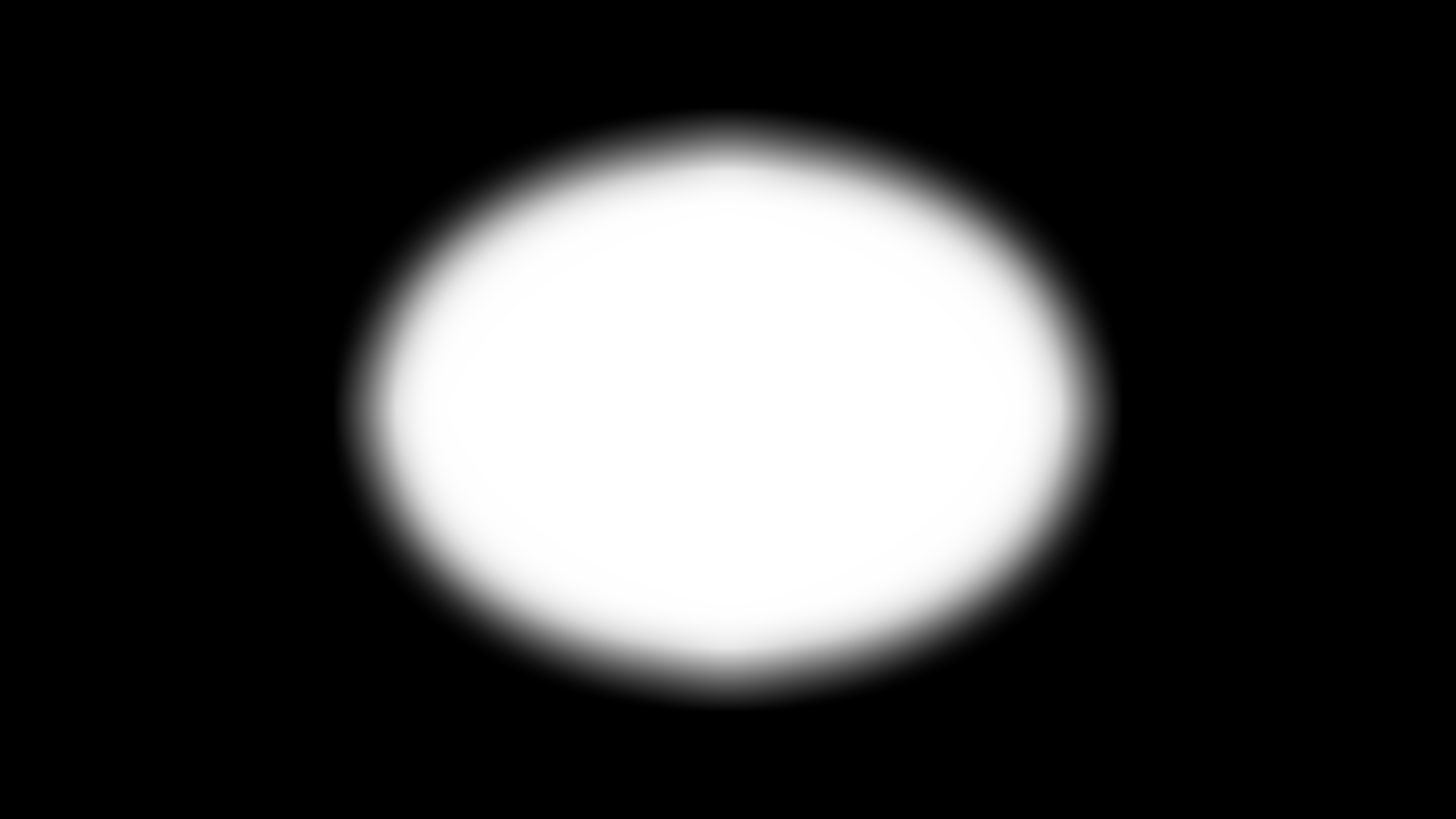

    please jagabo if there is not another methods to reduce the fliackering when interlace, consider your old help of using the blur function over a mask. But I need to extend the whithe area of keying like the red circle, and if possible with a more "shading":
    [Attachment 65999 - Click to enlarge]
    please can you do a new .jpg image that match this request? thank you

  11. Something like this?
    [Attachment 66000 - Click to enlarge]
    And regarding you interlace twitter, your video is oversharp to start with. If you downscaled from 4K use a less sharp resize. Precise Bilinear in VirtualDub (BilinearResize in AviSynth) is the most natural.

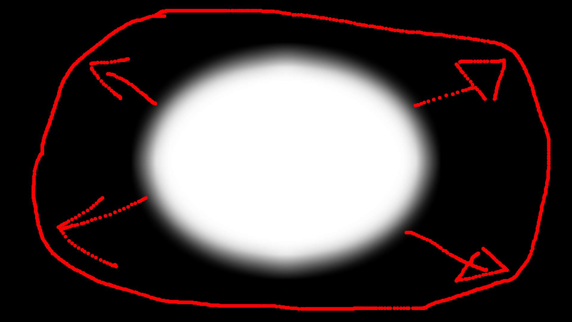

  12. Originally Posted by Skiller View Post
    I don't see how using a mask would be beneficial for this. Anything blurry enough not to cause the problem is barely made more blurry with the simple blur-sharpen combo I posted. You need to accept the limits of interlaced video or go progressive.
    [Attachment 66035 - Click to enlarge]
    mmm
    the attempt is to convert from progressive to interlaced, obtaining a result that is not too wrong. I know that the conversion from progressive to interlaced is a pig but I find myself in a situation where I quickly have to do an interlaced delivery without thinking about it too long and I try to make a batch that helps in doing this without distorting the final result too much, if possible

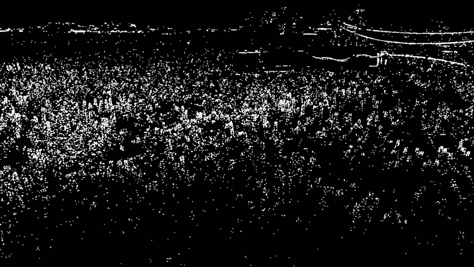

    mt_edge is pretty much all or nothing (per pixel):
    [Attachment 66043 - Click to enlarge]

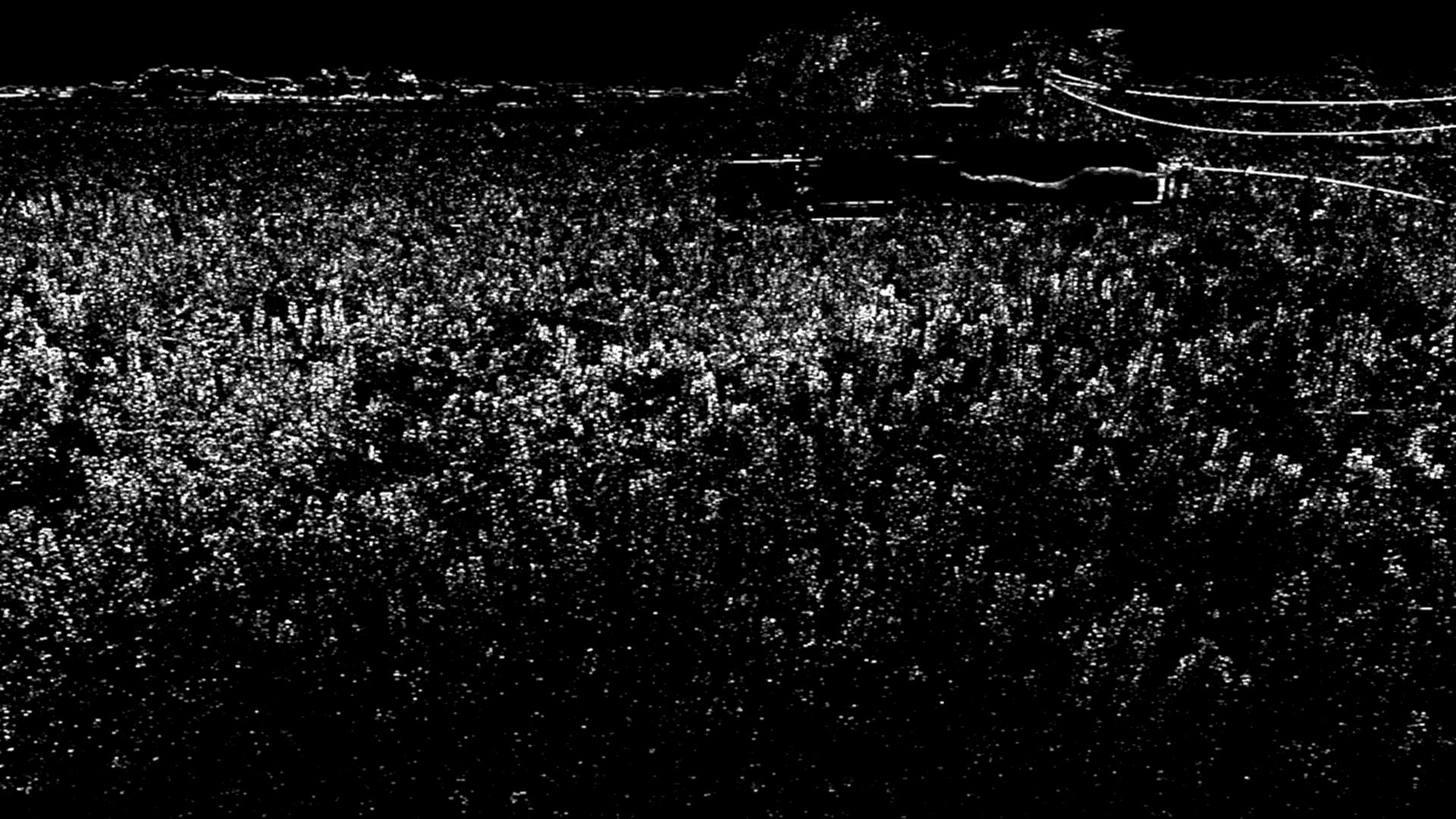

    where mt_convolution is more nuanced with different degrees of transparency per pixel:
    [Attachment 66044 - Click to enlarge]
