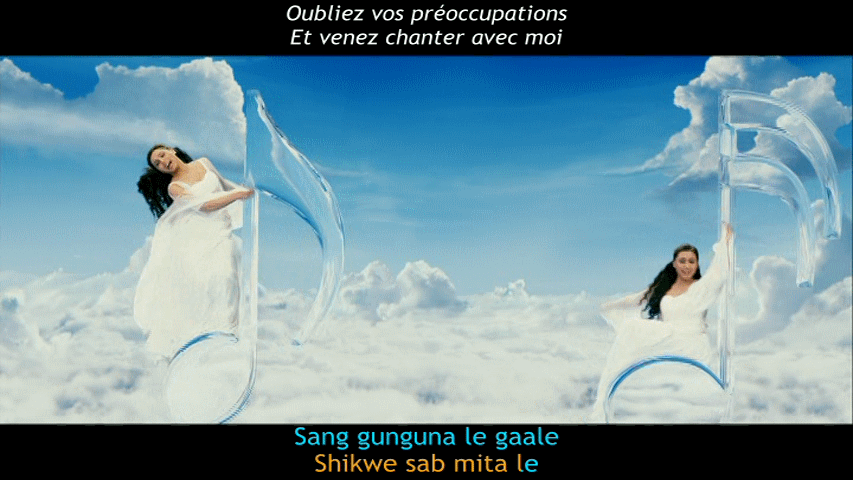

    First, why do I want to uncrop my files? This could appear silly, and a loss of time.
    Answer: I do want sentences to appear inside the black stripes, and not to overlap with the beautiful images (see Image1)

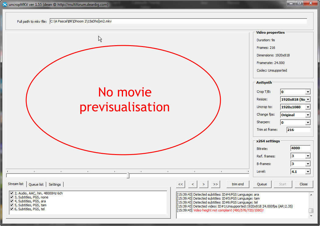

    Today I got a problem with the movie Dhoom_2.
    In the Image2, you will see that the movie does not appear in the middle of the uncropmkv window.
    [Attachment 65896 - Click to enlarge]

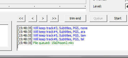

    As soon as I click upon "Queue", this knew window appears (Image3)
    [Attachment 65897 - Click to enlarge]

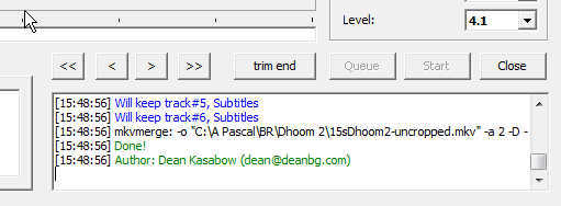

    Then I click on "Start", and instantly the job seems to be done, but actually it is not (Image4).
    [Attachment 65899 - Click to enlarge]
    You'll find the MediaInfo file attached.

  2. Member DB83's Avatar
    Jul 2007
    Just a guess but you will see the comment under properties in Image2 that the codec is unsupported. So my guess that it supports AVC (h264) but not HEVC (h265) and that is what your video was.
    No other solution but to convert from h265 to h264 (assuming, of course, that the video you now created in handbrake was indeed h264)
