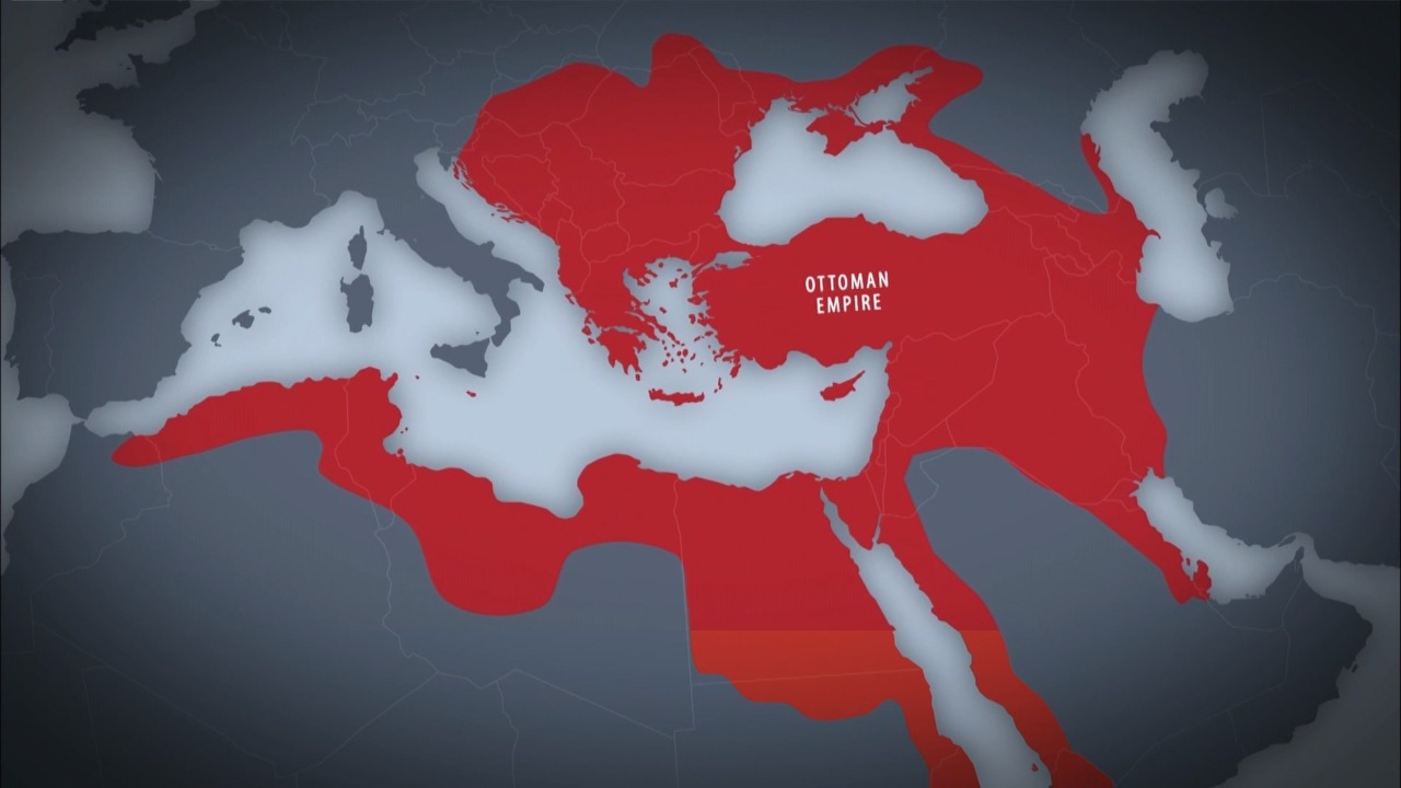

To avoid having to re-edit the PRORESes, I tried to merge them with the h264 converted files, cropping about 20% the bottom to erase the subs and keep the lower thirds. However, when I export using Adobe Media Encoder, I get a color shift and a crop line dividing the two assets (see how the red on the map is divided):

This is a colormatrix 709 vs. 601 mismatch.
To match it, you would either convert the prores shifting from 709 to 601; or the h264 from 601 to 709.
I would find out what the "proper" color is supposed to be and use that to guide your conversion. Or if you had colorbars on some of the clips it should tell you. My guess is the prores version is "correct", and the map colour should be more orange than red
One way would be to use a 601 to 709 LUT on the h264 MP4's in PP (as input LUT in lumetri color). I've attached 601 to 709 and 709 to 601. The original author is Adam Stanislav from the Creative Cow forum
Another way would be to batch convert one of the series in ffmpeg using zscale (e.g. the h264 clips from 601 to 709). If you need more info on this method, ask -
"170m" has the same values as "601" for matrix, so the zscale filter would look like
Code:-vf zscale=matrixin=170m:matrix=709
In this example, a folder of MP4's are batch re-encoded using x264 @ crf18 to (change the PATH to the destination folder you want) using a batch file. The output files also have "new" appended to the original filename (you can change it)
Code:for %%a in ("*.mp4") do ffmpeg -i %%a -vf zscale=matrixin=170m:matrix=709 -c:v libx264 -crf 18 -c:a copy "PATH\%%~na_new.mp4" pause
