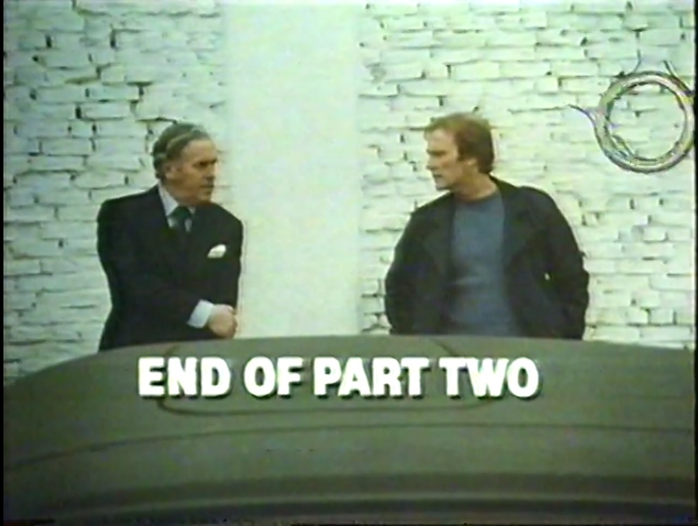

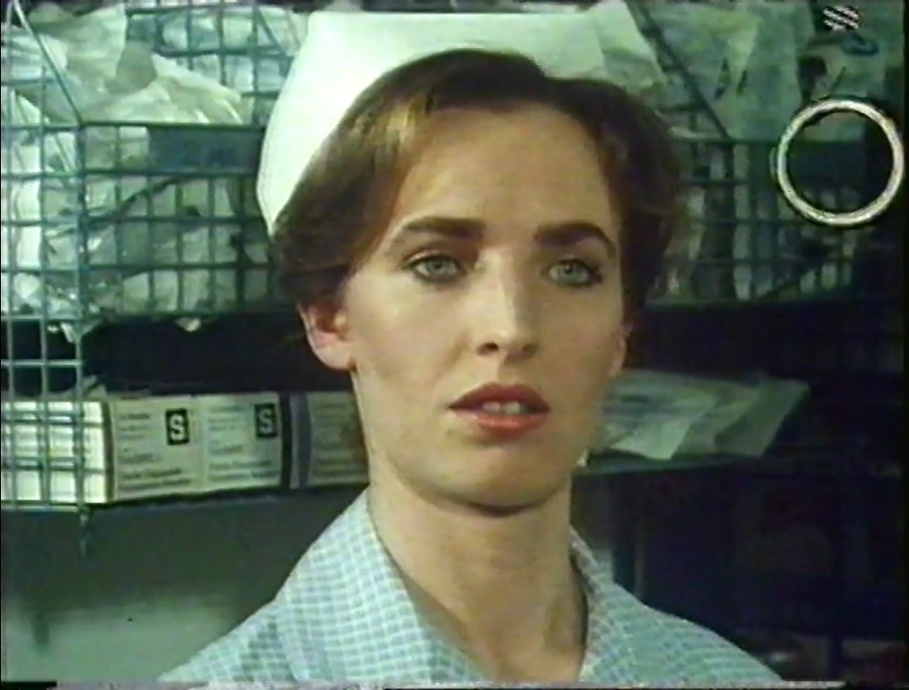

I was going through a few old recordings from the 80s which I taped onto Betamax from the TV (in the UK). I noticed on some of the films and TV series there often appeared those film reel scratches or blemishes and the circular ring effect that you often saw at the cinema or on old cine film, and these always appeared at the top right hand corner of the screen seconds before the cut to the next scene or just before the ad break. When I watched the DVD version or any recent TV broadcast the picture doesn't show anything like that. Does anyone know why some old broadcast had this? where they broadcasting the film or show from a projection or where they using a master tape?. Sorry if that doesn't explain much.

	Back in the day broadcasters have their own film copies to run in the telecine machine for broadcasting and the repeated runs wears out the film. But when archivists want to migrate the contents to a new format they often go for the master copy that has less wear and tear or use multiple copies and select the best scenes from them.

 This will explain what I mean. A repeat broadcast of an episode of Minder from August 1987. I've noticed this on films broadcast on TV from this time period also.Last edited by techmot; 13th Jul 2022 at 16:49.
	Thanks for that, I think you're right there, forgot to mention telecine. As you say they were probably using a worn copy of the film or programme rather than an archived prestine copy. It explains why alot of old shows and gameshows from the 70s and 80s that are shown on some of the freeview channels in the UK look like they were filmed yesterday, almost HD, likely they are using an immaculate copy and not the original tape or film.
	Unless I am mistaken, those were telecined from distribution/projection reels. That is the cue blip telling the projectionist to change reels. Doesn't occur on studio master reels.
	Also used in the UK to alert individual companies broadcasting a networked program that a commercial break or program change was about to happen so they could switch to regional commercial breaks. Not used these days because time codes are embedded in the data stream but in the old days the broadcaster had to watch for the markers to roll their advert tapes.

	Correct, my cousin pointed this out to me in the 70's. Been subconsciously aware of it since.
 Appearance
 Most cue marks appear as either a black circle (if the physical hole is punched out on the negative used to make the projection print of the film), or a white circle (if the mark is made by punching a hole or scraping the emulsion on the positive film print). They will also appear as an oval if the print is projected through an anamorphic lens.
 https://en.wikipedia.org/wiki/Cue_mark
 Edit:
 Other
 Cue dots in television
 In television, a similar idea is used to signal to a control room that a transition of some sort is about to occur on the broadcast (such as a commercial break). The most common type of television cue dot is the IBA style, used only in the United Kingdom, which consists of a small square in the top right corner of the screen, with black and white moving stripes. The other is a proprietary system used principally by the BBC (who do not air commercials). This version is a static square in the top left corner with a white-black-white pattern.
