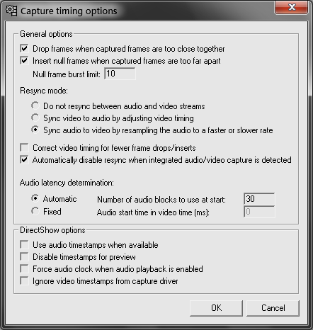

I used to have an ATI 600 PCI-e many years ago (sold it because it has weird AGC behavior which I found annoying btw), but the timing settings I used were almost the default:
[Attachment 66156 - Click to enlarge]
Didn't have sync issues with it, just the stupid and undefeatable AGC.
Also, for testing you can just capture off the Panasonic playing some DVD. Although I don't remember if the ATI 600 does mind Macrovision... -
Looked it up, they do not share the same driver, so indeed the two might not have the same chips on their boards.
But anyways, I don't see why these settings should not work alright for any capture device with integrated audio.
