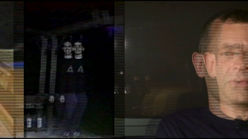

    I wanted to make an encode of this DVD I have so I used makemkv to make the segments on the DVD into mkv files. There seems to be one file that behaves differently than the rest. I see combing on the video and alot of it on very high motion scenes, it's weird because the other segments on the DVD dont have combing like this I will provide the mkv file makmkv made from the source DVD which I own. I wanted to deinterlace it plus encode to x256 for plex streaming but the combing is really severe even on the deinterlaced encode. I tried using xmediarecode and hybrid. The combing is mostly visible during transitions and high motion scenes. Also it doesnt happen on every scene just every so often. I was wondering if the material is telecined but I'm not sure how to tell, tried counting the frames but I feel like I'm doing that wrong.
    original source file [from DVD] = http://drive.google.com/file/d/1wsjlrg4yy3BNUt0aeonyv_9z9wZPs05j/view?usp=sharing
    Here are some pictures to show the combing I'm describing
    [Attachment 65835 - Click to enlarge]
  2. Some idiot resized video before autoring the DVD
  3. It was also hard telecined from 25p before the resizing. You could blur the two fields together and decimate back to 25p. That will nearly eliminate the combing (those frames will look like double exposures though) but you will lose some vertical resolution.
    Mpeg2Source("title_t02.d2v", Info=3)
    TFM(pp=0)
    BilinearResize(width, height/2).Spline36Resize(width,height)
    TDecimate(mode=2, rate=25.0) # or TDecimate(Cycle=6, CycleR=1) to get 24.975 fps
    It would also be possible to only blur the frames with residual combing after TFM. But that may be more jarring as some parts of the video would switch back and forth between sharp and blurry ever few frames.

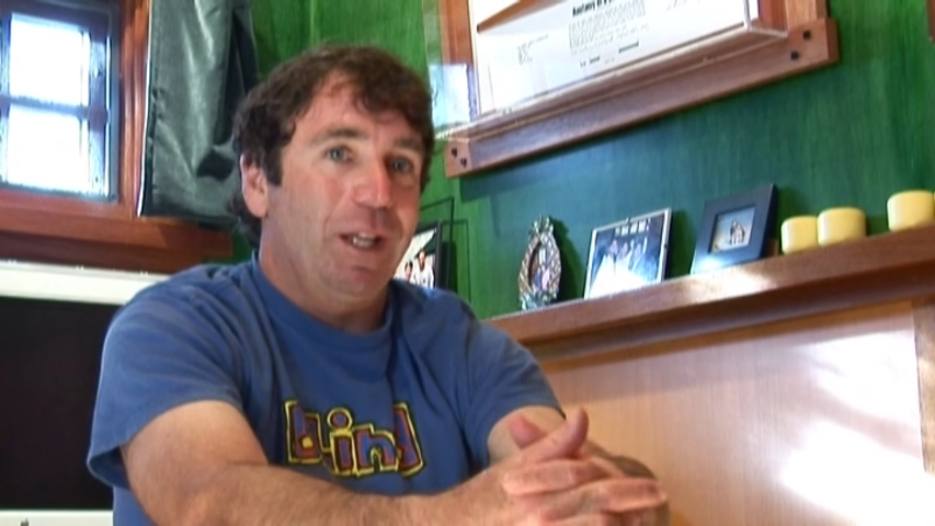

    Are you using any other filters because your output looks much more clear than mine, mine is a bit more blurred.
    yours
    [Attachment 65848 - Click to enlarge]
    mine
    [Attachment 65849 - Click to enlarge]
    Jul 2022
    Disregard that last post, didn't see the sharpen on the script itself, thank you so much jagabo! this thread can now be closed, problem solved on my end.

    Yes in the case of that script it is, I just meant in the first video you shared it seemed more clear vs my blurry one. If you run the sharpen plugin by it self it should clear up the image a bit, correct? Only for the 1st script. The second one is kinda jarring like you said due to the blurry and non blurry frames.
    Jul 2022
    Note that the Sharpen(0.0, 1.0) isn't sharpening the picture you see. It's sharpening the picture that's used to determine if there is any combing in the frame. The vertical sharpening enhances the combing making it easier for IsCombedIVTC() to detect it. If combing is detected the blurred frame is used, if not, the unblurred frame is used.
    In the 1st script you posted did you use any other filters than the one you shared? because I used that script but your output looks much more clear than mine, notice in the pic I sent you can make out the background objects easier the lines on them. On mine they look smeared and blurry.
  12. Originally Posted by unluckyfridays View Post
    I'm pretty sure the picture in post #7 is from my second script (post #5). Note that the video sample I uploaded has the same name as the sample in my first reply (post #3). Both samples were made from their respective scripts.
