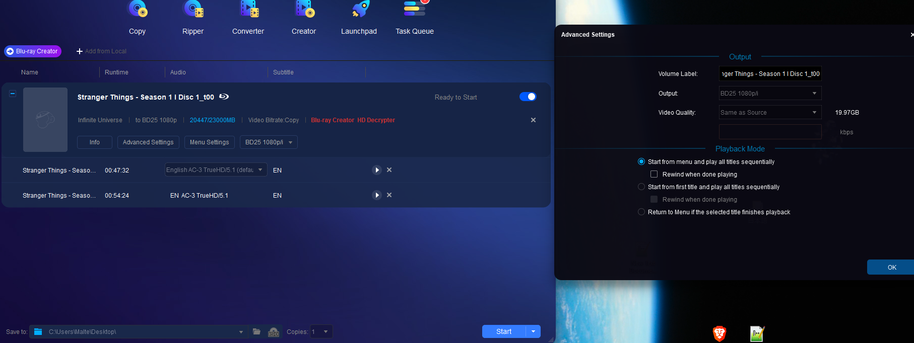

  7. Okay, I tried again with dvdfab and multiavchd with a few episodes of stranger things I ripped with makemkv, but multiavchd kept crashing and dvdfab re-encoded them ( Also I checked and the video track is AVC
    Do you have any recommendations for other software?
    These are the settigns I used with dvdfab:

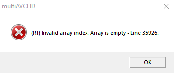

  9. It doesn't work I keep getting an error and multiAVCHD crashes: (RT) Invalid array index. Array is empty - Line 35926.

  11. Originally Posted by maltersxd View Post
    Look, try this:
    First try: install multiavchd in a new folder (or uninstall and reinstall if it isn't a problem losing your custom settings) and try to get what you want without changing the original settings, a basic project with default settings, to understand if the problem for your files is YOUR settings or the software itself.
    Second try: if the problem is not solved, try using the softwares I told you in the previous post and then multiavchd for a different result.

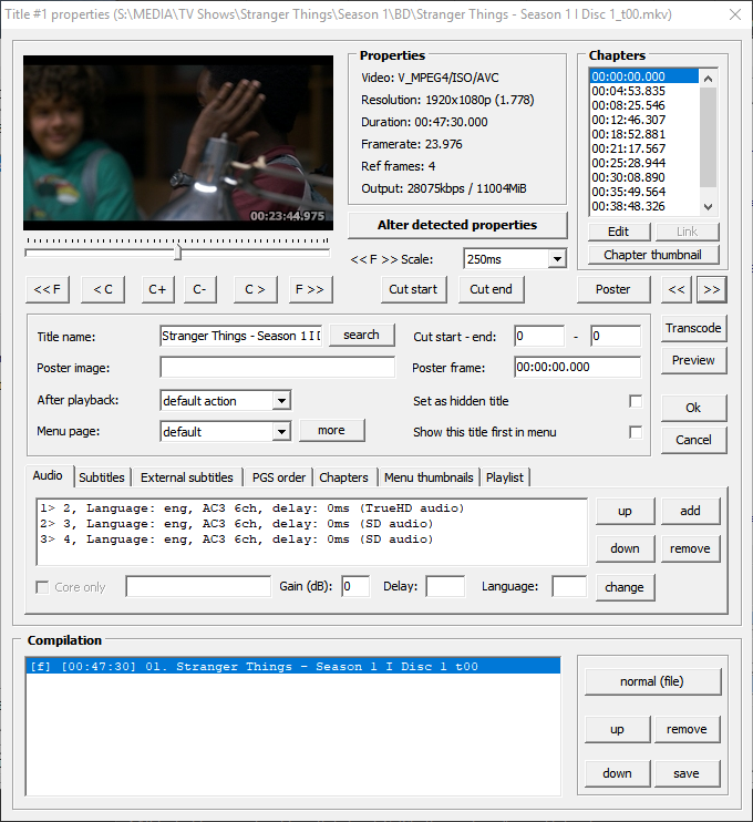

    Anyway, I did a multiavchd test using three .mkv video files and Multiavchd had no problem creating an avchd structure.
    For video file information:
    Video: h264 (High), yuv420p(tv, bt709, progressive), 1920x1080 [SAR 1:1 DAR 16:9], Closed Captions, 25 fps, 25 tbr, 1k tbn
    Audio: ac3, 48000 Hz, 5.1(side), fltp, 384 kb/s
    Subtitle: subrip
    Now, the question is: in multiavchd, in the "Author" section, did you select PAL or NTSC for your video files? And in "Menu", for the menu type, did you select static or motion? Because these details could make a difference for the copying of video and audio for a different fps or for some problem for the software in the creation of the menu. For my test I used the static menu with the Pal TV system, selected AVCHD (strict) as the target media and had no problems creating an AVCHD.

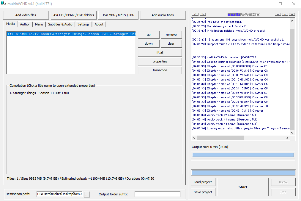

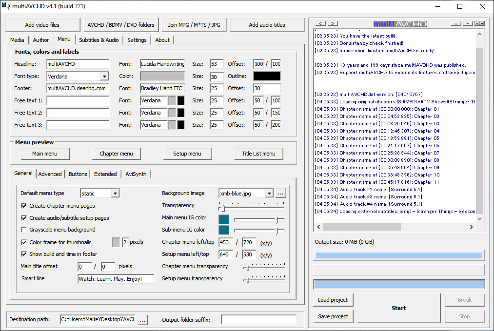

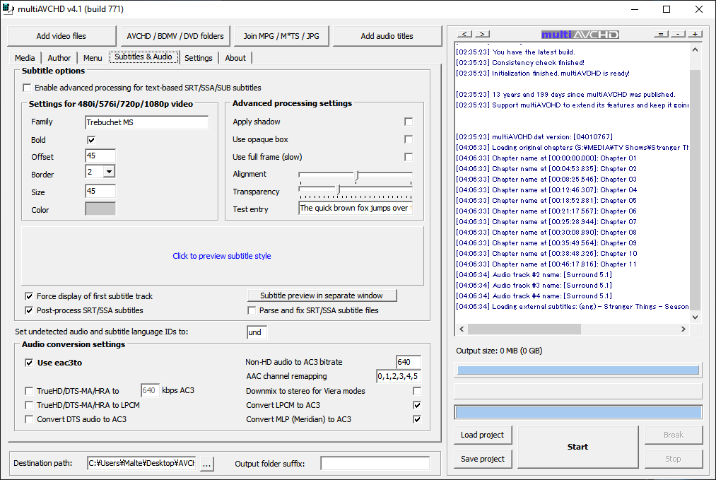

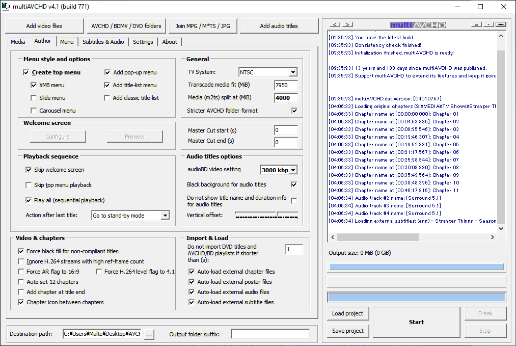

  16. So I couldnt get UsEac3to to work, it just throws me an error saying: The format of the source file could not be detected :/. I tried looking for a solution but the solution was using delaycut but it only accepts mkv files etc.. :/
    I installed both java 64 and 32 and started the program in admin. I'm using NTSC in the settings since the blu ray is from the us.

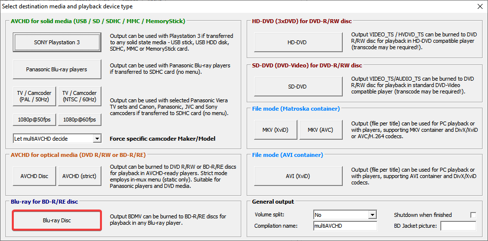

    These are all my settings with the first episode of stanger things straight from makemkv,
    https://forum.videohelp.com/images/imgfiles/7Tfy9aK.png https://forum.videohelp.com/images/imgfiles/dBc0rIK.png https://forum.videohelp.com/images/imgfiles/vOCdpVm.png https://forum.videohelp.com/images/imgfiles/Uh6Zk3P.png https://forum.videohelp.com/images/imgfiles/xaqwT1o.png https://forum.videohelp.com/images/imgfiles/6feLpd4.png https://forum.videohelp.com/images/imgfiles/DdKYoW5.png

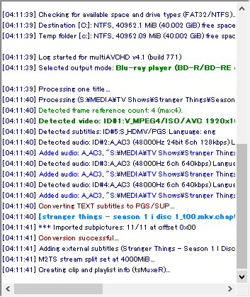

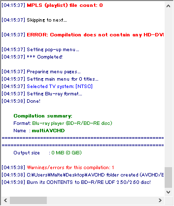

    This is what the log shows right as I press start, https://forum.videohelp.com/images/imgfiles/ZtLLO9R.png
    Then after a few minutes it shows this, https://forum.videohelp.com/images/imgfiles/8uRNS8j.png and I get this, https://forum.videohelp.com/images/imgfiles/zm7rkLD.png error then the program crashes....
    Compilation does not contain any hd-dvd? Weird mistake for Blu-ray profile... You didn't choose hd-dvd I suppose. However try deselecting the pop-up menu and title list menu as well for a simpler thing for the software. And select AVCHD (strict) as the profile, not Blu-ray disc.
