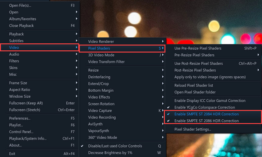

    Right click ⇨ Video ⇨ Pixel Shaders ⇨ Enable SMPTE ST 2084/2086 HDR Correction
    [Attachment 65804 - Click to enlarge]
  5. Originally Posted by JKyle View Post
    I already had those enabled.

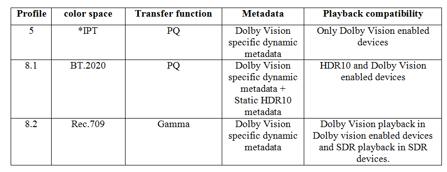

    Not all HDR videos are playable on PC. If your video is Dolby Vision with Profile 5, it cannot be played properly on open source players like mpv, mpc, PotPlayer, etc. Only Dolby Vision enabled devices can deal with it properly.
    [Attachment 65809 - Click to enlarge]
    Check it out with MediaInfo.
  10. Originally Posted by JKyle View Post
    It's standard HDR10.
