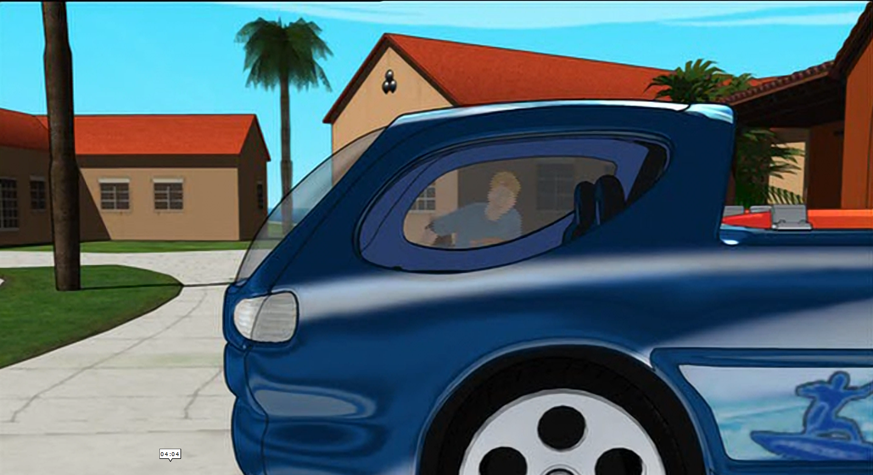

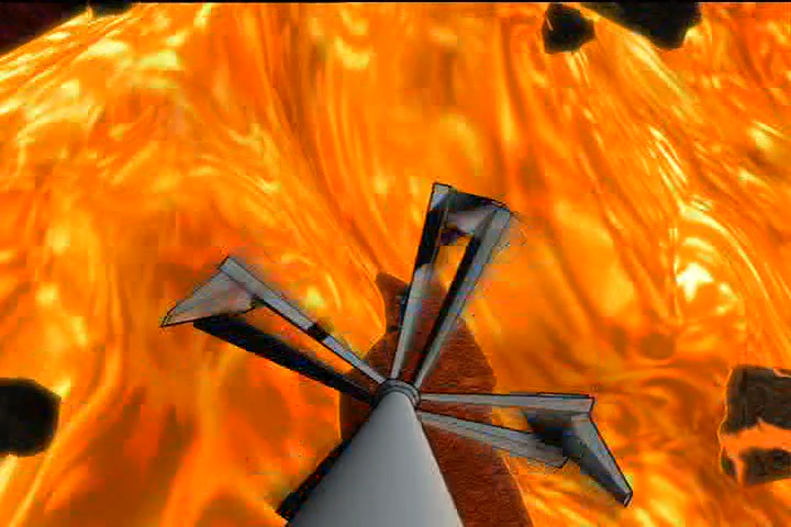

  9. Something I noticed with the de-telecining using TFM in Avisynth+, every couple of frames you'll get a "detelecined" frame with very obvious zig zagging on moving objects that used to be telescined (look at his body and head in the window).
    [Attachment 66048 - Click to enlarge]
    But, when playing the original video back through VLC player and using its automatic de-telescine feature, yes it adds extra frames, but the de-telescined frames do not have the same zig zagging issues as AVisnyth+
    [Attachment 66049 - Click to enlarge]
    How can I get rid of that on avisynth?

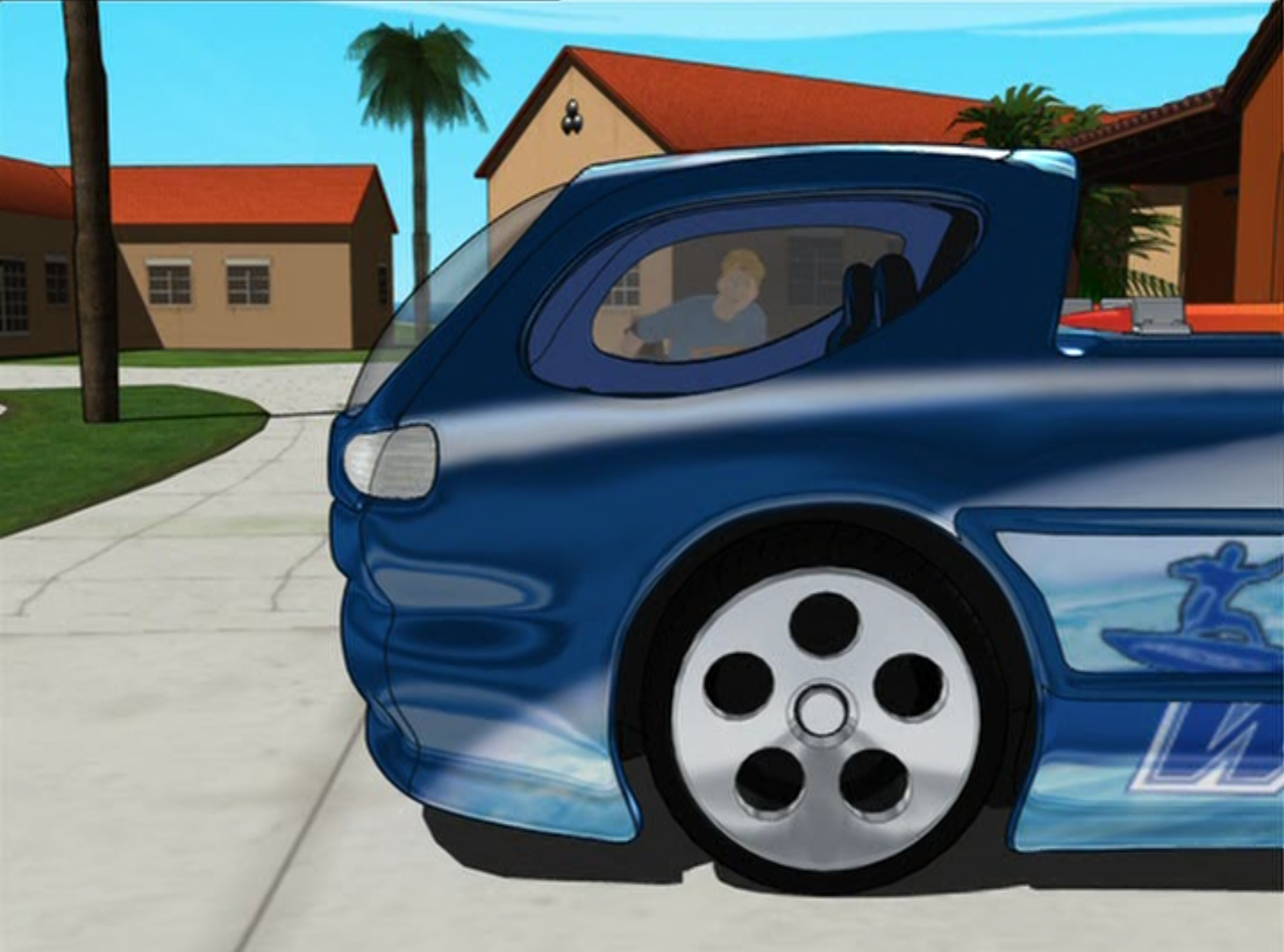

  29. Using your script (minus the colormatrix and deblocking calls) I get this as frame 28665:
    [Attachment 66187 - Click to enlarge]
    Is that the frame you're talking about? When I encode the VOB with VLC I get an blend deinterlaced frame there.
    Another thought: TFM matches fields. If one has more artifacts it will still use it. VLC uses a deinterlacer so it might not use the bad field (or may use only the bad field at times).

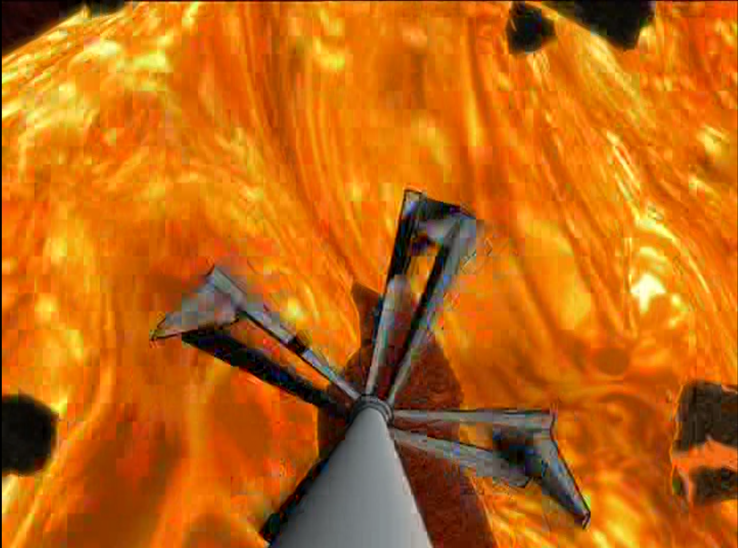

  30. Yep, just to be clear here is what I'm talking about.
    The image below is my output from Avisynth. You can see alot of, I guess you could call it chroma telecining, where the colors (in the lava for example) shift between red and green in horizontal lines.
    [Attachment 66188 - Click to enlarge]

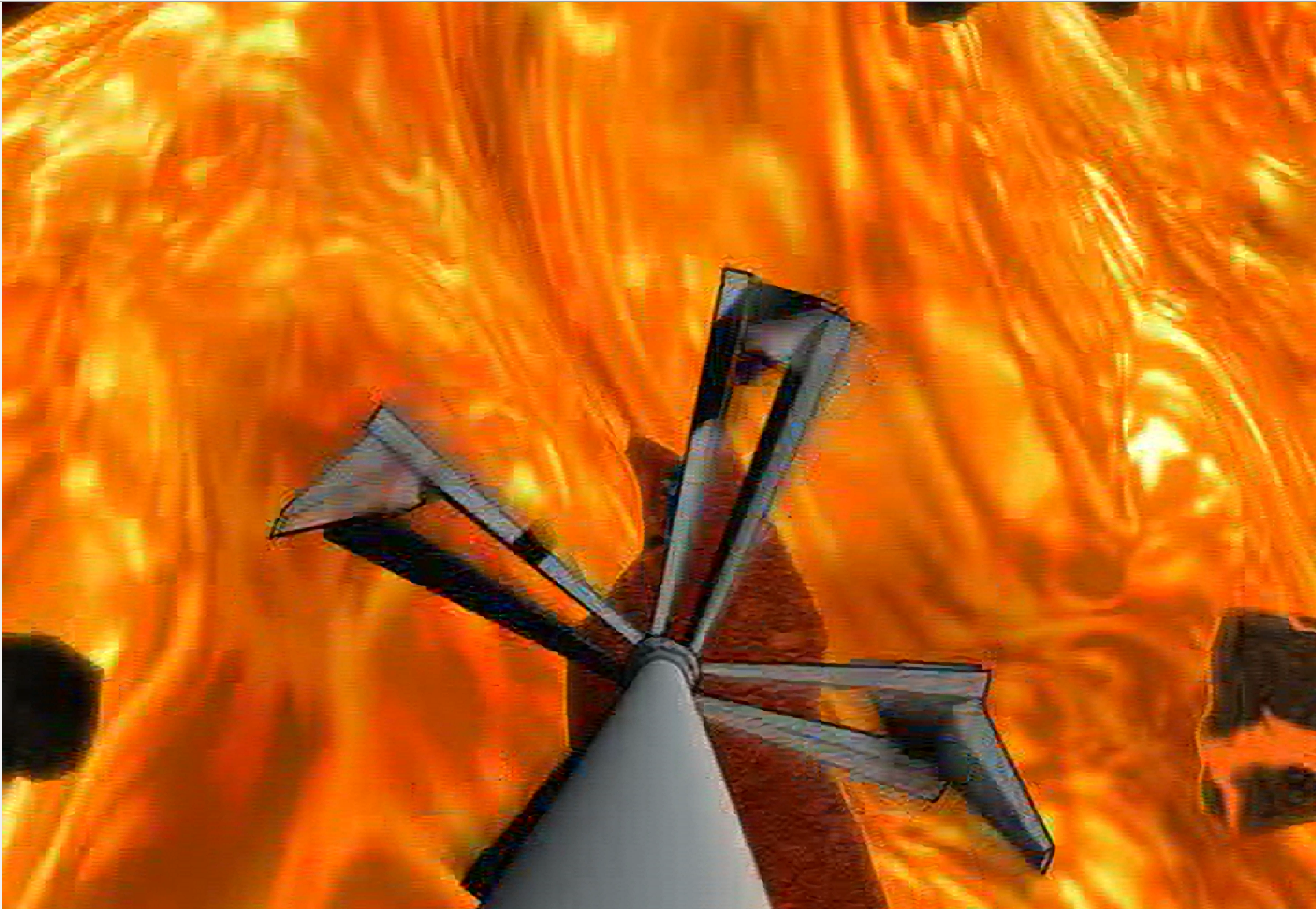

    Now, for the same frame, when using VLC's automatic de-interlace mode, I get 2 duplicate frames here. The first one, shown below, is absolutely terrible quality.
    [Attachment 66189 - Click to enlarge]
    But the second duplicate frame, shown below, seems to be the same one that Avisynth produces, but without the "chroma" telescining, so it ends up looking cleaner.
    [Attachment 66190 - Click to enlarge]
    I want the output from Avisynth to be the same as the second duplicate frame from VLC (the last image in the post), and eliminate that residual "chroma" telescining, because it comes out looking alot better after upscaling in VEAI.
