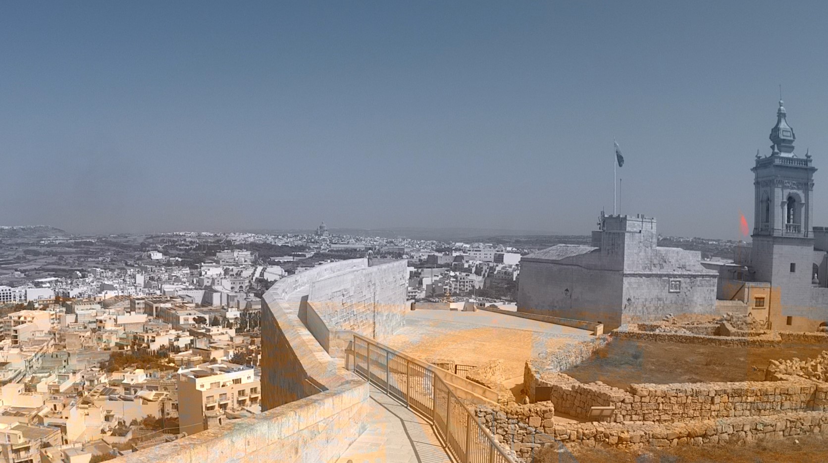

    I'm searching for some guidance, and hoped there would be someone in the forums that had seen this type of issue before.. here is a frame grab from some recent footage. All seems to be the same.
    I seem to have an issue with my action camera. The colour channels seem to be mis aligned, causing visual ghosting and unusable footage. Does anyone know if this is a hardware issue or a codec/software issue, and can it be fixed using Adobe or DaVinci resolve?
    thanks in anticipation

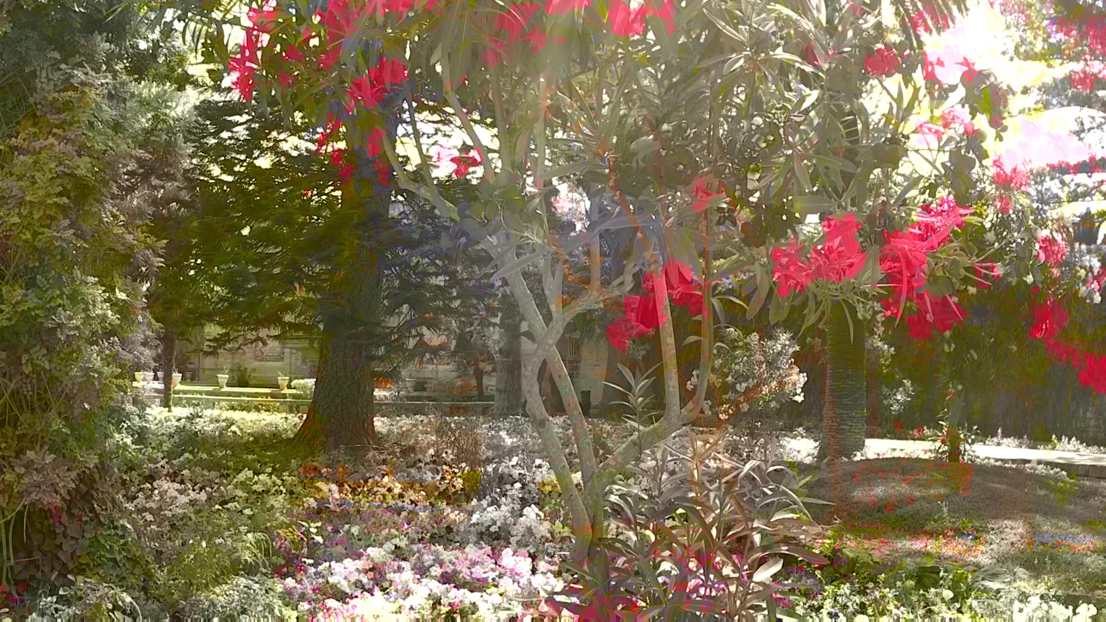

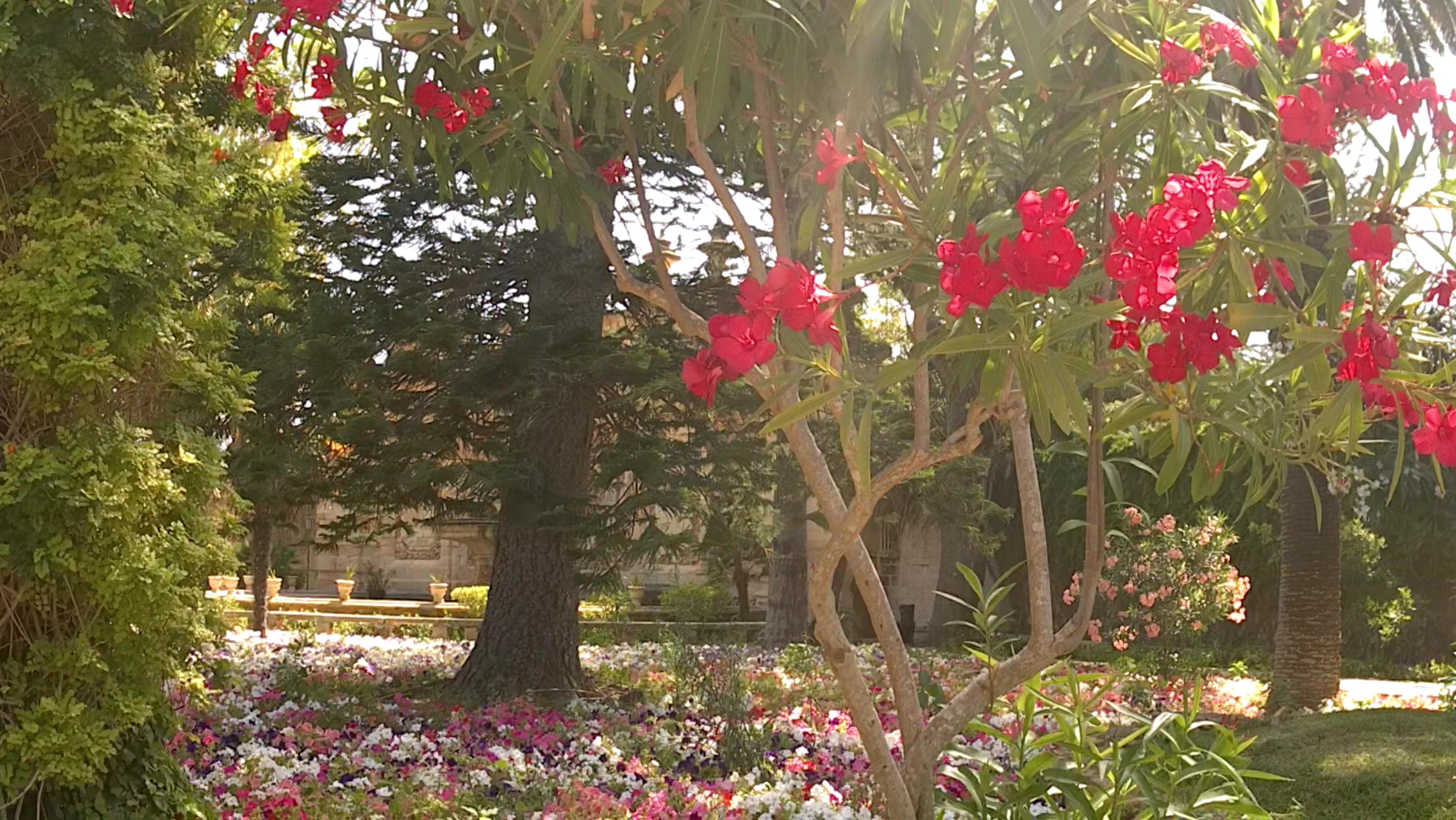

  4. There does indeed appear to be a problem with the 0094 clip. And it is as simple as the chroma channels being shifted right and down. You can fix that by shifting the chroma left and up but there's no easy way to get the correct chroma for the right and bottom edges.
    source frame:
    [Attachment 65810 - Click to enlarge]
    after shifting chroma:
    [Attachment 65811 - Click to enlarge]
    Since there aren't any correct colors for the right and bottom edges you could just crop them away:
    [Attachment 65812 - Click to enlarge]

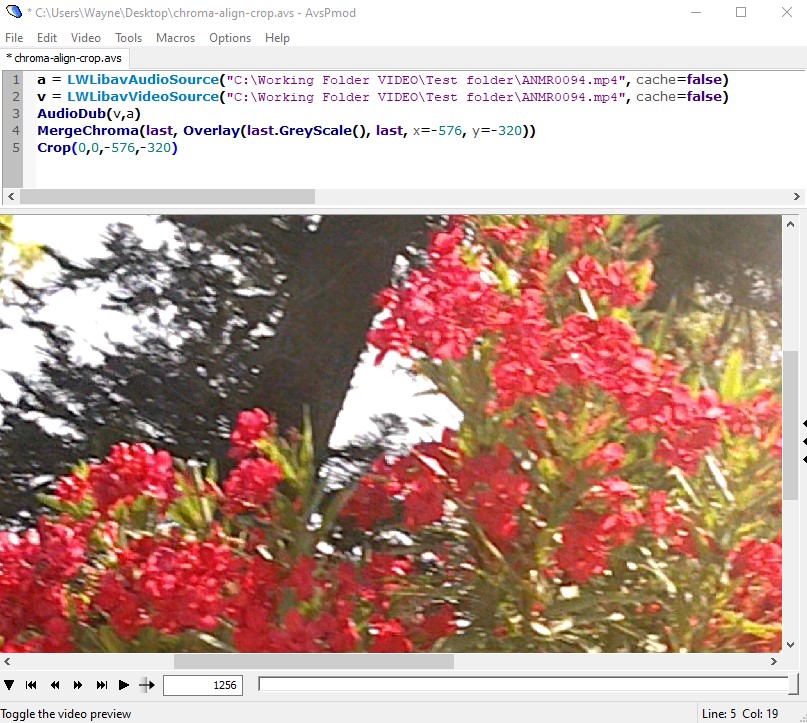

  13. The code in AvsPmod seems to work
    a = LWLibavAudioSource("C:\Working Folder VIDEO\Test folder\ANMR0094.mp4", cache=false)
    v = LWLibavVideoSource("C:\Working Folder VIDEO\Test folder\ANMR0094.mp4", cache=false)
    AudioDub(v,a)
    MergeChroma(last, Overlay(last.GreyScale(), last, x=-576, y=-320))
    Crop(0,0,-576,-320)
    In the preview it aligns chroma and luma channels and crops.... is this correct? Am I just testing the script before I put it into action? Do I run this script in something else? Sorry to be a klutz, but I'm new to this, and have only worked in Premiere Pro, and I'm no expert in that.
    [Attachment 65847 - Click to enlarge]
    Thank you for your patience.
    Yes. If you don't want to crop you can remove the last line. Or disable it by putting a # at the start of the line. If you want to leave the misaligned colors at the bottom and right edges you can remove the ".GreyScale()", leaving the "last". If you want to crop but restore the original frame size add Spline36Resize(3840, 2160) at the end of the script.
