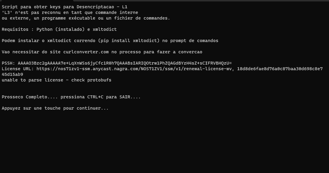

  11. Hi everyone, I have the same problem, can anyone help me? tanck
    [Attachment 74555 - Click to enlarge]
  12. wrong header
    share here pssh only
  13. Thank you in advance for your help
    I think it must also be the headers
    AAAAO3Bzc2gAAAAA7e+LqXnWSs6jyCfc1R0h7QAAABsIARIQOt rw1PhZQAGdBYzH4sZ+sCIFRVBHQzU=
  14. The "check protobufs" error message is somewhat misleading. The reason for the error message is, that the license query did not return a result, that was parsable as valid license result (unable to parse into the protobuf structure for what is expected as result).
    The usual reason is missing or wrong headers or wrong arguments for the license request.

    json_data = {
    'challenge': 'EkkSPRo7CjQKEFLeKYtz5B3ZXx/ohZe1eGQSEFLeKYtz5B3ZXx/ohZe1eGQaACABKAQ4AEAASK746qkGENoLGAAYAiCKhOupBjAVG iD3/CJAz8GSiqP5SYkmeuD7felzDDM+ejwMFOnFJ3kgDg==',
  18. in headers use only 'nv-authorizations' value
    but you have also json_data and so need custom script for your site

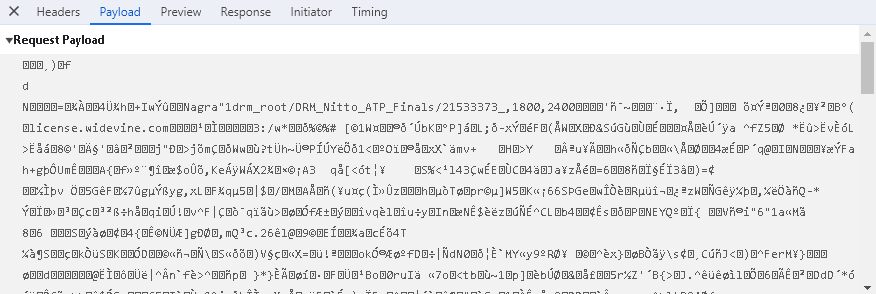

  25. Dear Friends,
    so far I've successfully let WKS-KEYS handle both "standard" licence requests, and "less standard/JSON" licence requests adopting NBA456017's script mod, though here I have a special case that stucks me and I really wish to hear your ideas about:
    It's a free to view tennis event streamed by raiplay.it
    MPD:
    PSSH:
    AAAAbnBzc2gAAAAA7e+LqXnWSs6jyCfc1R0h7QAAAE4IARIQPRm+wJ0DNNy+aAYrSXfd+xoFTmFncmEiMWRybV9yb290L0RSTV9OaXR0b19BVFBfRmluYWxzLzIxNTMzMzczXywxODAwLDI0MDA=
    License URL:
    Request Headers:
    User-Agent: Mozilla/5.0 (Windows NT 10.0; Win64; x64; rv:109.0) Gecko/20100101 Firefox/115.0
    Accept: */*
    Accept-Language: it-IT,it;q=0.8,en-US;q=0.5,en;q=0.3
    Accept-Encoding: gzip, deflate, br
    Referer: https://www.raiplay.it/
    nv-authorizations: eyJhbGciOiJIUzI1NiIsImtpZCI6IjE5MDEwIiwidHlwIjoiSldUIn0.eyJ2ZXIiOiIxLjAiLCJ0eXAiOiJDb250ZW50QXV0aFoiLCJleHAiOjE3MDAyMTcwNDIsImNvbnRlbnRSaWdodHMiOlt7ImNvbnRlbnRJZCI6ImRybV9yb290L0RSTV9OaXR0b19BVFBfRmluYWxzLzIxNTMzMzczXywxODAwLDI0MDAiLCJzdG9yYWJsZSI6ZmFsc2V9XX0.yxiwTrY8Lp6otoUkqjOU6Jof-OPcpyuzUU6kXtwfN6g
    Content-Length: 5462
    Origin: https://www.raiplay.it
    Connection: keep-alive
    Sec-Fetch-Dest: empty
    Sec-Fetch-Mode: cors
    Sec-Fetch-Site: cross-site
    TE: trailers
    [Attachment 74915 - Click to enlarge]
    Request POST payload (5462 bytes) here attached does NOT look JSON data, I can just recognize some text as "Nagra"1drm_root/DRM_Nitto_ATP_Finals/21533373_,1800,2400" and "license.widevine.com" so I'm stucked here (unable to parse license - check protobufs).
    Is anyone able to collect keys for this content? Thank you for any possible hint you may reply.

    The token has expired. Can you provide a new one (or the video link) ?

  30. *** SOLVED ***
    for those interested in my same issue, it turned out that WKS-KEYS standard script in this "special case" failed for 2 crucial reasons:
    1) 'nv-authorizations' token must be provided to the license server by the request headers WITHOUT double quotes! (incredibly it will be discarded if quoted)
    2) as most tokens, 'nv-authorizations' is (very!) time limited and single use, therefore it should be provided about real-time just after it is received
    adapting WKS-KEYS standard script to 1) and 2) it WORKS PERFECTLY even by a local L3 (V)CDM!
    Greetings to this amazing community and special thanks to iamghost
