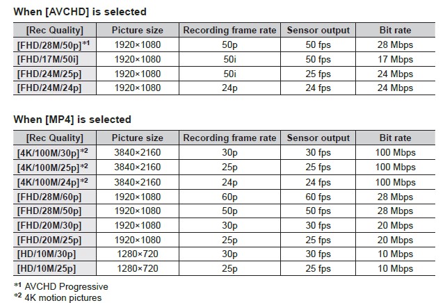

  8. My camera can capture at the following:
    [Attachment 65808 - Click to enlarge]
    I have been using MP4 60 fps and after I edit multiple files in Vegas, Render as MP4
    I had on times changed to 25p as some said as I'm in PAL region I should.
    Also read that FB uses 29.97 frame rate no matter what you upload.
    Sure is a lot of conflicting info out there.

    Got it. "Shoot" rather than "capture". In that case, I'd just use the source file's frame rate and bit rates (off Mediainfo).
    The only limiting value for bitrate will be how long it takes to upload to YT, so you may need to lower the bitrate of those 100mb/sec files to something that gives you a manageable file size. Remember that YT will encode multiple file quality/sizes, but if you are sending to family, depending on how you are doing it, you might have to drop the bit rate/file size down.
    Re frame rates generally, any decent media player such as a TV, computer or phone will play any framerate you give it. DVDs had framerate rules, depending on what type it was (PAL/NTSC) but for normal files such as MP4s, no such restrictions exist. It's better to use source file's frame rate IMO.

  11. I will try 50 vs 59.94 at Full HD and compare results
    As a test I did Full HD at 59.94 and a 4k at 59.9a (and pushed up video rate)
    On playback the Full Hd was smooth and clear, while the 4k was jittery .... maybe the plyer (Splash) has issue with high Bitrate.

    Your camera is not recording at 60fps at 4k.
    And if you convert the material recorded in 30fps to 60fps, it will not be smoother. Or it could be worse.
