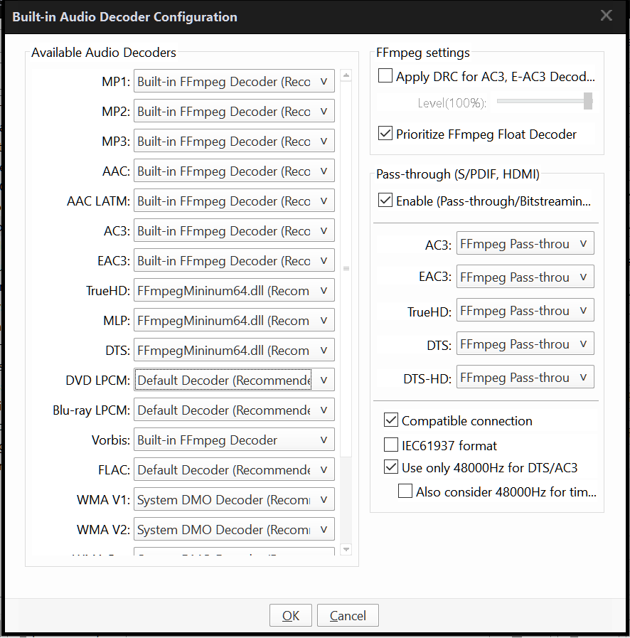

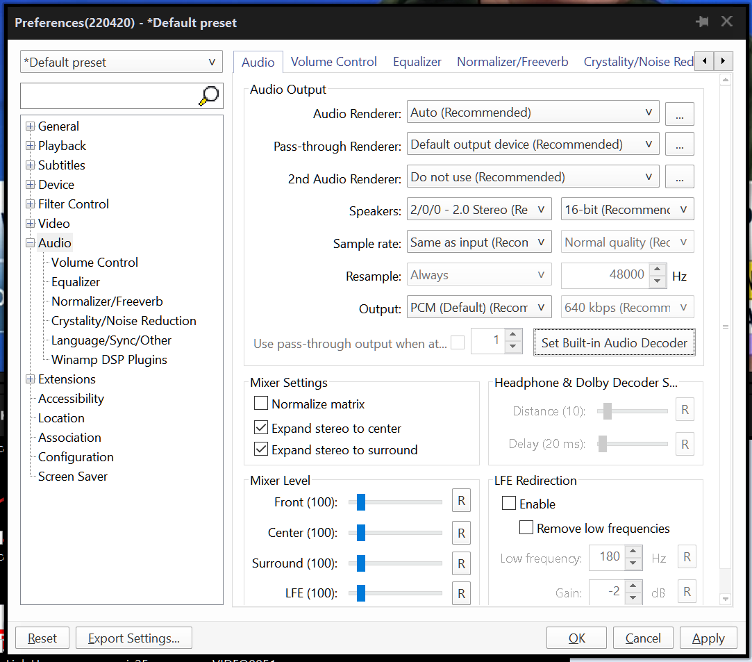

Hi Gus;
Thank you for helping me;
Im have cable tv tuner connected via hdmi cable.
i tried different configurations but no luck
At the moment it looks like this:
[Attachment 65796 - Click to enlarge]
[Attachment 65797 - Click to enlarge]

You probably have to manually select the Audio Renderer, the Pass through renderer, and 2nd Audio renderer. Do you have 2 different devices outputting audio to your monitor or speakers?
