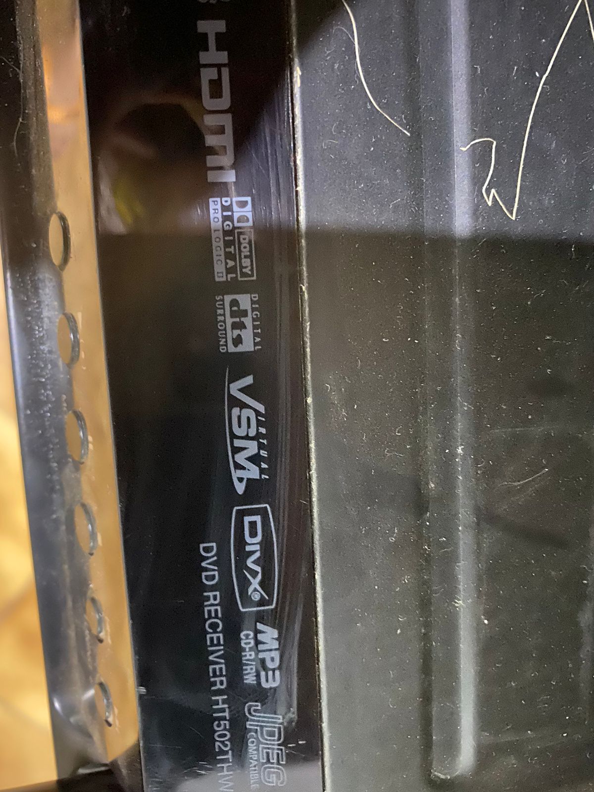

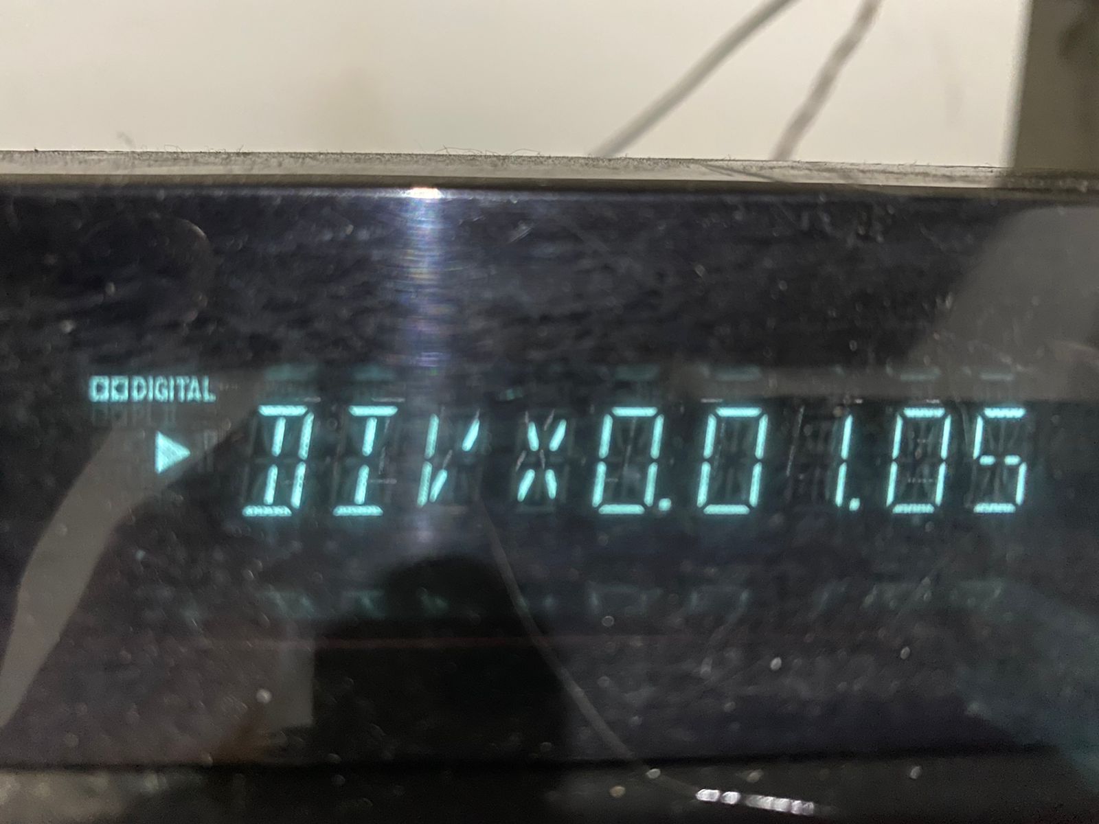

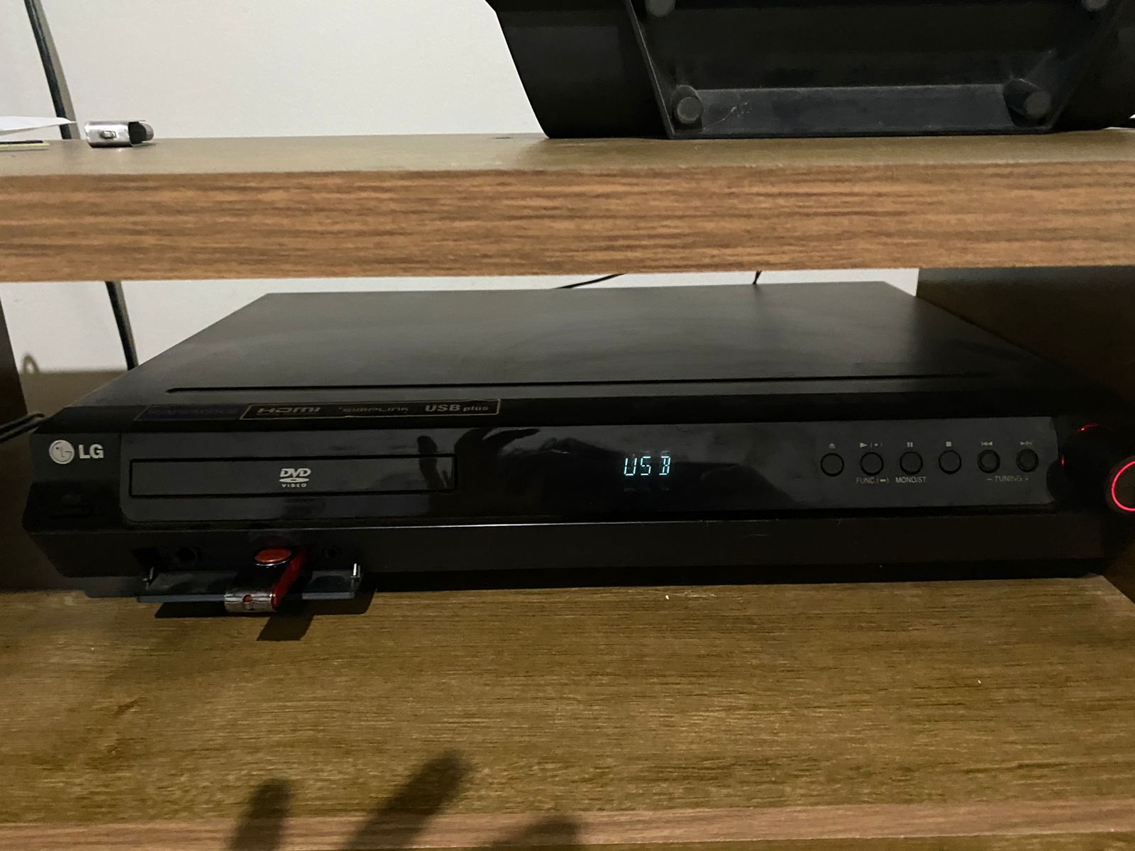

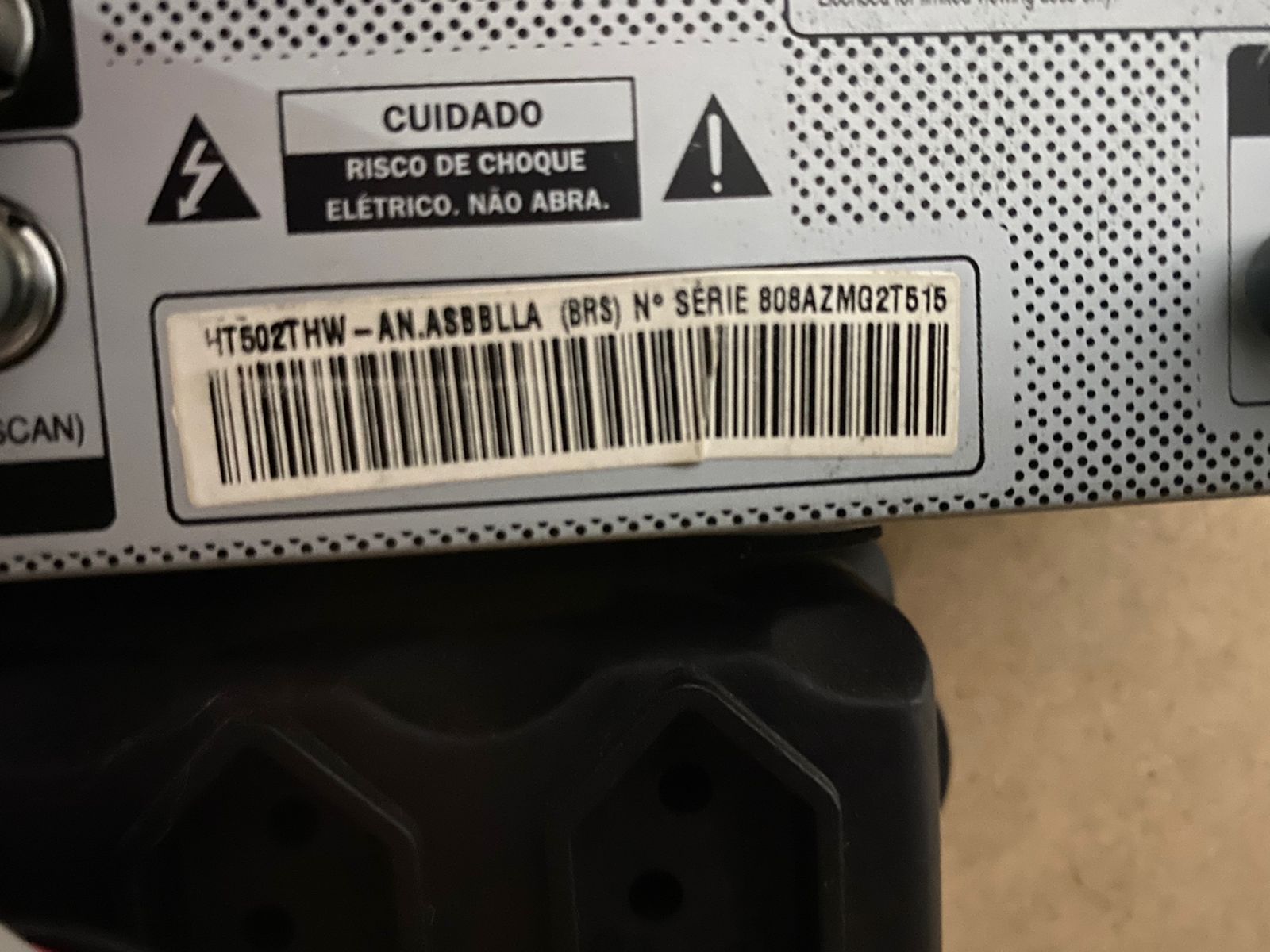

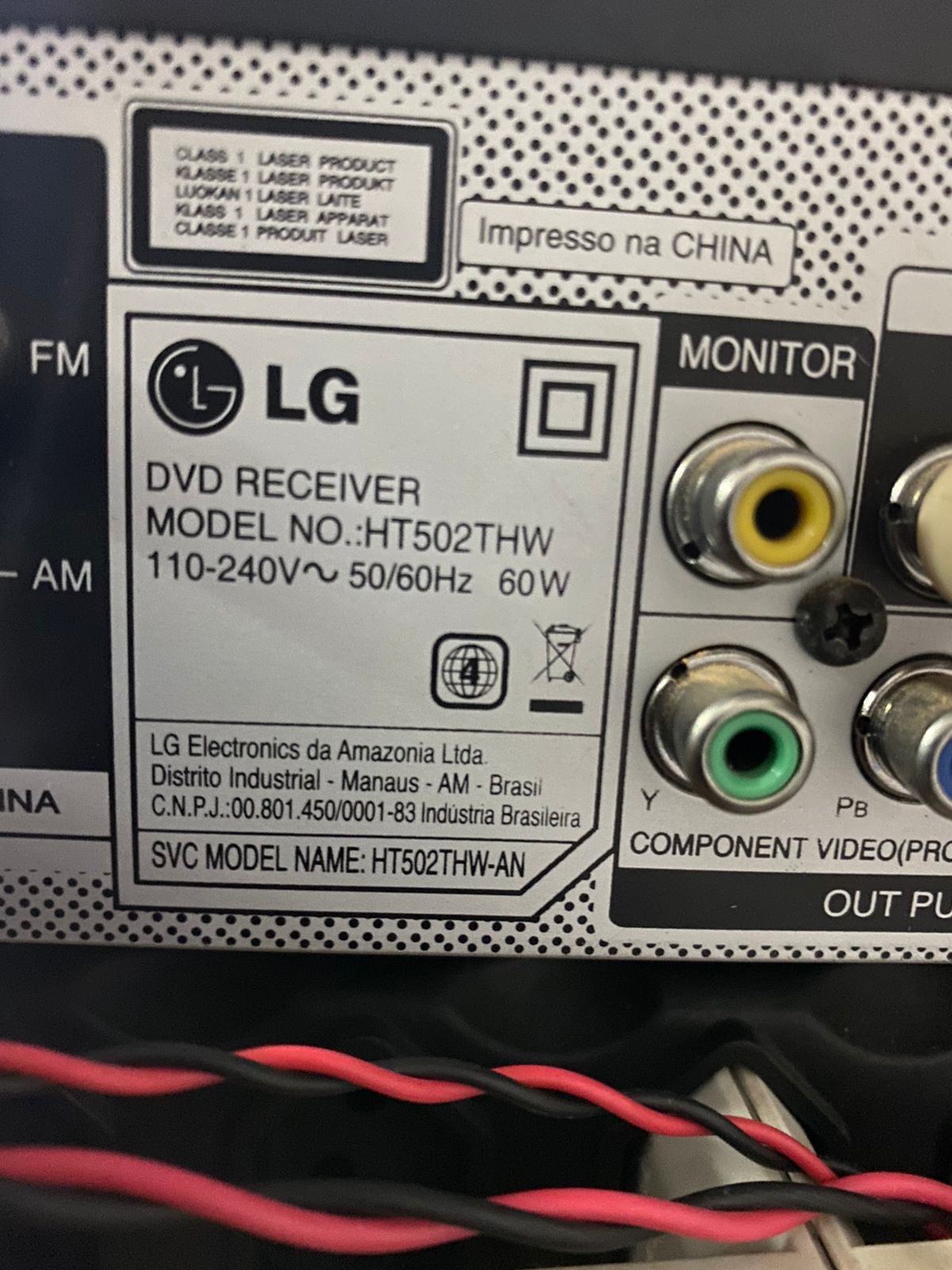

Hi Scott o/
These were the info I could see on the DVD Player:
[Attachment 65783 - Click to enlarge]
[Attachment 65784 - Click to enlarge]
[Attachment 65785 - Click to enlarge]
[Attachment 65786 - Click to enlarge]
Do they help in anything?
Thank you all so much for the effort. What is really bugging me at this point is the fact that the file I first uploaded here works perfectly with 5.1 surround audio in this DVD Player via USB, but none of the dozens files I tried to convert using Avidemux seems to work for me. I didn't give up though lol. If I keep getting help from you guys, I will continue to try and make this work.
Thank you again! -

Ok, so the manual on pg 21 says the resolution cannot be larger than 800x600 (suggest you keep it at std SD), nor higher framerate than 30FPS, and must be properly interleaved in the mux (probably something like 1sec V, 1sec A, 1sec V, 1sec A...). Only a few 4CCs are allowed - DIVX3, DIVX4, DIVX5 and a few others allowed but not XVID.
