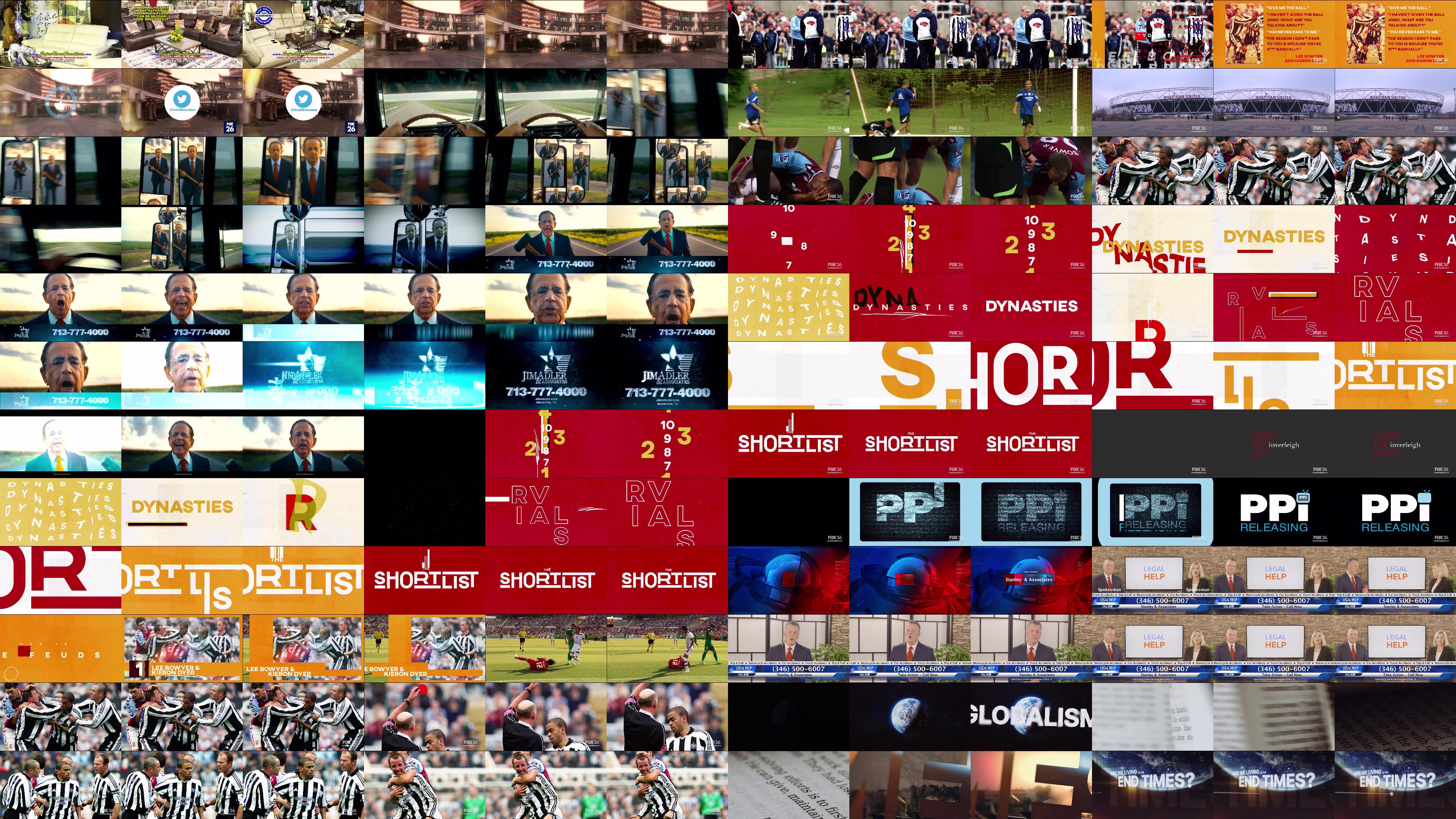

    Hi johns0, jagabo
    There were 9000 images embedded in this image. This file was for yesterday.
    Today I have 12000 keyframes.

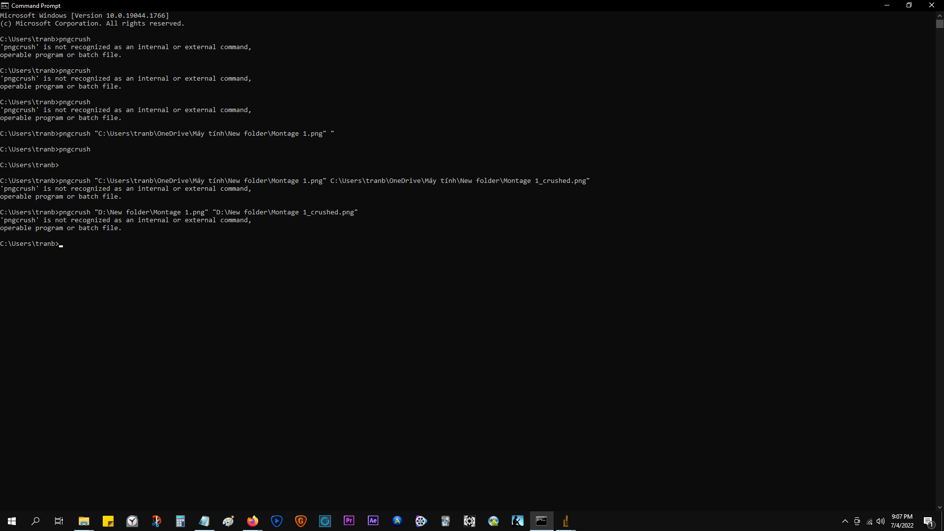

    I used you guys' advices. I divided it into 3 parts. But the file is more than 400MB and is bigger than my expectation.
    Do you think I can use pngcrush to compress it more? I tried based on instructions from youtube. https://www.youtube.com/watch?v=ORSwlbce5rw&t=82s and https://www.youtube.com/watch?v=V0UCNuENdi8
    But it does not work. Image is attached below.
    Psp 2018 opened the file but kept getting erors trying to save as jpp,saved as bmp and the file went to 1.58 gb in size,so i don't think it will reduce in size,just too many pictures embedded.
  10. pngcrush or optipng might reduce typical png filesize in the order of 0-3% on average

  14. I ran the 973 MiB1920x29700 png file through pngcrush and got a 672 MiB PNG file, a 30 percent reduction. That's better than I expected. It took something like 30 minutes though.
    But you should probably stick to more common image sizes like 3840x2160 or 7680x4320. And why do you need lossless encoding for thumbnails? JPEG at 75 percent quality isn't bad and each 3840x2160 image would turn out around maybe 1.3 MB.
