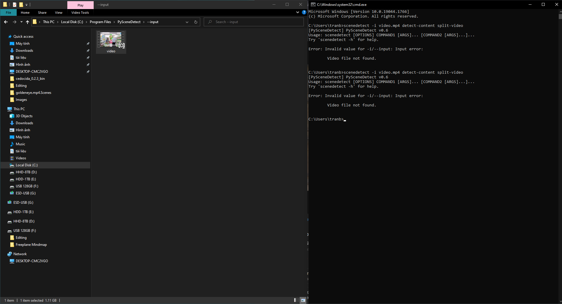

  1. Hi guys,
    I am a newbie for using Python. Pyscenedetect shows an error "Video file not found". Images are attached bellow. I do not know how to fix it. Please help.
    I installed their installer having scenedetect and ffmpeg and/or mkvmerge.
    I also tried to find the folder -i or --input. Even making one. But it does not work.
    [Attachment 65693 - Click to enlarge]

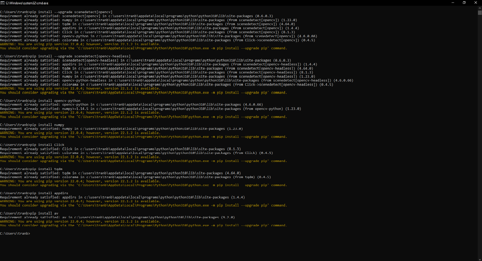

    I also installed
    pip install --upgrade scenedetect[opencv]
    pip install --upgrade scenedetect[opencv-headless]
    pip install opencv-python
    pip install numpy
    pip install Click
    pip install tqdm
    pip install appdirs
    pip install av
    [Attachment 65694 - Click to enlarge]
    Please helping me. Thank you in advance.

    It looks like the command is trying to access the video file from the folder that the command is being run from.
    If the video is not there, you'll probably need a fully qualified path/name in quotes
  4. Hi davexnet,
    Thankl you so much for answering my question. I found the solution. I need to fix their code a little bit for it to run.
    The code on their website (https://pyscenedetect.readthedocs.io/en/latest/examples/usage/).
    scenedetect -i video.mp4 detect-content split-video
    My fixed code.
    scenedetect.exe --input "C:\Users\tranb\OneDrive\Máy tính\New folder (2)\20220629.mp4" --output "C:\Users\tranb\OneDrive\Máy tính\New folder (3)" detect-content split-video
