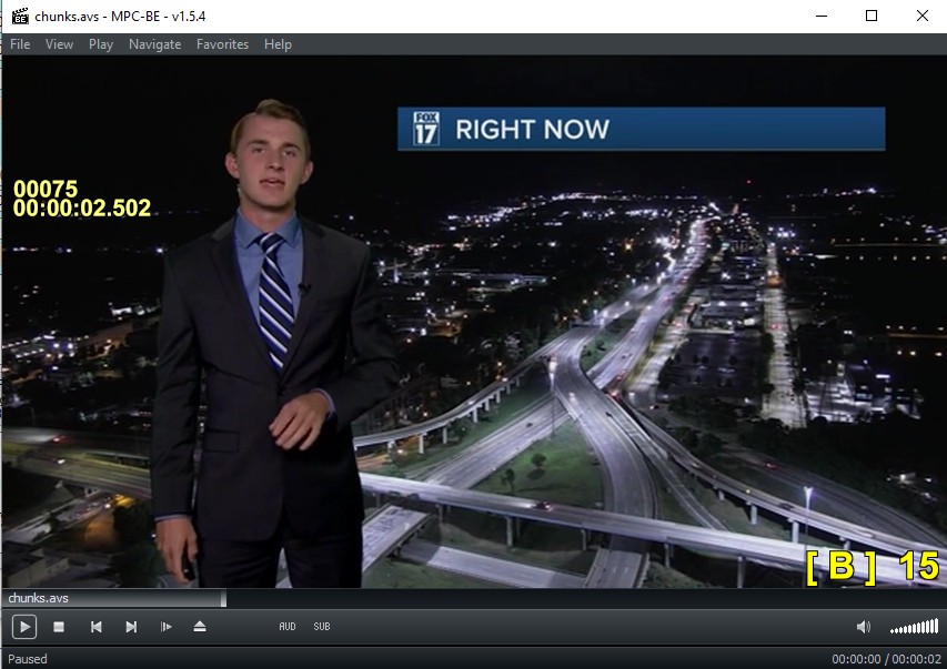

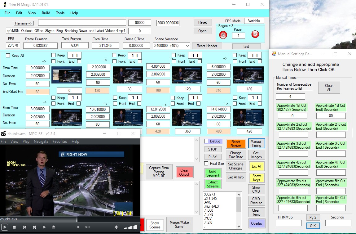

    Just my 2 cents worth... It is possible to cut at any "P" frame, usually every 4 frames, so the end would be approximately where you want it. You still need to start at a Key frame "I" but the locations of each can be decoded using ffmpeg and ffprobe. FFprobe is no speed demon so it takes a bit for a large file. I script(Automated program) i use provides this:
    ALL FRAMES (FFmpeg script altered to only obtain certain sequences.
    1, 15090, 0.167667, Iside_data
    0, 18090, 0.201000, B
    0, 21090, 0.234333, B
    0, 24090, 0.267667, B
    0, 27090, 0.301000, P
    0, 30090, 0.334333, B
    0, 33090, 0.367667, B
    0, 36090, 0.401000, B
    0, 39090, 0.434333, P
    KEY FRAMES
    1, 285090, 3.167667, I
    1, 7305090, 81.167667, I
    1, 7575090, 84.167667, I
    1, 7845090, 87.167667, I
    1, 8115090, 90.167667, I
    Adding FFMS@ (ffmpegsource2) to Avisynth allows viewing all pertinent info Frame, frame type, frame pts time, as the video plays:
    [Attachment 65909 - Click to enlarge]
    If anyone would like more info on the scripts contained in my program, let me know.
    [Attachment 65910 - Click to enlarge]
