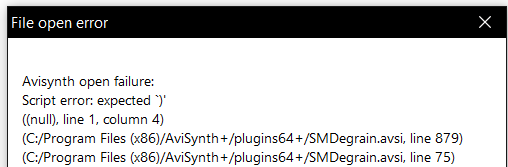

    Thanks, that is working now. But now it says there are syntax errors in the SMDegrain I got from Github
    [Attachment 65731 - Click to enlarge]
  3. The script in post #38 also uses Santiag, SMDegrain, aWarpSharp2, and ChromaShiftSP. Some of the earlier scripts used QTGMC (which requires many other third party filters).
    You may not need LSMASHSource. I don't have UT Video Codec installed so I couldn't use AviSource -- I used LWLIbavVideoSource (part of LSMASHSource) because it includes a UT decoder. You may be able to use AviSource() instead.

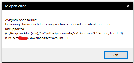

    Ok thank you. I got some of the avisynth plugins working, except SMDegrain so far. I did a test and there are no artifacts unlike Handbrake lol. It's great. I'm currently using AviSource, and have UT Codec installed.

  5. I've never seen that error before. As a quick test, in the call to smdegrain try changing plane to 0 instead of 4, and prefilter to 3 instead of 4.
    And make sure you have the dependencies for smdegrain:
    http://avisynth.nl/index.php/SMDegrain#Dependencies

    Seems like a good compromise, but my system is too slow (old AMD fx 4300 CPU) to experiment for too long.
    Had to revert to an older version of smdegrain, had the same error as reported earier with the current version
