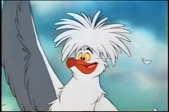

  3. New capture
  4. Originally Posted by boolian2 View Post
    New capture
    Looks good to me.
    Still, you may want to check your cables to prevent any residual Y/C crosstalk (dotcrawl, rainbows) possibly caused by the cables (like in your previous anime video)

  6. The latest cap is looking pretty good. For what it's worth here's a version with the worst of the halos reduced, edges smoothed, and a little temporal noise reduction.
    LWLibavVideoSource("amarec(20220701-0305).avi", cache=false, format="YUY2")
    AssumeTFF()
    TFM()
    TDecimate()
    ConvertToYV12()
    FineDehalo(rx=3.0, ry=1.0)
    FineDehalo(rx=6, ry=1.0, BrightStr=0.5, DarkStr=0.5)
    Santiag()
    Sharpen(0.3)
    SMDegrain(tr=1, thSAD=200, refinemotion=true, contrasharp=false, PreFilter=4, mode=0, truemotion=true, plane=4, chroma=false)
    May 2005
    Australia-PAL Land
    Wow.
  8. A little better? Sharper and better aligned chroma, slightly sharper luma:
    AssumeTFF()
    TFM()
    TDecimate()
    ConvertToYV12()
    Santiag()
    MergeChroma(aWarpSharp2(depth=5), LanczosResize(width/2, height).aWarpSharp2(depth=15).LanczosResize(width,height))
    ChromaShiftSP(x=-1)
    Sharpen(0.3)

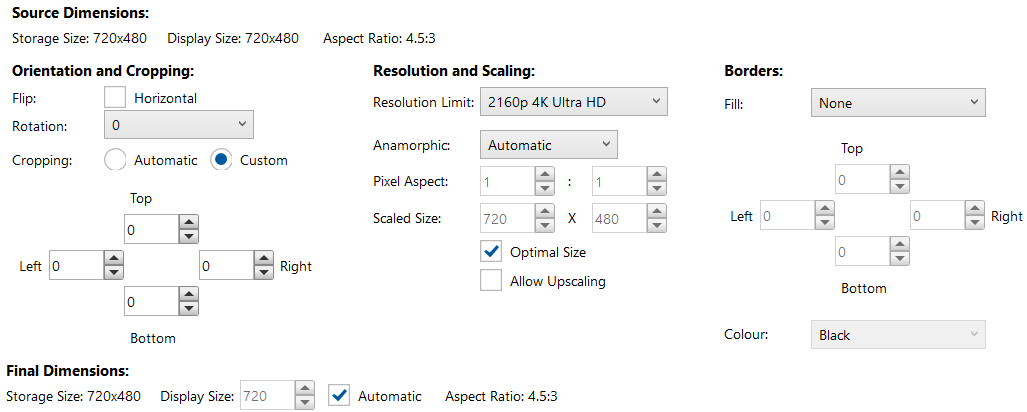

  15. Wrong Aspect Ratio and some blended frames.
    If you seek help upload a snippet of the capture and post your script.

    The filters are
    Detelecine Default
    Interlace Detection Default
    Deinterlace Decomb EEDI2
    Denoise NLMeans Medium Animation
    Chroma Smooth Light Small
    The Dimensions are
    [Attachment 65719 - Click to enlarge]
  17. Can't help you with handbrake. I don't use it. Maybe someone else.
    It's better you learn avisynth basics than wildly clicking options in GUI's
    And upload a few seconds of the capture so someone may take a look.

    So I just tried Handbrake again, and this is how it turned out, does this look ok
    Your ITU cap has a pixel aspect ratio of 10:11. You encoded it as 1:1 so it displays incorrectly. Handbrake doesn't handle AVI with interlaced lossless YUV 4:2:2 chroma correctly. That has resulted in chroma blending artifacts. I don't think you can "fix" that about Handbrake.

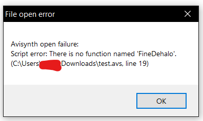

    I downloaded the avisynth plugins you're using, what is _xp? I installed the plugins and got this error message when trying one of the avisynth scripts you posted earlier
    [Attachment 65729 - Click to enlarge]
  29. http://avisynth.nl/index.php/FineDehalo
    But it won't solve the basic problem with your source or script. Means you can leave it away for the time being.
  30. Originally Posted by Sharc View Post
    So that's not included in the plugin? Do I just copy and paste it at the top of the file?
