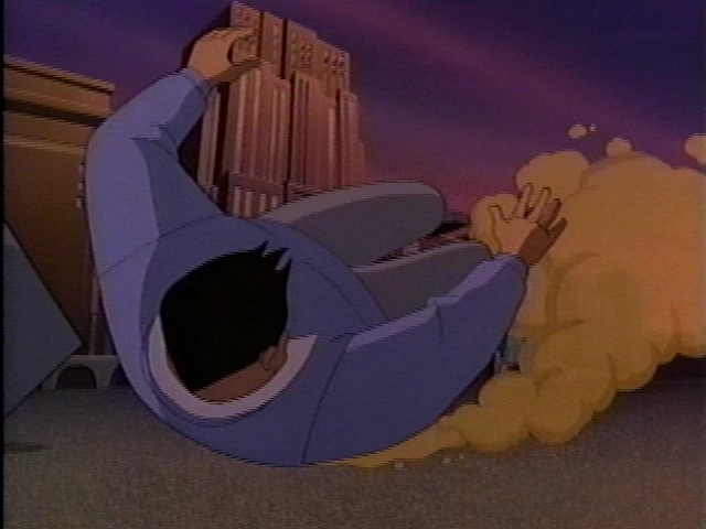

    Ok thanks I just wanted to post another sample capture. The ES15 really cleans up the signal. Still learning about how to process the capture and what software/filters to use. Big learning curve. Also I thought IVTC didn't need to be used on animation
    Is this ghosting when paused normal?

  5. Originally Posted by boolian2 View Post
    Which is why you need to start at the beginning -- getting good captures. Posting highly processed clips makes it impossible to tell what problems are in the source, what problems are due to a bad cap, and what problems are due to your processing of the video. Upload samples compressed with a lossless codec like Lagarith or UT Video Codec. Include medium speed panning shots and a variety of dark and bright frames with good color saturation.
    Like movies, almost all animation starts out as 24p. To be broadcast as interlaced video it has to be telecined to 59.94 fields per second (usually captured as 29.97 interlaced frames per second). In the optimal case you can restore the 24p frames from the telecined video.
    Paused by what? The VCR? The capture program? In a mediaplayer or editor before processing? After your processing? I suspect you have a PAL to NTSC conversion with blended fields. Blending is "normal" with those but can often be eliminated with the proper processing. The ES15's noise reduction feature can cause that type of blending too (turn it off). But your sample is too far divorced from the NTSC tape to say for sure where the problem lies.

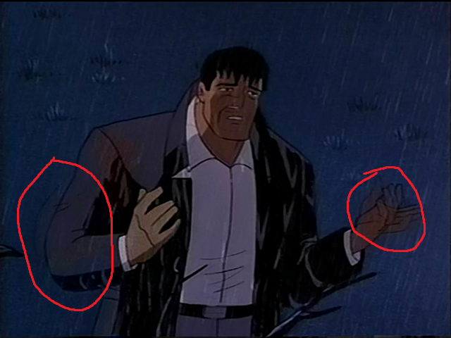

    Just noticed something weird, it looks like it's still interlaced in one spot on the IVTC'd version
    [Attachment 65650 - Click to enlarge]
  10. The regular 2-3 telecine pattern is partially broken in your .avi capture. I don't know at which stage this happened (source editing or capture process ....)
    It may be better (?) to just deinterlace this source

  11. The amarec cap in post #9 is getting better. Chroma blending in the earlier posts was caused by the ES15's NR filter. The luma blending was caused by bad post processing. Levels are still bad. The picture is stuck on one frame for the first ~4 seconds (was the VCR paused?).
    The problem Sharc saw is that the video swaps field positions every now and then. The top drops below the bottom field. I believe this is an issue with the capture device, not the tape or ES15. I've seen other caps with that device with the same problem. It's only in the first 8 seconds or so -- so maybe it just takes that long for the capture device to lock onto the signal.
    I've only addressed the IVTC here...

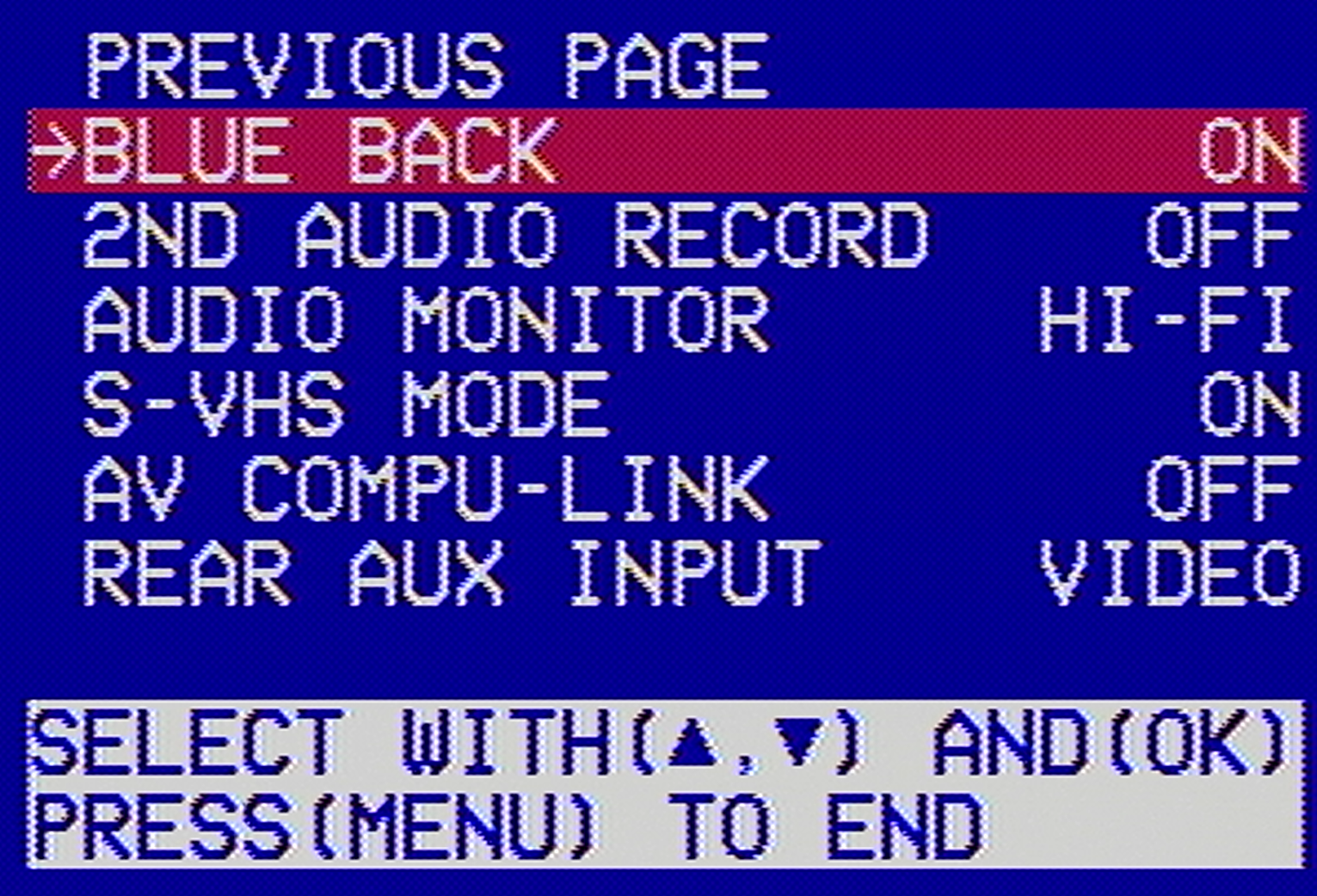

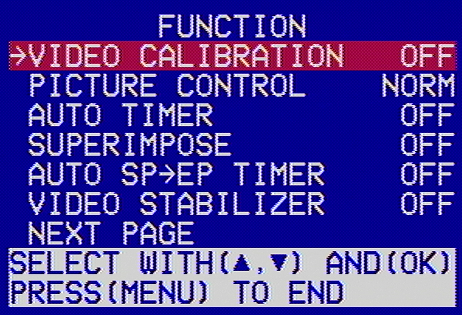

    Without intending to go off-topic, in your experience Jagabo, is it better to leave this off for all captures (I have a PAL version)?
  13. Originally Posted by Alwyn View Post
    Yes, leave it off. You can get much better noise reduction in software, especially with AviSynth or VapourSynth (though I can't help you with the latter).
